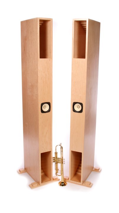

I'm almost ready to cut wood
I think the Harvey is the way to go for my onsey FE127e build. Then I can compare it with the BIB.
Any last words on measures or anything?
My last print out of the measurements is from Jan 3 2007.
One thing that pushed me toward this one is the small baffle area for the driver. If I screw up with the hole saw, not much damage done because I can precut a few extra blanks. Also it is a good visual match for the BIB I have.
The one measure that I don't see given is driver CL (centerline) to base. I'm interpretting this as 30 inches (half of 60) so maybe a 9" false bottom. I'm thinking that I may put a false base on it to get the driver to ear height.
Also wondering about a few of the measurements and angles for the compression chamber (CC).

Just posting a note here that I'm going to start a new thread on a Harvey 1.1 build that I expect to start this weekend. I have a few preliminary questions to ask, but I'll do that in the new thread.

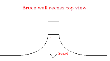

Not sure if this is the right place to post, if so let me know...
Love the idea of no crossovers in the midrange, so I'm looking at building 5 Bruces for music and home theater.
The plan is also to add an infinite baffle sub to take the LF load of the fostex drivers. My theory is that the the smooth LF response of the the Bruce should integrate nicely with the sub and that using 5 identical speakers should make surround well integrated also.
Additionally, there is some unused space behind the walls so I am looking at mounting the front 3 at least as indicated in the attachment.
Initially at least, I would be using a relatively cheap Onkyo HT amp...
Does anyone have any thoughts on this arrangement?
