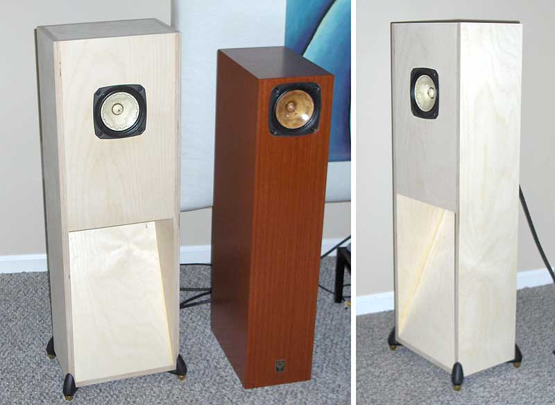

Brynns with FE126eN up and running; quite a cute little enclosure, easy to build, sounding very nice indeed - photos to follow
kind gets one thinking about bamboo...?

Note: The other speaker (for reference) in the photo is a modified Buschhorn Mk 1. It is exactly the same size as a Hornshoppe Horn (but prettier & better built)
dave
dave
Also of note is that Brynn is currently sporting FE126eN with no series R. Chris says he thinks that in his room with the high output impedance tube amps it works fine (quite fine). We will have to do a series of tests.
He also says the RatShack meter is telling him 94 dB which i find surprisingly high (the drivers measure just over 92 dB)
dave

planet10 said:Note: The other speaker (for reference) in the photo is a modified Buschhorn Mk 1. It is exactly the same size as a Hornshoppe Horn (but prettier & better built)
Ed'll love you for that Dave. 😀 I belive it though. They look great. 🙂
Strange about the sensitivity. Nice when you have apparant gains though. Was that an average from a sweep or just across a fairly tight zone?
Well, as a huge supporter of the right of free speech (as long as it's not on his own website), I'm sure he would echo his earlier sentiment that "there's room enough for all of us"
As for the SPL figure, the procedure was pretty raw, and could be subject to correction. I'll double check that.
The initial listening impression is not in doubt however - not quite as efficient as the B-Horns, but lacking in the midrange colorations of the latter. There is still the issue of series R loading for the 126 to determine. As of current listening session, there isn't a spare set of FE127 to try out. Hopefully that'll be remedied during the next few days, when the bamboo plywood Fonkens are back from the finishing shop.
