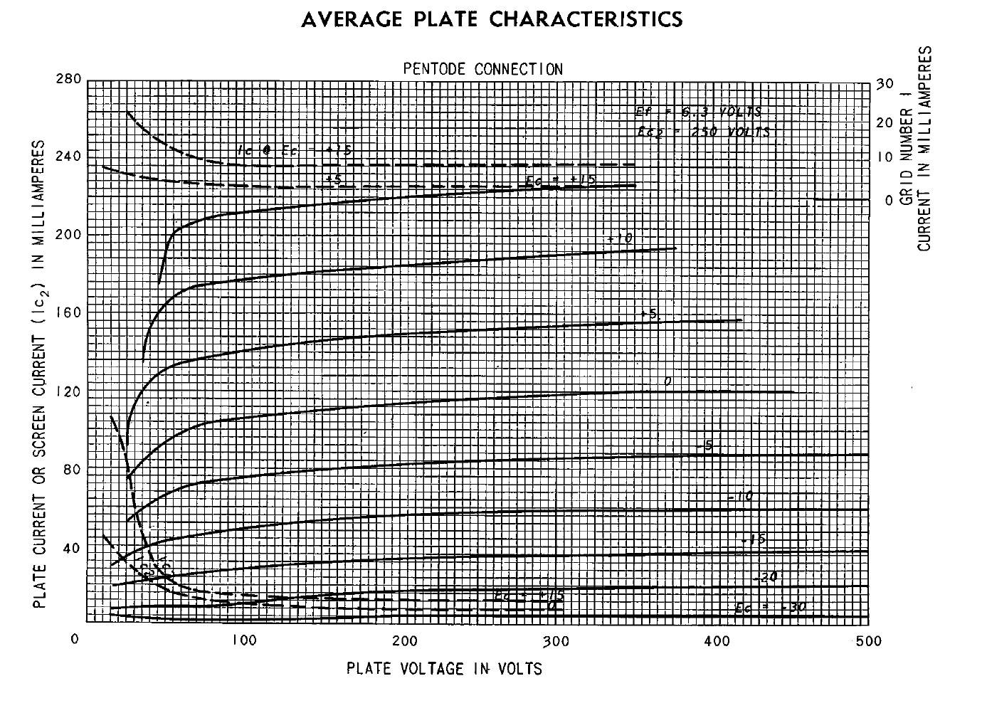

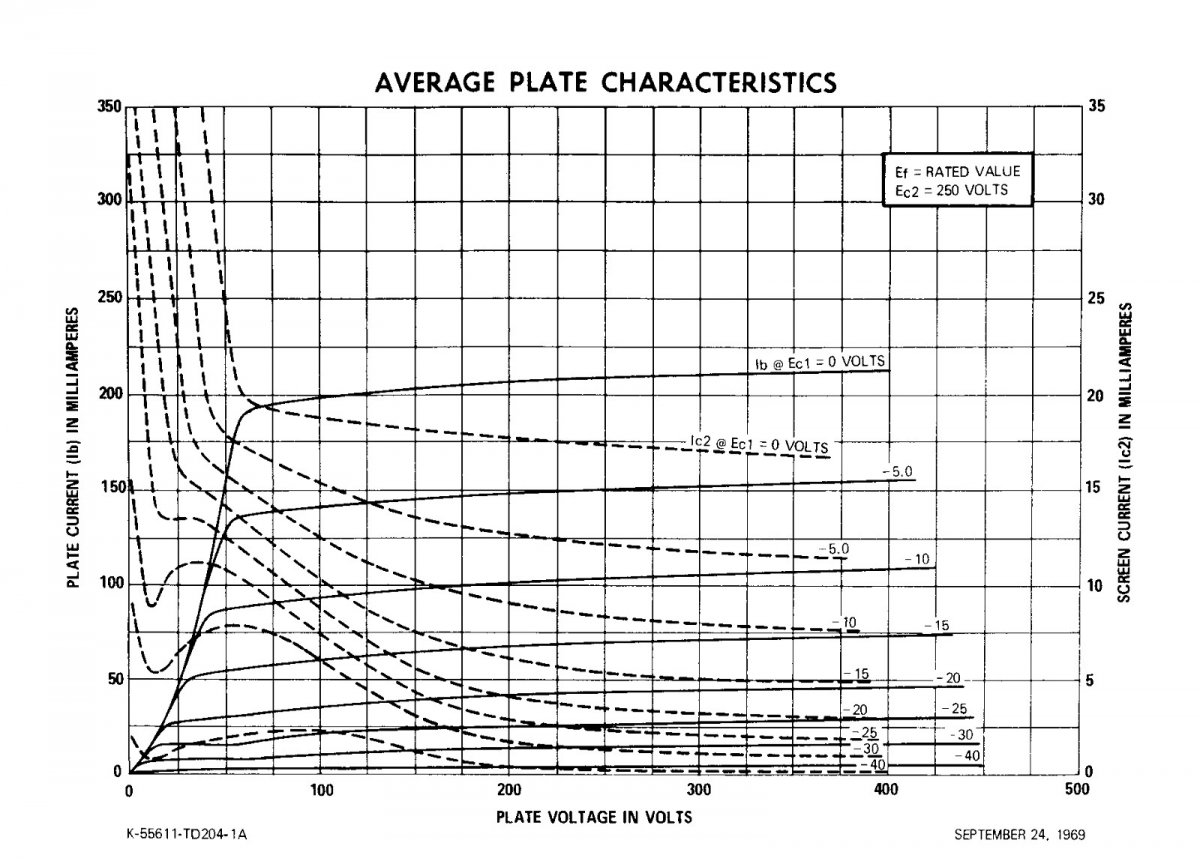

I take that back, and sorry PFL200, I compared plate current for +5V grid on one graph, and -5V grid on the other.

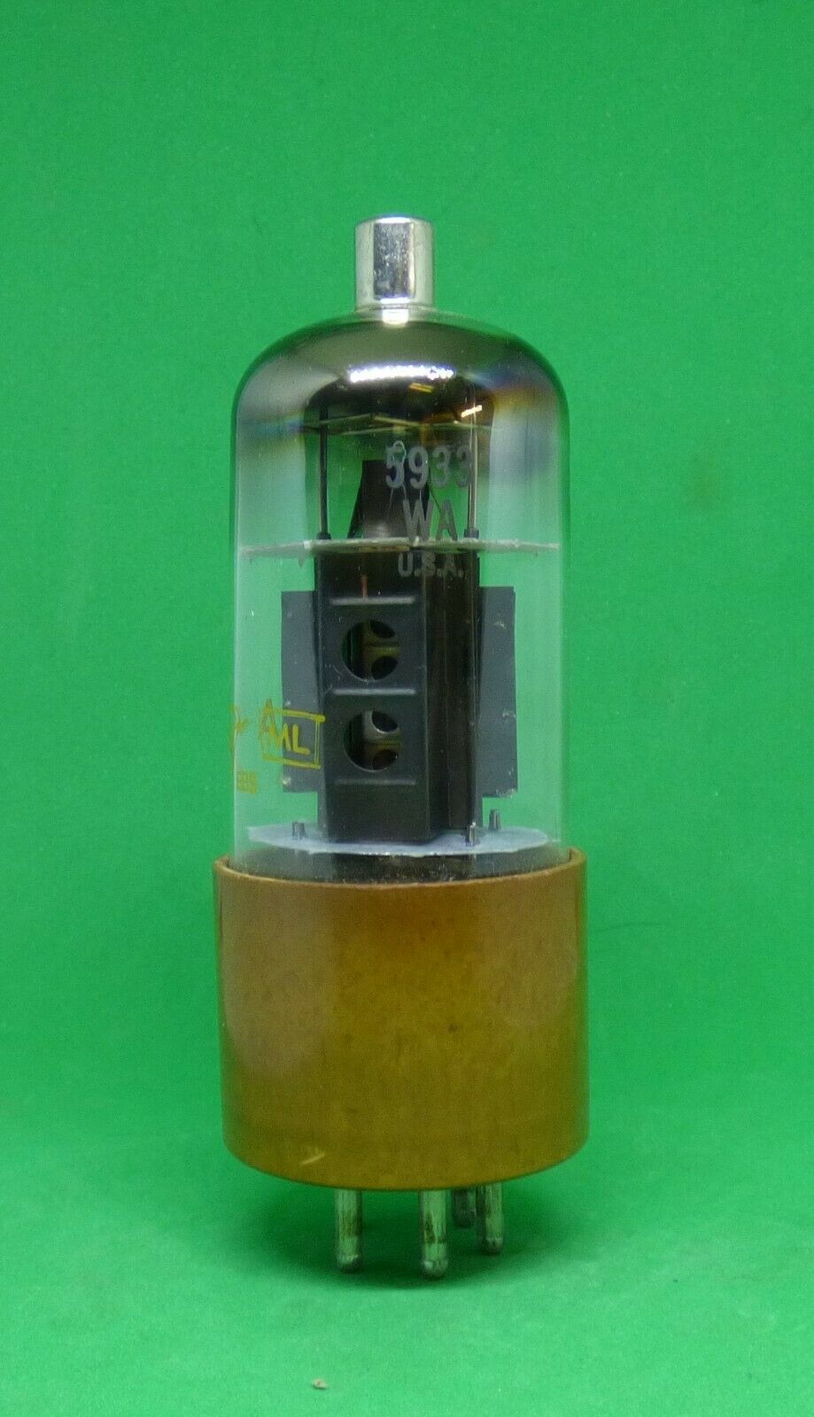

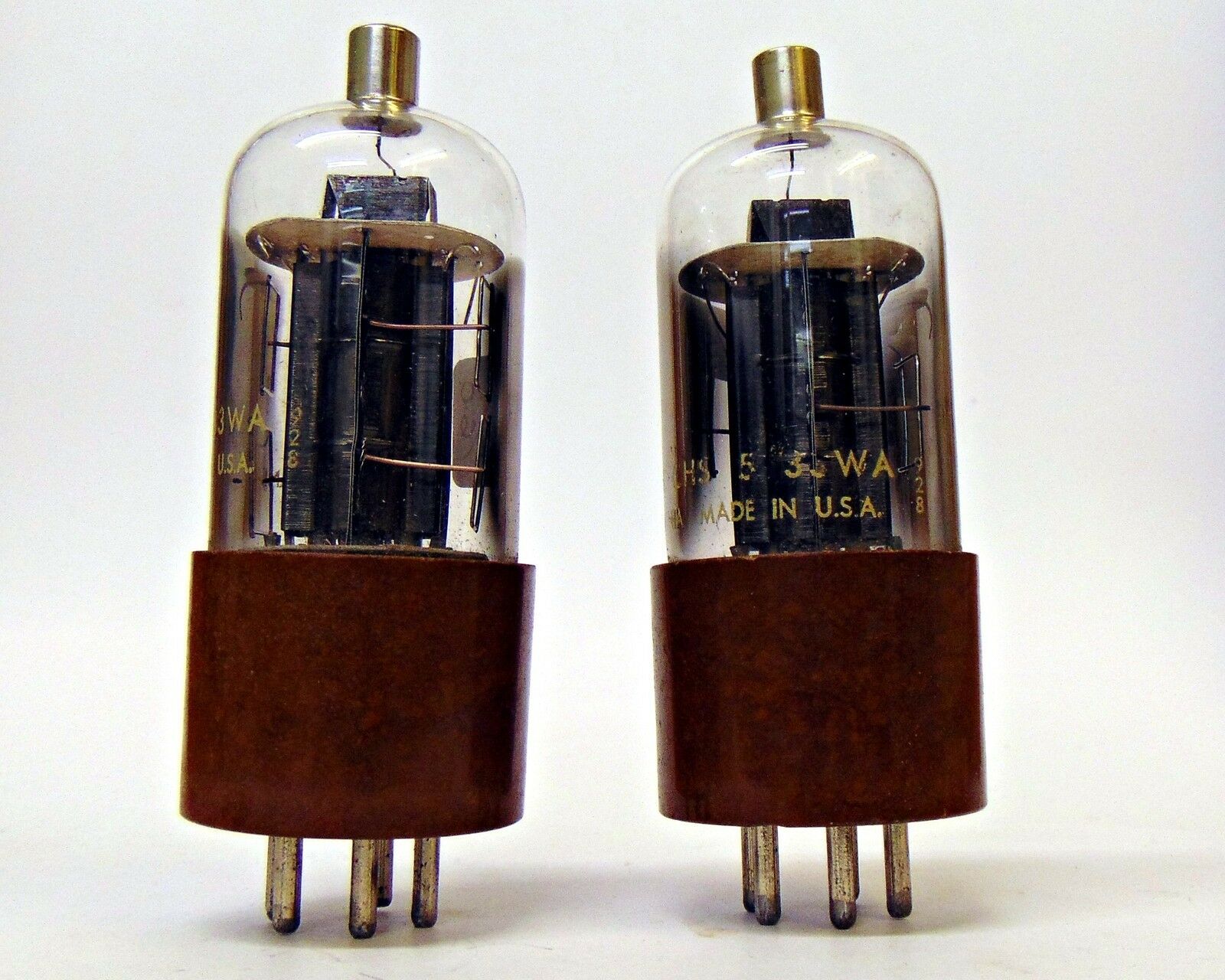

eh???5933 is kind of expensive here in the USA, if you can find them
you can find any number of the black plate type for as little as 10USD a shot.
The one to get of course being the big anode type that closely resembles a 6550 internally, not the one that looks like 6L6/807.
I was offered a pile of them in France, but I already had loads of the British industrial STC 5B25xM variant which take up so much less space, and have the highest quality glass of any of them.
(You can put a pair of 5B25xM in the same space the original 807 takes up).

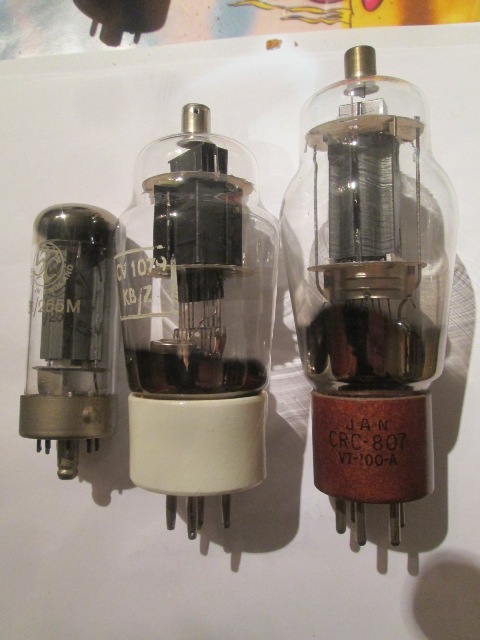

An old thread on here?
The 257m version has a 12V heater and nobody wants them.
The 256m version has a 19V heater, so the pair in series can be used to derive the bias supply of -38V.
In fact, again, coming back to the USSR made 6V6, the STC 255M variant (no top cap) is so cheap right now, you might as well forget the russian 6V6 altogether and upgrade to this miniaturised 6L6 which takes up the same amount of space.....
(hey it's just given me a nice idea to upgrade my nice old identical pair of DB110s 😀 I hadn't thought of that until now).
An absolutely remarkable feat of miniaturisation and quality control on the part of the British kent based factory. 😱
