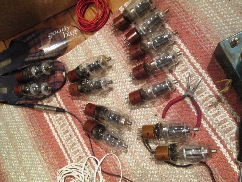

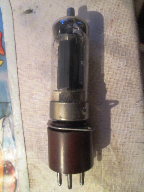

Thanks Bigun and TG!
They are old Reflektor made in the 60's.
Same as the quad I bought!
Mine are 60/70s, good quality.
I run one in Triode SE, HT of about 340V, and it has several hours of full power testing, and 10s of hours listening. No issues at all.
I would dare to run them with higher HT, say 380V for long periods, but I am limited by the power supply I used at the time.
In testing I briefly ran them close to 400V with no issues, dissipation roughly 100% Pd. I'd also dare to intimate that they could work well like this, but I dare say caveats apply, such as keeping Pd down, staying away from UL, etc etc.
But triode wired, no issue at all.

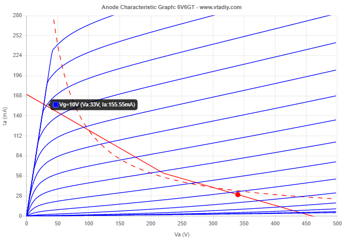

You can't do AB2 in UL.I was planning around 330-340V, going into AB2 to squeeze some more Watts from it. Is it a safe working point?
Bearing in mind the 6V6 is actually a HF transmitting valve, it works great like the 807 when pushed anything up to +20V on G1.
In this case you drop the A-A load also to say 5-6k, and drive it with cathode followers. You will get anything up to 30W out.
Drop in an extra pair (ie PPP) and you'll get an easy 45-55W.

why do you say that I can't do AB2 in UL? What is the physical limit you see?

Your question was why can't I do AB2 class in UL mode, then you show me an old design which is clearly cathode biased (not even fixed bias) and scarcely exceeds 10-11W output.
I never said you can't use UL with 6V6, just the tapping ratio is different for that valve compared with say EL84, which typically uses the same A-A loads.
You just can't drive the g1 positive using cathode bias, all you get is a moving bias point and saturation.

Fact is, if you want to drive the amp into AB2, or A2, you have to halve the A-A load get a much better power supply (5Y3 with capacitor input filter, on the Hafler scheme simply don't cut it for high loads), and use fixed bias.

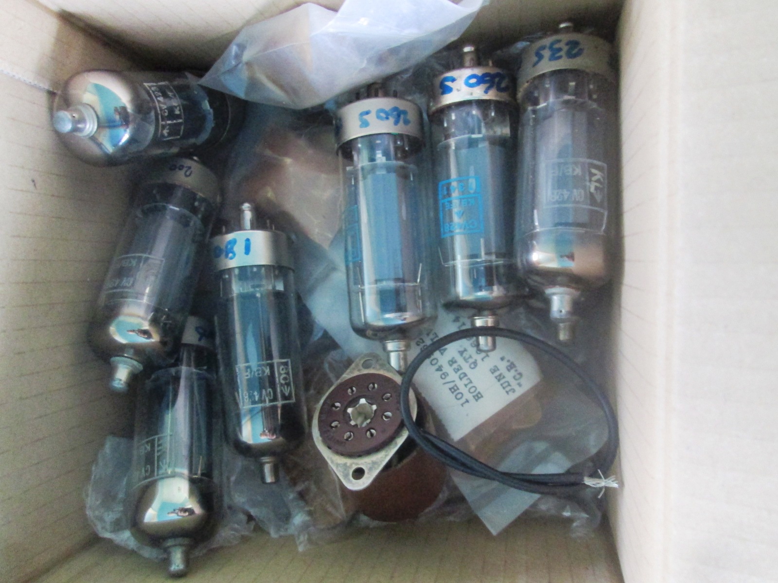

I will report some data on those 6P6S in AB2 when I'll have it: I have a limited setup to perform tests and by now I'm still enjoying the amp and comparing its sound to the same amp with 6P14S (and a bit less a-g1 feedback).

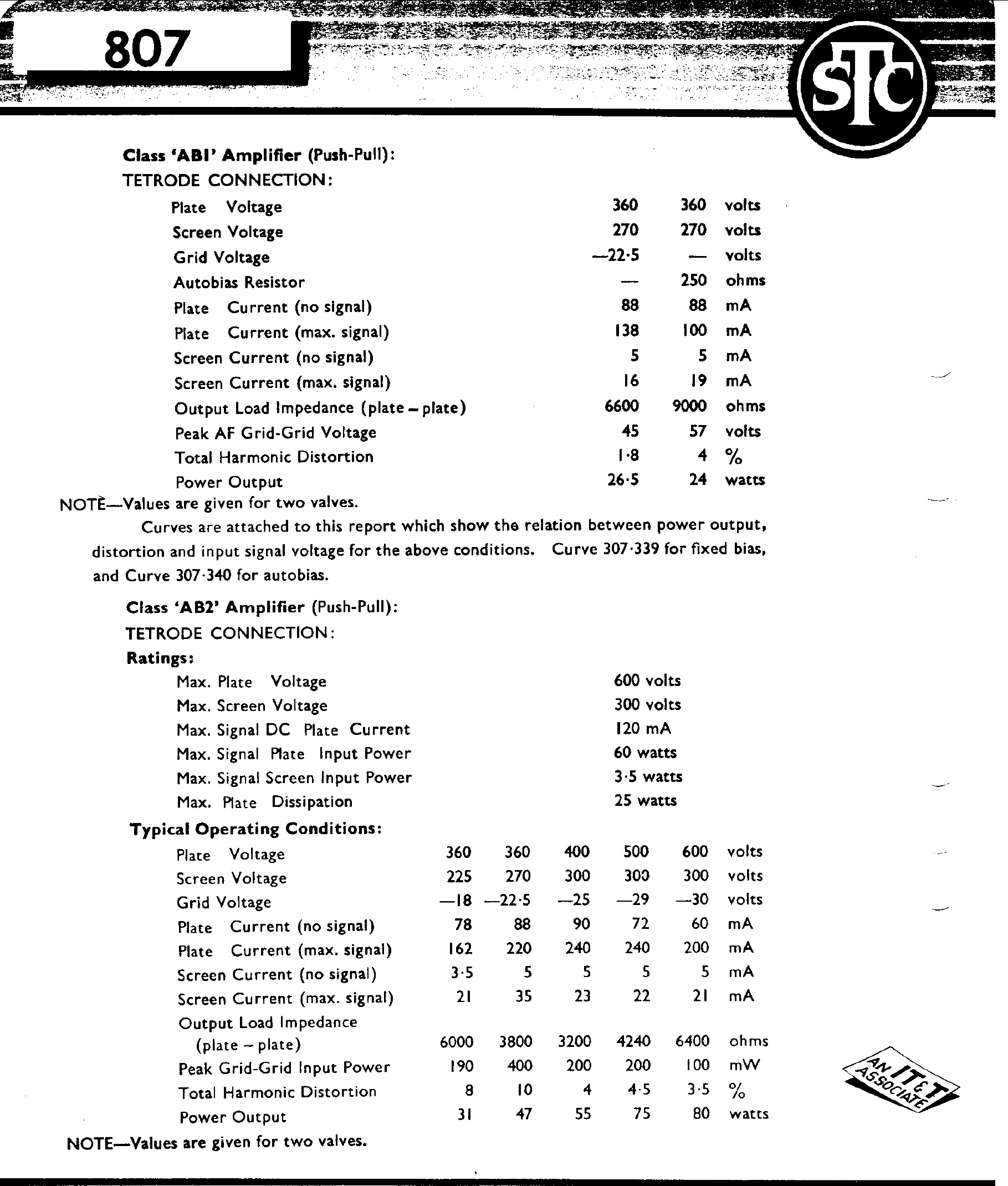

The attached page from the STC Apllication Report for the 807 from 1954 shows that you can get 80 Watts at Va = 600 V and Raa = 6400 Ohm from a pair of 807's in class AB2. So I don't understand why you seem to write that an Raa of 3445 Ohm is essential.
I am perfectly aware of what STC claims, but unlike you I have about 20 of them.
(5B254M) all brand new and tested+selected into matched pairs and even quads.
Here is one under test, using my special little adaptor.

However when you test and run things in real world conditions, the STC docs are only a guide.
In reality in the original configuration of that amp, it was dirty at under 15-20W, and was really horrible at the rated 50W output.

I tested a whole pile of brand new 807 (STC 5B25xx).
2 of them produced arcs on turn on, so were immediately rejected.
You can see the production spread, as the current is marked on the loctal collars in felt tip...on an amp with fixed bias.
2 marked "S" for strong (value 260) means 260mV over a 4.7Ohm cathode resistor.
(0.055A at 580V) or 32W..
..leave that on long and it will melt.
One is marked "180" = 38ma which is 22W. (within the 25W anode rating), and about right for the amp at idle.
Here are some of the original 807s about a dozen of them.
2-3 of them red plated, 4-5 of them had low emissions and if you are lucky you might get 2 pairs that actually match. Some were as low as "0.135" - 29ma 16.5W!
This is quite normal.
The production spread of NOS valves is all over the place.
I have more than 250 of one particular type, which go from anything between 7ma (3.25W) to 18ma at idle at 460V (8,25W), and these are GEC NOS original mil spec types.
