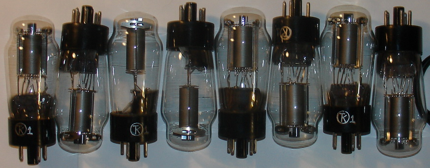

and6JB5 (Pa=15W) and stronger 6JC5 (Pa=19W) are the end of evolution of tubes based on 6V6 construction
These are easy to spot, as are the ones with the smaller anodes....then they moved to the massive anode version...Some of the early tubes did indeed have 6V6 guts in a compactron bottle.

happy now?The newer tubes that carry all 3 type numbers have a bigger plate structure so they can be squeezed a little harder...

Why anyone would bother with reflektor Saratov made 6П6С beats me, - even more so, argue about a useful upgrade, unless of course they are buying one of those nasty cheap chinese amps.

I often read discussions about made in USSR components, like tubes, capacitors, resistors, etc. Some people believe that OTK stamp means the highest quality. No, it is not! It means, the batch of the stuff was accepted by QA. Usually that means that some percentage of devices was randomly selected, tested, and no deviation from the technology that caused unacceptable measurement, was found.
And the number means the personal number assigned to the person who tested the party, who bears responsibility. During my internship at Karl Marx plant in Omsk town, where Saturn tape recorders were manufactured, I had my own number 59 for the duration of the internship. I had a rubber stamp for the device passport, and a metal one, with the number in the diamond, to seal bolts.
Some devices were manufactured for "Requestors". Army, Navy, MVD, KGB, etc. Plants that manufactured such production had "Representatives of Requestors" who bared responsibility for the quality. They as well had own personal numbers. They did not test personally, but they could demand testing or stop production if it did not satisfy TU (Technical Conditions)
What matters more, "Acceptance Levels". I know about 3 levels. And they were strictly defined. Each and every device was selected from the batch.
Acceptance "5" means products of the "VP" quality category, for which the level of requirements for reliability and other operational properties, as well as for quality assurance and control, established in the design and technological documentation, standards and technical specifications, determines the suitability of their use in land, sea and aviation equipment, the failure of which leads to significant consequences, the repair and replacement of which is carried out at the level of cells and blocks.
Acceptance "7" means products of the quality category "OSM" - products of the quality category "OS", supplied in small batches and having the features of ensuring and controlling their quality specified in the technological documentation, standards and technical specifications for products.
Acceptance "9" means products of the "OS" quality category, for which the level of requirements for reliability and other operational properties, as well as for quality assurance and control, established in the design and technological documentation, standards and technical specifications, determines the suitability of their application in space and rocket equipment , special government communications, etc., the failure of which leads to catastrophic consequences, the repair and replacement of which are difficult to access or not possible.
