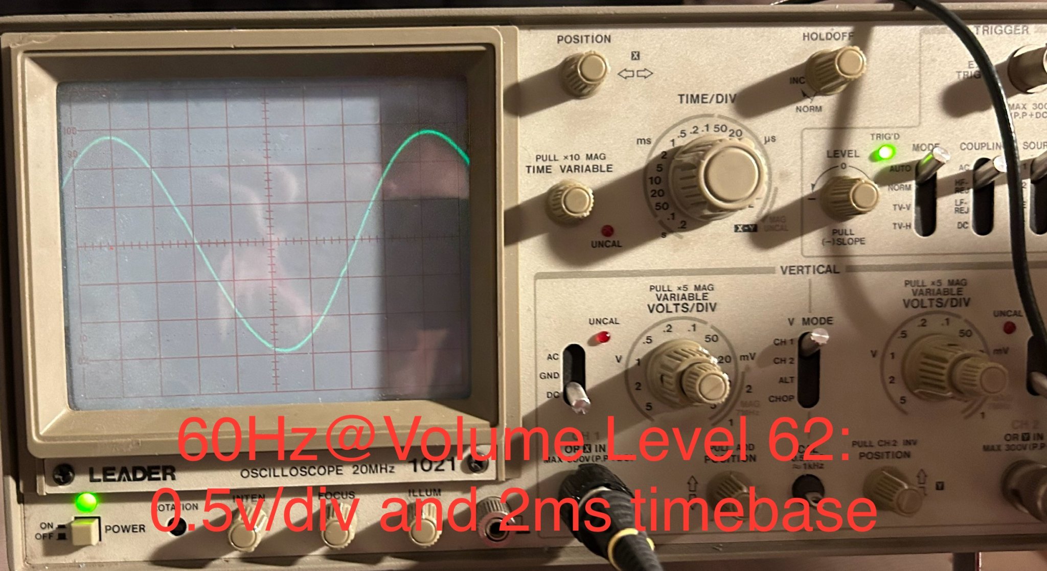

Using my function generator I fed a 60hz signal to the amp and found the exact volume point where the transmormer squeaks. It’s at 3Vpp. Also I let it run a few seconds and measured the temp on the output transistors and they were climbing. I turned it off at 100F. Wasn’t certain if I could let them go higher. Datasheet states storage temp max at 150C. Is that how high it can heat up? Also the voltage on B+ only dropped to 11.5v at this volume.

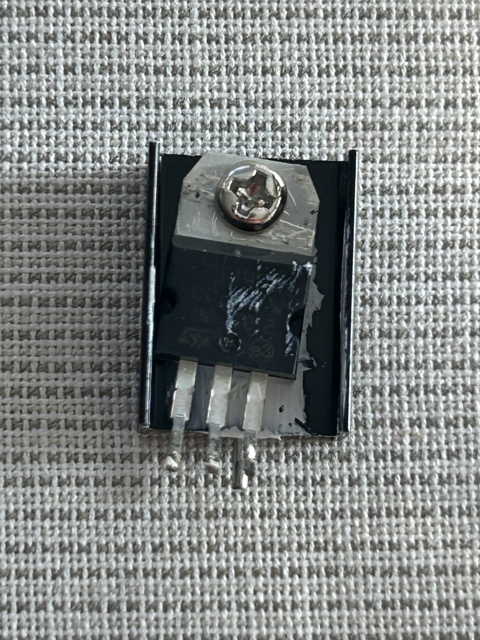

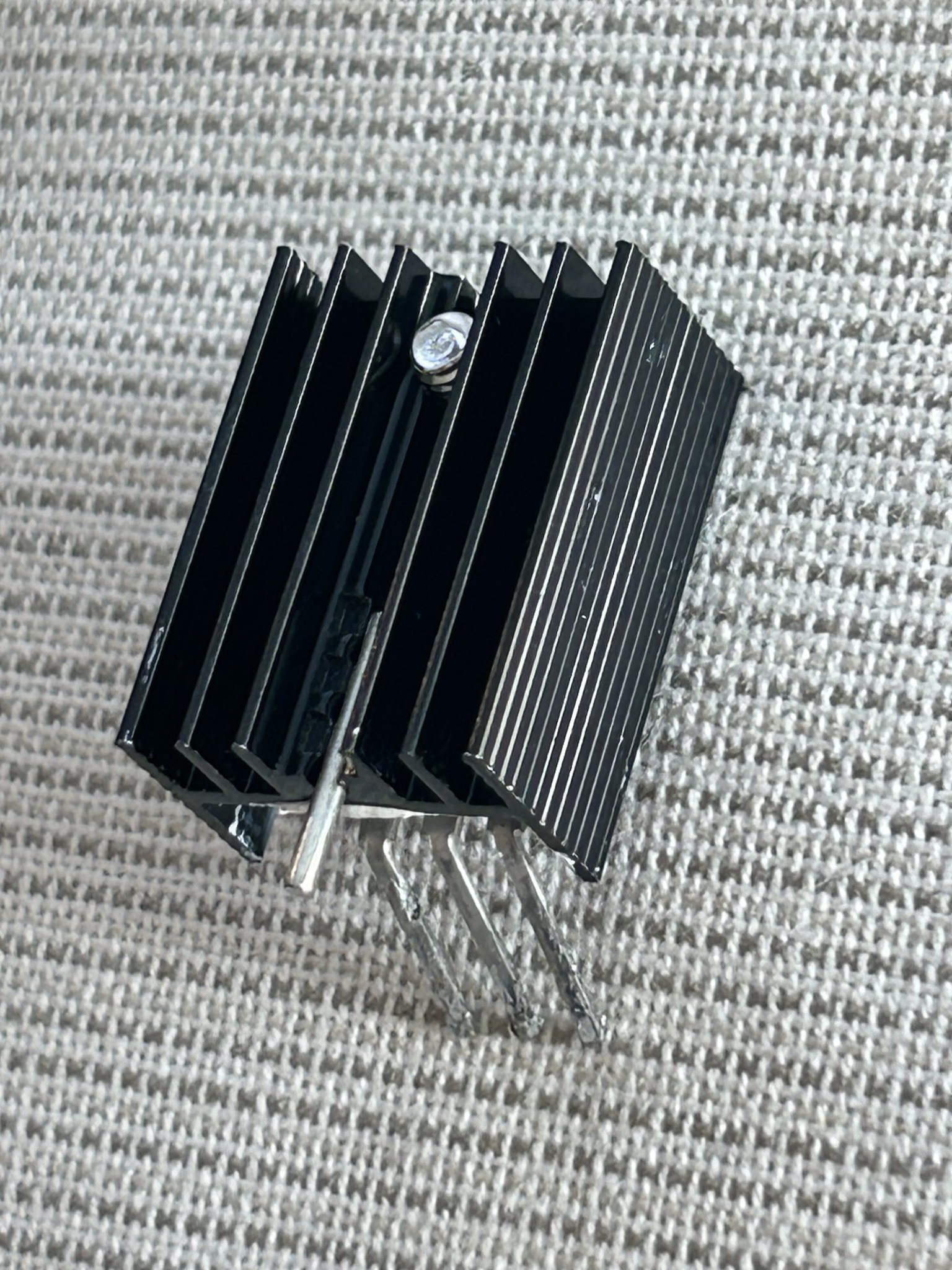

I decided to buy individual heatsinks for them. I tested it again and noticed that one transistor gets much hotter than the others. I let it run until it reached 150F. The others were all below 100F. I pushed the volume higher on this test than yesterday. Is this normal behavior? I may try the original transistors to compare.
Move the hot transistor to another location, including to a different heatsink (one that was cooler). Does the heat follow the transistor or does it remain with any transistor in the previously hot location?
It appears to be random but mostly one transistor heats up. One test two heated up. But it’s not tied to a location or transistor or even tied to original versus new. I swapped out the new for the originals and same random transistor heats up. At first I thought it could be bad soldering on the one heating up so I applied more solder to those but it would then continue to randomly pick one Q2-Q6 transistor. I can’t tell if any others are heating up since they are under the board on the heatsink. I stop the test when a transistor reaches 150F which takes about 2-3mins of playing a 50hz sinewave at 4Vpp and the load is 1.5ohms.
What sort of heatsink are you using now?
Are you sure that the thermal mating to the heatsink is consistent?
What I think is likely happening is that one starts to heat up and then, it's threshold decreases and it starts to pass more current. At that point, it starts to avalanche and overheats. When all are on the same heatsink, their temperatures are kept approximately the same so they tend to share current more evenly.
