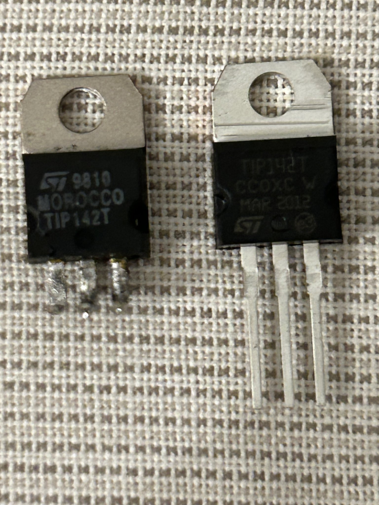

I bought some TIP142T's but due to the lack of available US inventory or slow shipping from overseas vendors I decided to give Ebay a try. I know it's not recommended because of the possibility of getting fakes. I have received them and they are dated March 2012. Markings are very different from the originals. See pics. So I'm hoping they are not fakes and just new old stock. The seller had really good reviews and communication. Any telltale signs for fakes?
I have gone ahead and hard-wired all the new TIP142T's to Q2-Q6 and the amp is working good. It plays fine at medium to medium-high volumes.

I know you don't put much stock into the TR\LCR\ESR testers for transistors, but I have an MK-328 and here are the comparable results:
Original TIP142Ts:
hFE=0.95
Ie=9uA
Vbe=125mV
Uf=563mV
New TIP142Ts:
hFE=234
Ie=5.4mA
Vbe=1.27V
Uf=677mV
hFE, Ie and Vbe are very different values.
The MAR isn't likely March. It's more likely an abbreviation for the production location.
The 20 is likely 2020. The 12 is likely the 12th week.
If anyone knows definitively, correct me.
If you have extras, crack one new and one old open. Squeezing in vice from the side (at a slight angle) will pop the plastic off easily.
The bottom of page 20 of my site shows some ways to tell fakes with links to other good pages.
You can also measure the internal resistor values between terminals. Compare new to old.

To compare against the original Q2 above here are my new transistor readings:
Resistance:
New Transistor:
B-C: open
C-E: open
B-E:7.6k
Diode check (Left letter red probe - right letter black probe):
New Transistor:
B-C: .622
C-E: open
E-C: .550
B-E: .684
C-B: open
E-B: open
For some reason the new transistor B-C has an open resistance but it does briefly show a number and then goes open. Much like a capacitor. The old transistors don’t do that.
As for breaking a transistor open I don’t have a vice. Any other ideas how to do it?
