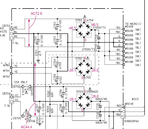

Thanks, DestroyerX, but I found that AX1 manual floating on the net.
All is in there except the transformer specs. I'm not an electronics expert but there were weird things in there, in the power supply section.
2 differently powered secondaries with bridge rectifiers, coupled together at the rails!
look: D701 and D702 are coupled?
Those separated supplies are made to avoid interactions
To reduce influence of some rigth channel to left channel, do not mind if front or hear..... better when 2 transformers are used, but this way is even better then one single output.
That lower voltage, normally is used to first stages and to drive transistors, when voltage need to be stable...and the higher voltage is used, normally, to output stages.
But there are people that make this inverted....more voltage in drivers and lower voltage in output.
And this is a very old discussion, alike who started first...the Egg or the Chicken.
regards,
Carlos

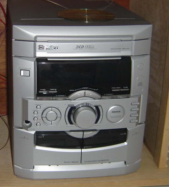

As i bougth a standard home system, for a while i am comparing with those equipments.
And the class D at least "exterminate" others system in power, quality, transparence, punch, and all the names we can find to describe sound.
But, despite having enormous advantage ahead from others.... there is something that i could not describe, and also could not realise exactly what is the "thing" i am feeling.
Something strange....when i discover exactly, i will put the meaning in words.
I am confused.....no doubts that class is wonderfull, problem is to discover what is going on that i feel something strange.
I will keep myself listening and trying to find the cause....no!...i do not feel tired...i can hear it for whole day....not distortion...do not know.
Carlos
