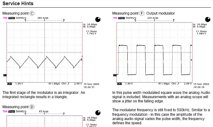

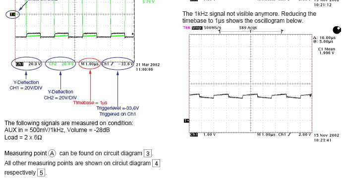

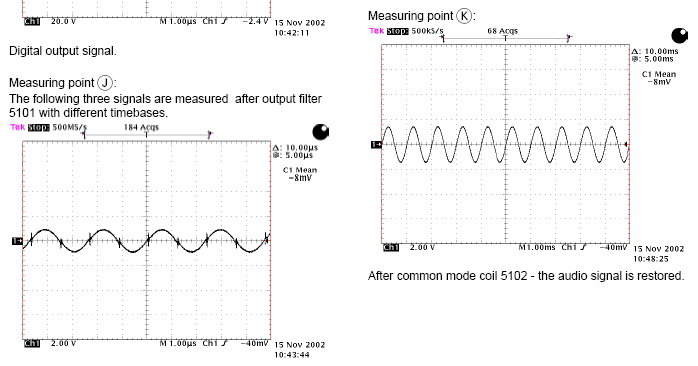

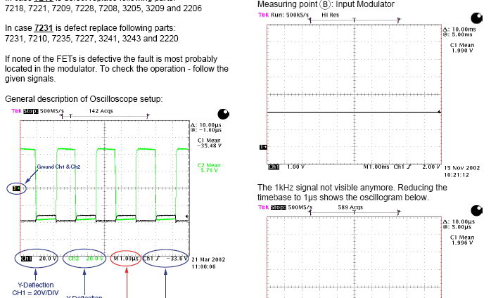

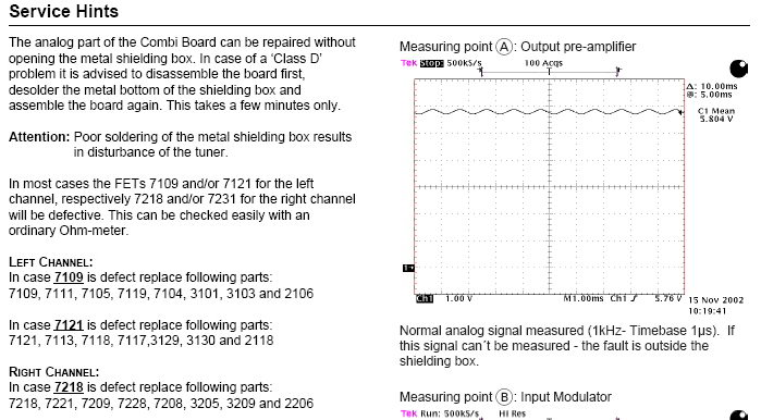

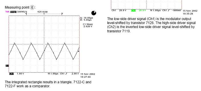

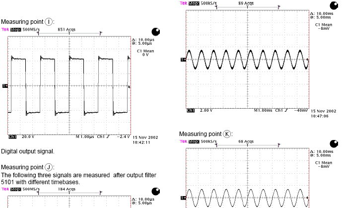

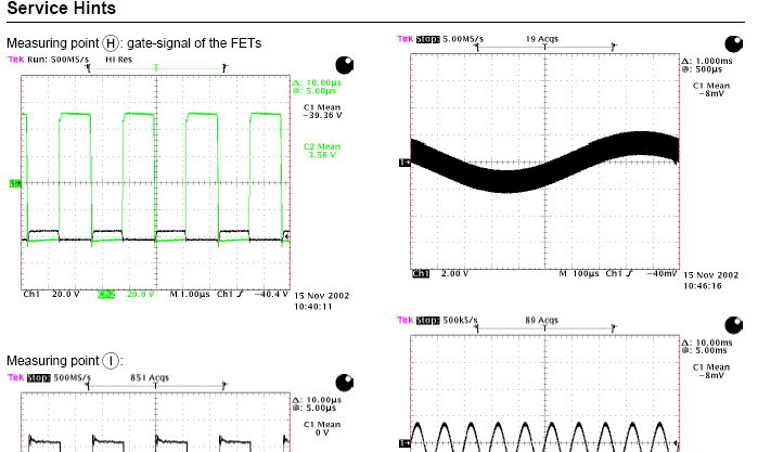

Some Wave forms (nine) to instruct and adjust
Those parts, all together, will be enought ( i imagine) to construct the amplifier, in a diy basis.
Other informs can be helpfull, but you have to register in the site i told you, and download the 10.5 Megabytes of data.

You certainly are thorough Carlos.
That's alot more than I'd expected to see 😀

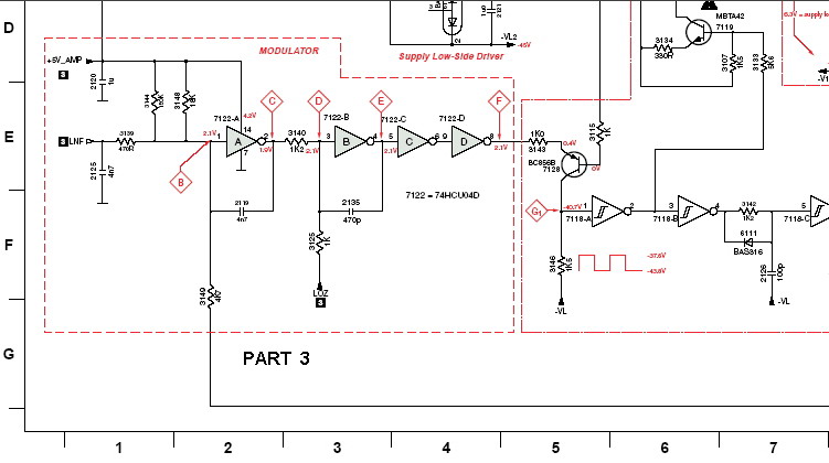

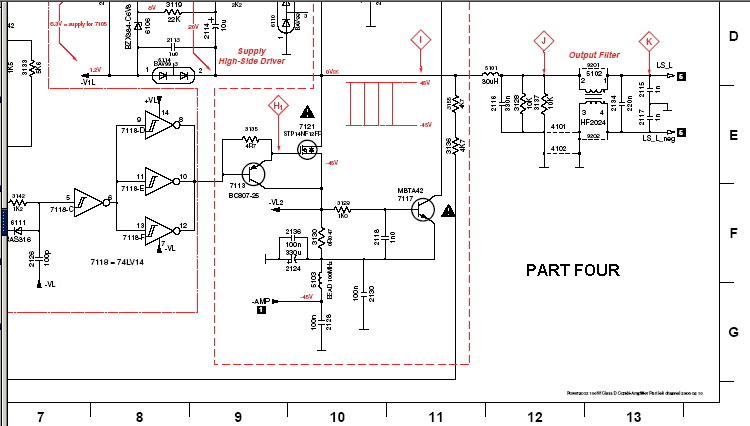

Thanks for posting it though, it's always very nice to see a schematic of a known working amplifier. I will be looking over the level shifters and low side supplies with interest for instance. I've tried the same transistor as a level shift and was not at all pleased but, simulation often differs from reality.
Now I'm using a BFV420 from philips as a level shifter. Seems to work much better.

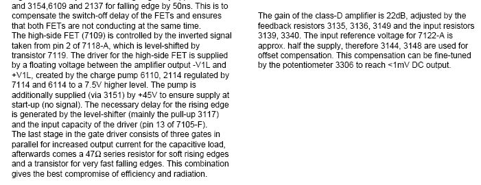

Anyway, refering back to your first few posts in this thread, I can now assure you with 100% certainty, this is _NOT_ a UCD! As MikeB stated this seems to be a very basic rendition of class D, and you seem to like it. I would think you'd appreciate a better class d amp much more.
Why not try a UCD180 module or two? All you need to do is make a power supply for it, just a basic raw DC +- good quality supply, you probably have everything you need for it already. Maybe we can get a review from you of how it sounds against your AKSA amp 🙂
A cheaper solution that might be alot of fun to toy with would be those Sonic Impact amplifiers, much less power, I personally don't think it's as good as UCD, but it is Tripath based and people seem to think they're very decent. I would think when it comes to the modulator it would be superior than this uses.
Another possibility, you can buy some powered speakers (computer speakers etc) that are SODA based, which are second to UCD but reportedly sounds very good indeed. Should be able to find some fairly cheap.

But simple means not bad !
In fact, i believe that this kind of classd is superior to these
superultrakomplex...
I already worked on a very similar design, and in sims it showed
that it has null high order harmonics, only 2nd and 3rd.
The concept of selfoscillating has a full global feedback, compensating
for most errors.
I think for ClassD is the same rule as for solidstate, the simpler the better !

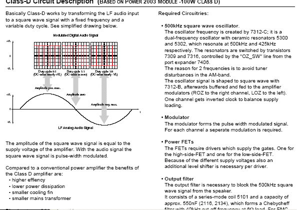

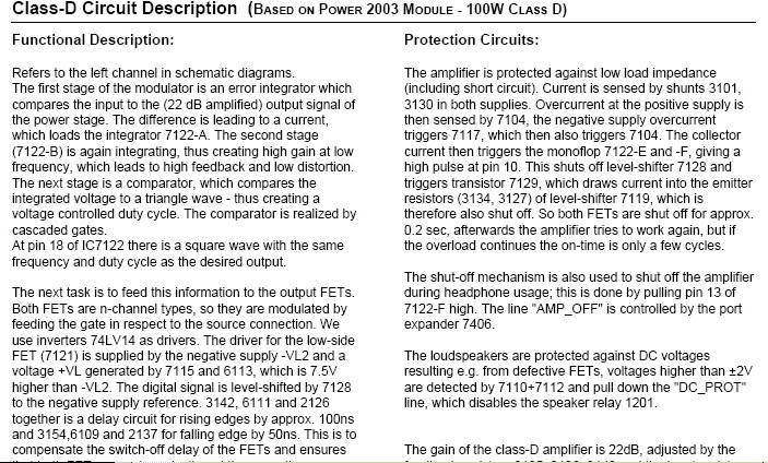

I think UCD proves exactly that!
I agree with what you say about self oscillating, but in this schematic I see it is clock based... inferior.
It could be alot simpler, this isn't very elegant.
This is more the "school book" PWM amp I think.
There's no such thing as a schematic for UCD, see the ucd180 thread Jan-Peter recently posted a paper which will bring you right up to speed on it. I'm working on a full bridge version again, might post it soon.

Ah, i had no time yet to look closely to philips schematic, it looked
selfoscillating...
I personally don't like this "school book"-PWM.
I just tried two times in sims with ClassD, first was with clockbased,
it had horrific thd...
Then i had an idea about a selfoscillating, and it showed thd of 0.2%,
without finetuning...
