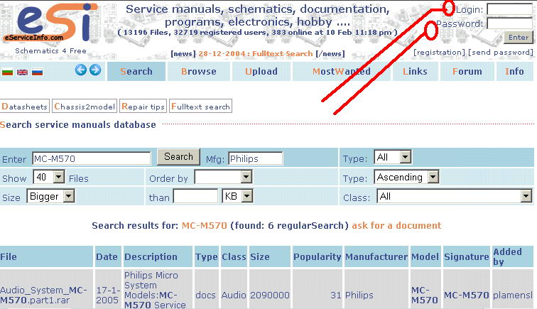

Hey guys!!! i found service manual, and a very good site to have manuals free.
This is the adress...you must type the model and the Brand name...the factory name.
Sometimes you just write "audio" or "TV" and the Brand, alike "JVC" and you have good answers.
Have to register....but this is easy...type there and ready!
http://fileshare.eshop.bg/index.php?what=search2

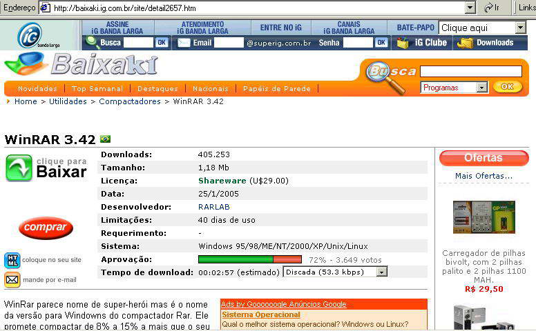

If you have not Winrar, go to this Brazilian site, hundreds of free programs!
Go to
www. baixaki.ig.com.br
this adress:
http://baixaki.ig.com.br/site/detail2657.htm
will send you direct to download are, just click in the green arrow.
A good chance to learn some Portuguese, the world sixth language. Enormous quantity of people talking.
This site has all world hi resolution pictures, also hundreds of freeware and shareware software...and the brazilian spirit, you are deeply welcome!

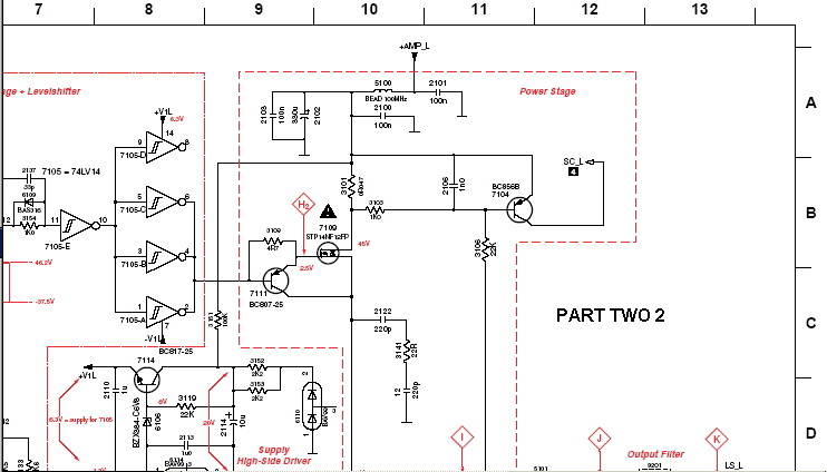

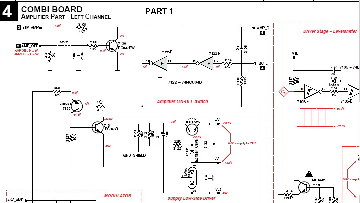

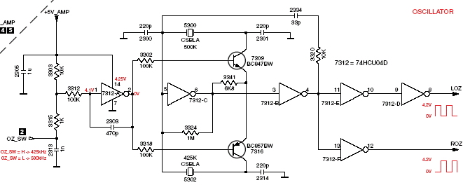

It looks like the simplest possible, self-oscillating using feedback,
coupled with some schmitt-triggers...

I tried to make an Adobe and them to Zip to reduce.... i reached exactly 10M...but negative!...i am sorry....but if interested in amplifier, in four images.... the modulator...i can post here.
