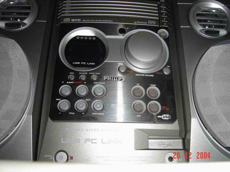

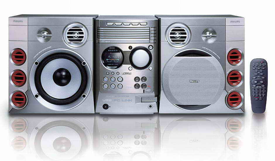

I bougth this Phillips, MCM590, some International Model, the one you may find everywhere...constructed in Holland, and imported in parts to be assembled in the destination country.
It is producing 15 volts of audio over 4 ohms, distortion may be something alike 0.5 percent when reach -20 dB above maximum, of course.... reaching -10dB, it may distort around 1 percent, and will remain the same till the top maximum volume.
Consumption, marked behind the set is 125 Watts, but it have some lamps, the old ones, filament lamps, not LEDs, and those have enormous consumption.
It is too much heavy to use some switching supply, i think a big transformer is inside, as the Central control weigth is around 5 Kg...maybe 10 pounds, not sure.
Headphone output have one relay switching when you plug the headphone...it is a 6W, 10 percent maximum distortion, 22 ohms traditional chip audio amplifier.
The line in, or auxiliary inputs are awfull...sounds not good.... remember some tape deck sound.
I am happy with it, i cannot call it Hi fidelity, as have not a flat response to make blind comparison...always some effect is on, so, impossible to compare in a fair way....but sounds good, i can call Hi Efficiency....Hi technologie.... Hi everything you want...but i cannot say hi fidelity, as i could not compare, as equalization on is creating some problem.
Output amplifier have a low noise fan, small heatsinks, and the board seems small....could no open 18 monthes guaranteed, covering everything, except Nuclear War!
I will put some text and 2 images.
I am waiting some discrete design to assemble Class D at home, sun or latter it will appear to us...something without chips....old good way, using soldering iron...and big parts..hehe
I am Brazilian, so, English not good...sorry guys!
regards,
Carlos

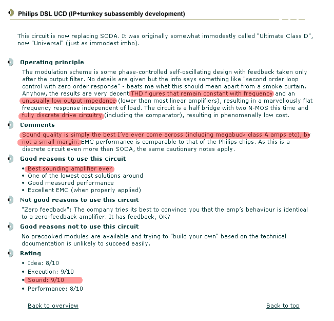

Hi destroyer X, welcome to the classD forum! I am fully committed to the switching power amplifier concept now, so have been away from the Solid State forum lately. The UcD does come in circuit board modules made by Hypex, as you know now, unlike what the sheet you posted an image of says. I'd say that a decent UcD circuit can be constructed by the DIYer from scratch, but tweaking may be necessary to get it right. Some MOSFETs may die in the process as well. However, IMO, a working less than perfect UcD type circuit is easier to do than a comparable sounding analog one.
I saw mention that the name UcD seems immodest. That point struck me since I named my SMPS design the Universal SMPS (USMPS or UnivSMPS for short) before I even knew about UcD. I can only think that the name for mine does fit since the controller concept is easily implemented with no exotic parts and without fuss using the ubiquitous CD40106B (74C14), the totem pole drive (half-bridge performance is superior to push-pull) is the common IR211x, and the output transformer is toroidal--easier to obtain and wind than EI ones. But I admit bias, as I know it does implement trade offs for the sake of simplicity.
I have yet to get around to building a UcD circuit. so cannot attest to how well its name fits. I suspect that the name is very appropriate, indeed. I may not actually build it using discrete parts, so any rendition I do may be closer to my original Nchamp (N-channel amp) design instead.

Sure, that your MCM590 aren't UcD based, because:
1) Output amplifier have a low noise fan. MA240 (80w) UcD based amp have not heatsink even.
2) MCM590 have not so much smart specs yet.
3) as far as i see, UcD is still not in use by Philips itself. They sell licenses for use UcD to the second companys(i.e. Hypex etc). Newest Philips chip "The TDA8931 is a switching power stage for high efficiency class-D audio power amplifier
systems. It contains a Single-Ended (SE) power stage, drive logic, protection control logic,
a full differential input comparator and a HVP charger to charge the SE capacitor (see
Figure 1). With this amplifier a compact 1 ´ 20 W closed loop self-oscillating digital
amplifier system can be built. A second order low-pass filter converts the PWM output
signal into an analog audio signal across the speaker."
And this is not UcD again..
PS: Subwo, i can hear in the UcD name several words, well associated with class D amplification..i.e. you(U) see(c) D(D)??
