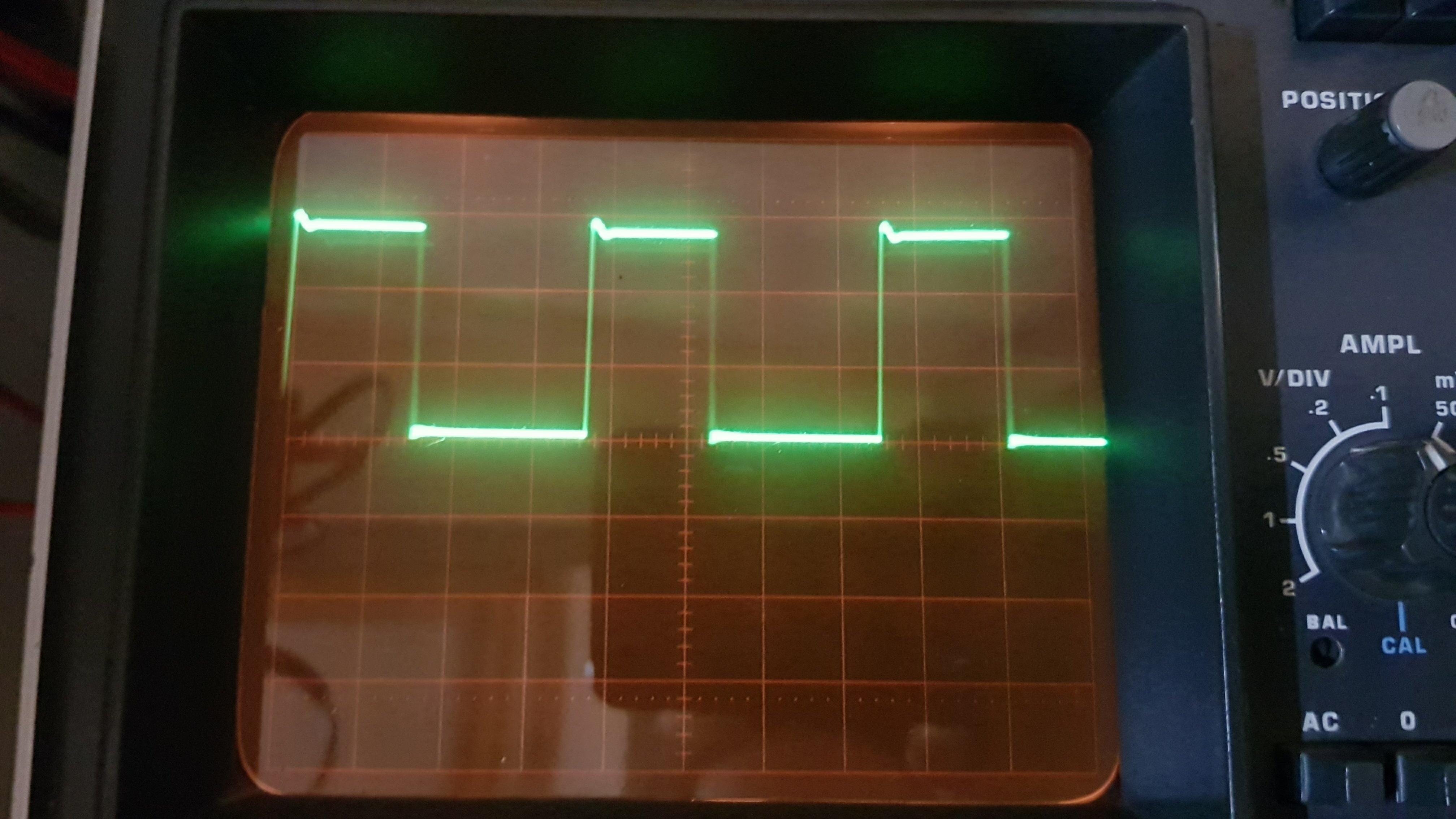

Very strange, this scope seems to adjust it's reference 0 line by itself when switching buttons and vertical measurement.
I will take some more measurements and photo's. One moment.
So, what I did. I set my power supply to a steady 10.0v (measured with my multimeter)
I set the oscilloscope to 0.5V/div (probes 10x). Probed with both channels and adjusted to CAL potentiometer so both channels EXCACTLY had 2 divisions negative and 2 divisions positive.
It seems like this oscilliscope is extremely sensitive to exact the same voltage measurements on differential measurements. Otherwise it adjusts it own 0 level on the Y-axis (vertical).
Should be calibrated now 🙂
Ch1 on the Gate
Ch2 in the Source
0.2V/div (with CAL potentiometers calibrated)
2ųs/div (CAL potentiometer calibrated to exact 3 full waveforms, it's almost CC)
10x probes
DC-coupled
Differential measurement.

There is nothing wrong with that, that I can see.
If you probe it with only the ch1 probe, do you see the ripples, top and bottom, again?
As expected. It's due to a bad reference for the scope.
Try pin 2 (ch1) and 3 (ch2) of the optocouplers. The vertical amplifiers will have to be set to 0.1v, most likely.

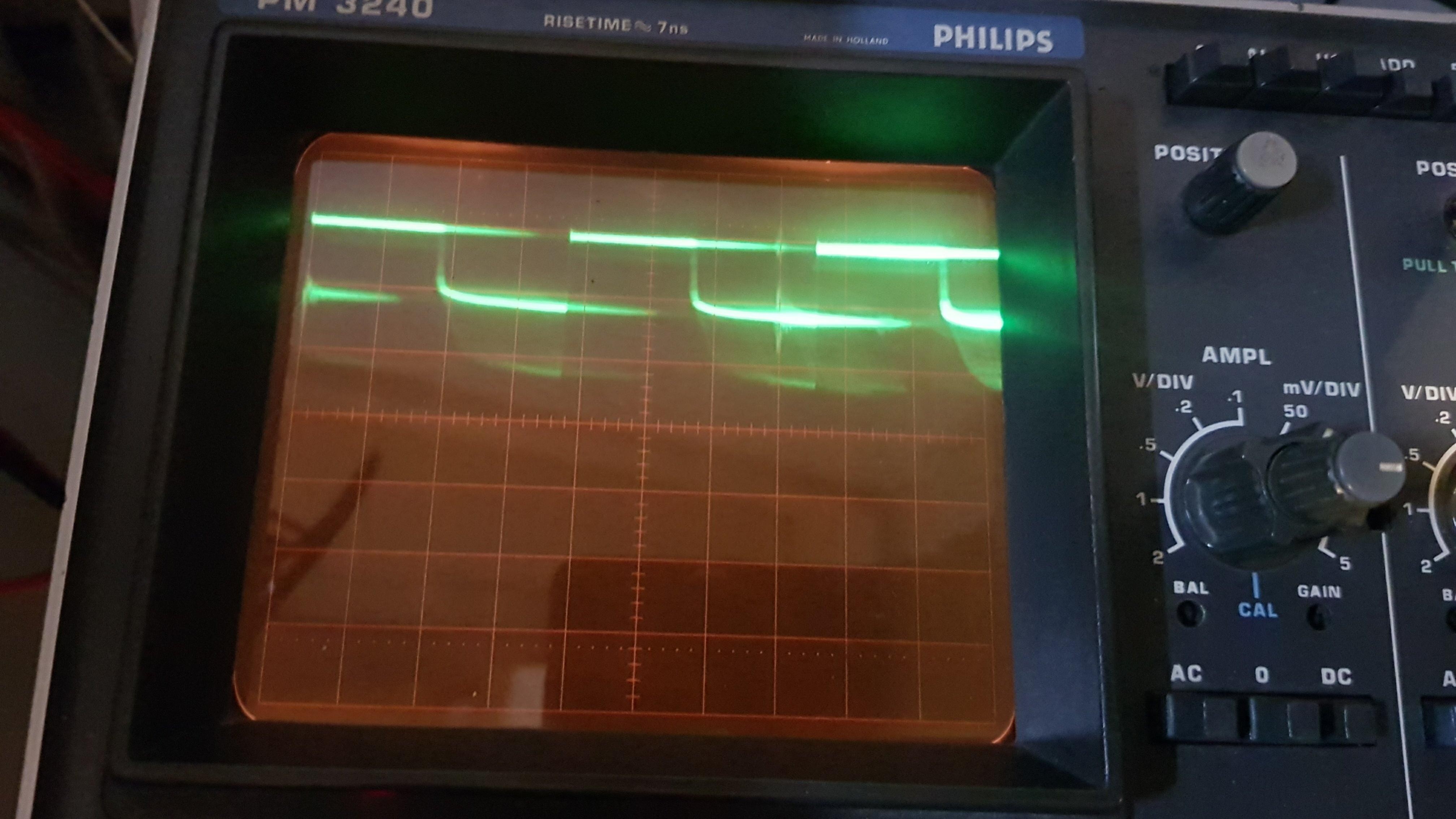

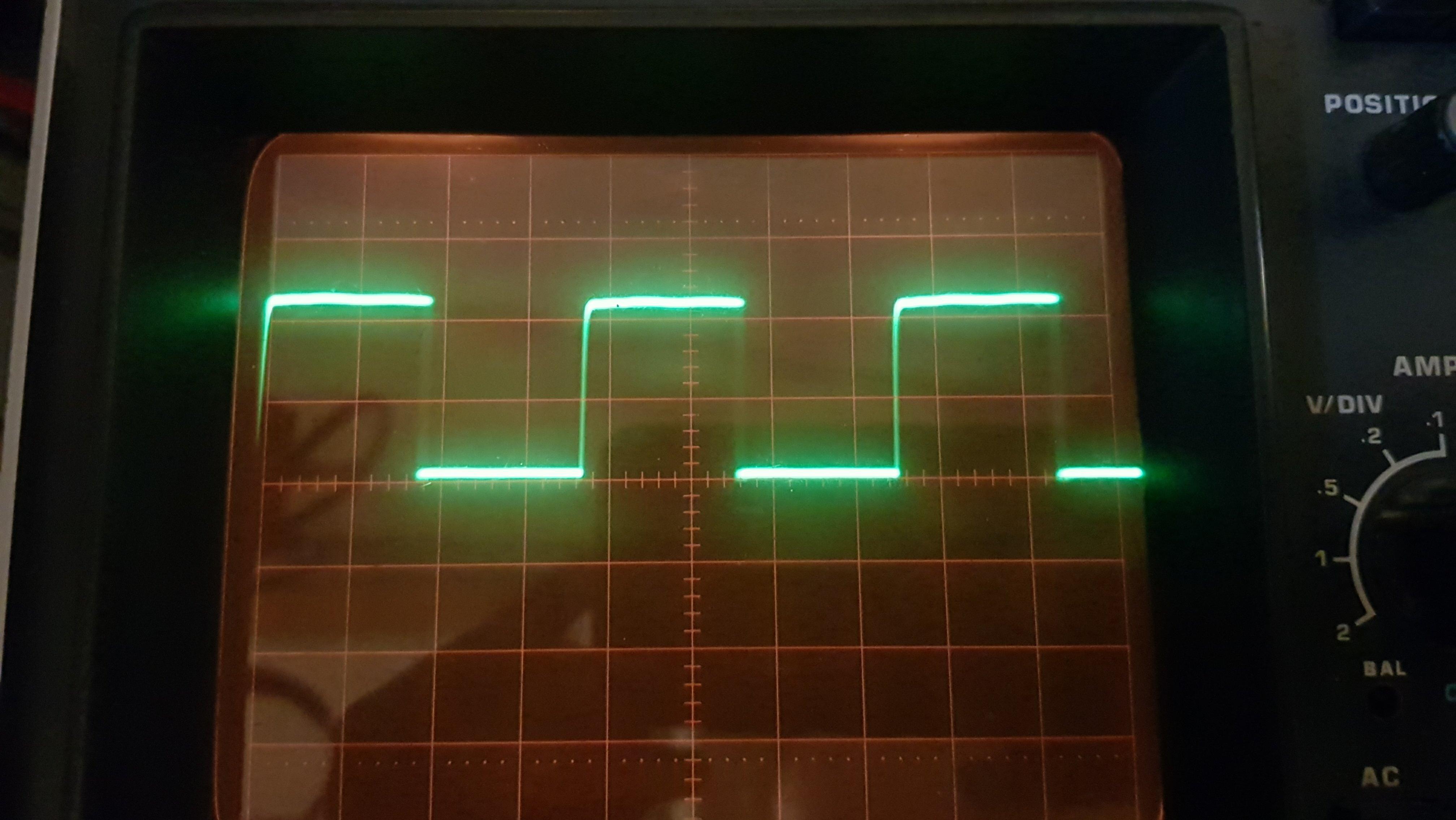

Attached first photo is from the LOW-side
Attached second photo is from the HIGH-side
Ch1 on Pin2 and Ch2 on Pin3
50mV/div
2ųs/div
DC-coupling
10x probes

Measure the duty cycle on the high and low side. One probe on the gate, the other on the source.
The waveform for the optocoupler should be on the reference line, like the other waveforms.

Duty cycle on the Low-side is 42.3%
Duty cycle in the High-side is 48.8%

The waveform is not in reference with the middle line.
With both measurements the oscilloscope was centered in the middle reference line before measuring.

Isn't pin 3 of each optocoupler grounded (0 ohms to the secondary CT)?
R72 on the driver board is in series with pin 2 of the optocoupler. Place probe 2 on pin 3 of the optocoupler and probe 1 on pin 2 of the driver board (which is on the other side of R72). Do you get a waveform that's sitting on the reference line?
Did the FETs fail with the limiter in place.
The multimeter reads continuety between Pin3 of the optocoupler and secondary GND.
2ohm (100w) resistors soldered in place 🙂
Should I try all 4 banks loaded with a single fet?
Probe 2 on Pin3 optocoupler and probe 1 on Pin2 driver board (I assume you mean R70) will not result in being nicely referenced in the middle (on both sides of R70).
I measured the DC voltage with my multimeter (black probe on Pin3 optocoupler and red probe on Pin2 driver board) and it rode 2.12v
