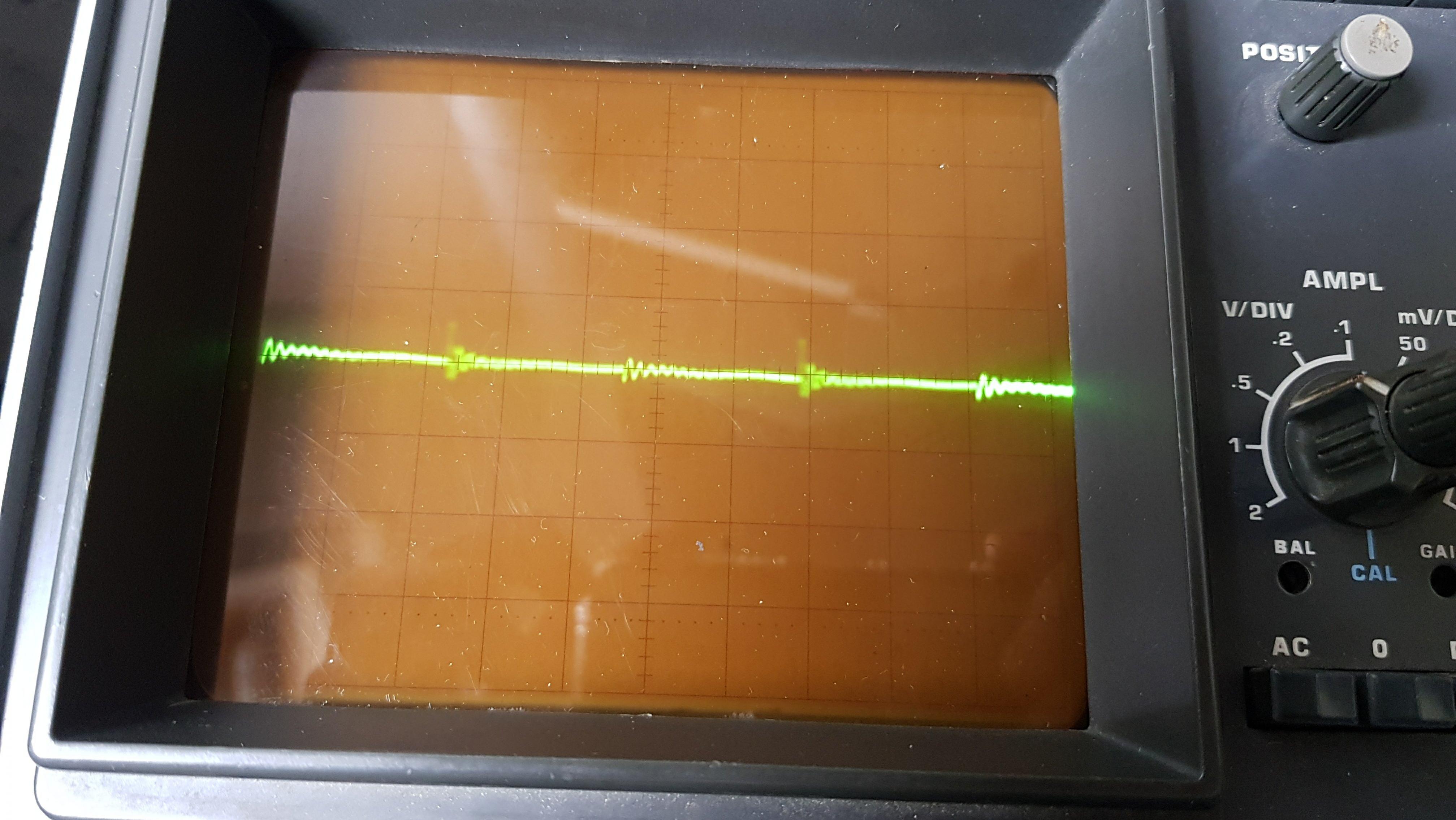

Attached is a photo from what is measured at the high-side source pads.
Oscilloscope is set at 10mV/div
This signal is not present at the speaker + terminal and seems to be filtered out by the output inductor.

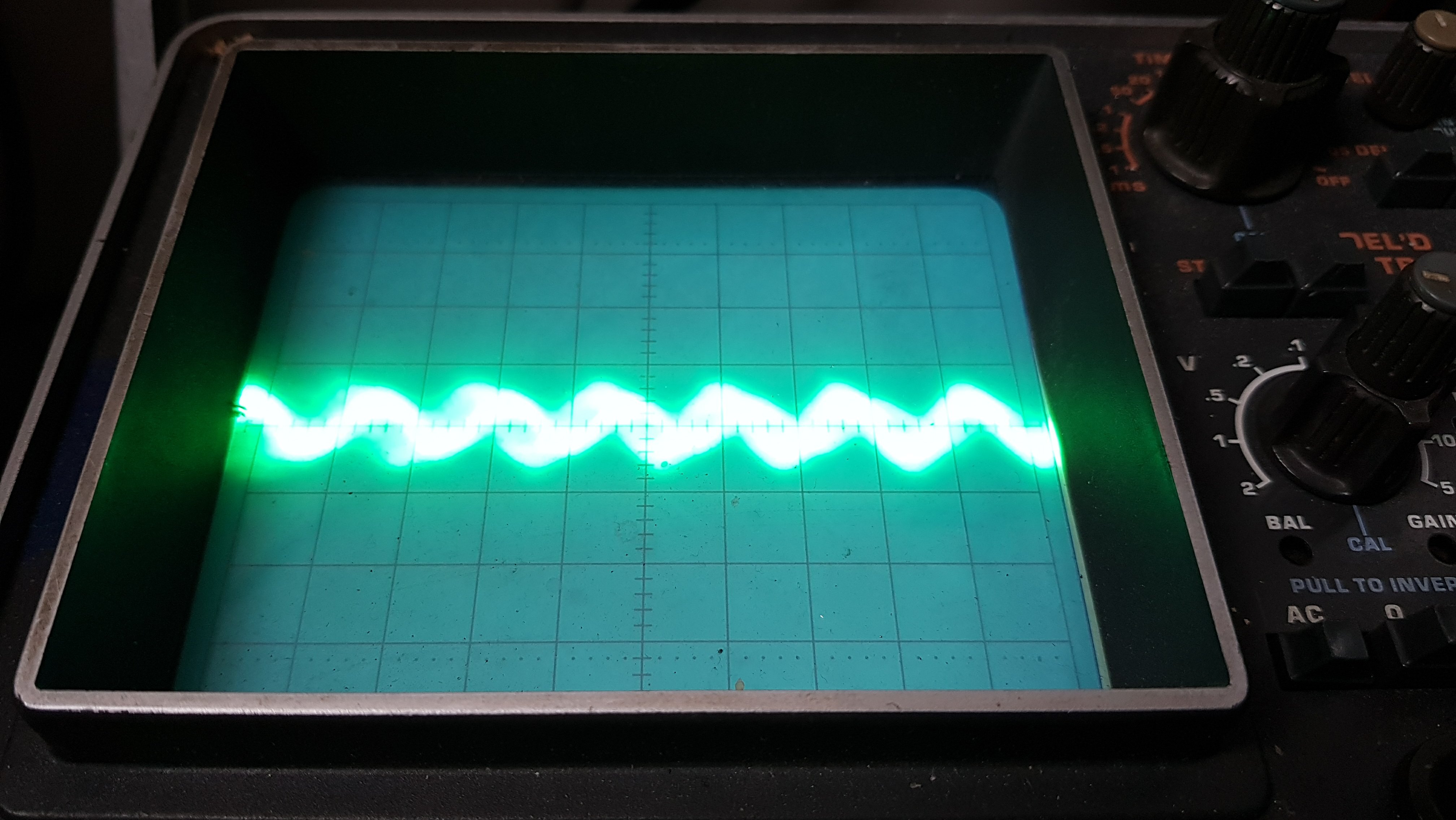

Main probe on the Gate
Differential probe on the source
0.2V/div
2ųs/div
Wobbly oscillation seems to be not present now.
A very clean PWM gate drive wave now.
0.2V/div
2ųs/div

I see.... Yes, you are right. Watched the wrong video's.
I don't have a differential probe. Got a single Tektronix P2220 probe.
The photo is taken with the GND probe on the source and the main probe on the Gate. Removing the GND probe makes the gate drive wobbly again.
My old oscilloscope doesnt trigger at DC coupling, so I have to choose AC coupling when measuring waves (oscilloscope had it's best time, some buttons are not functional anymore)
0.2v/Div
2ųs/Div
0.2v/Div
2ųs/Div

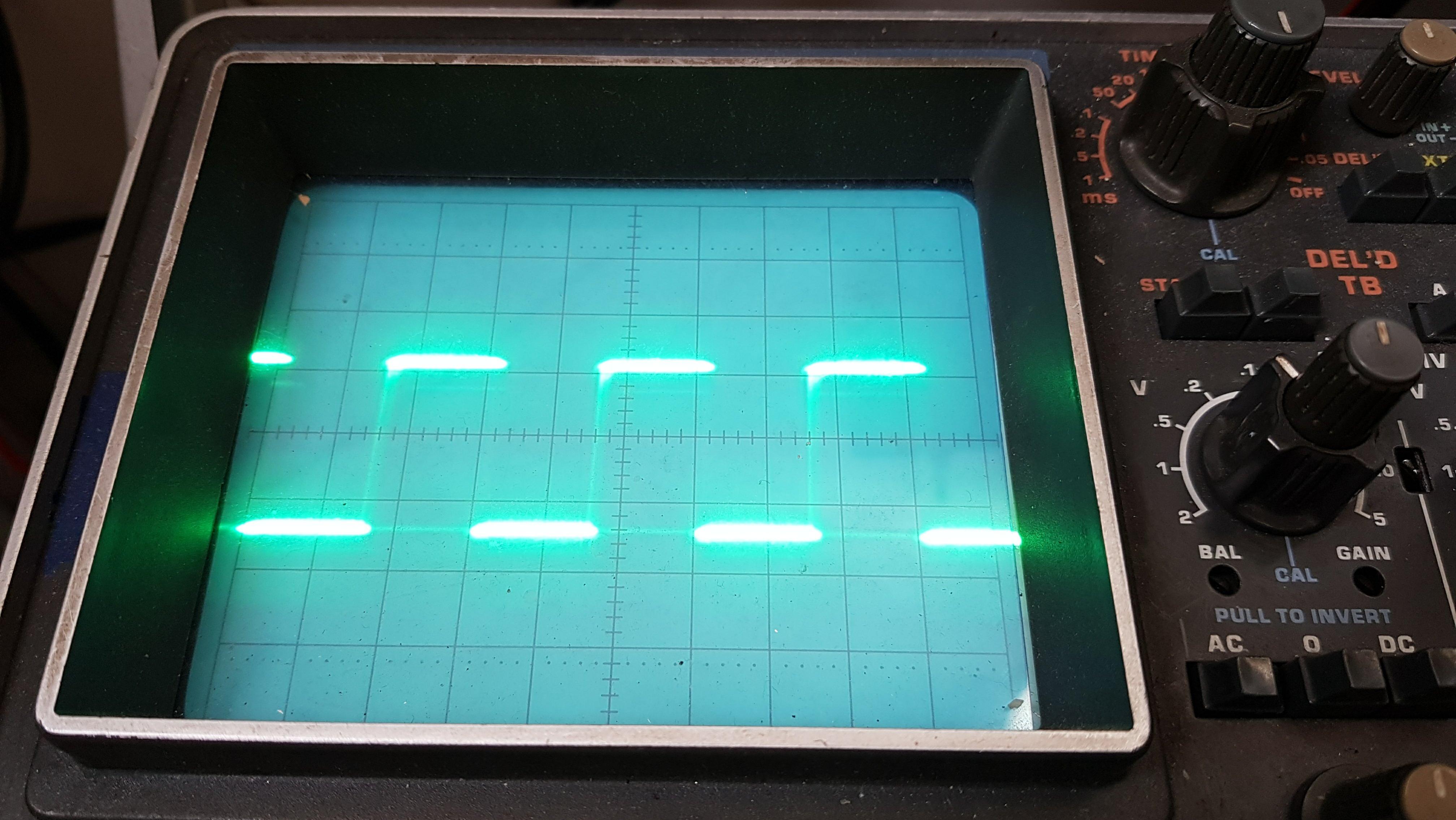

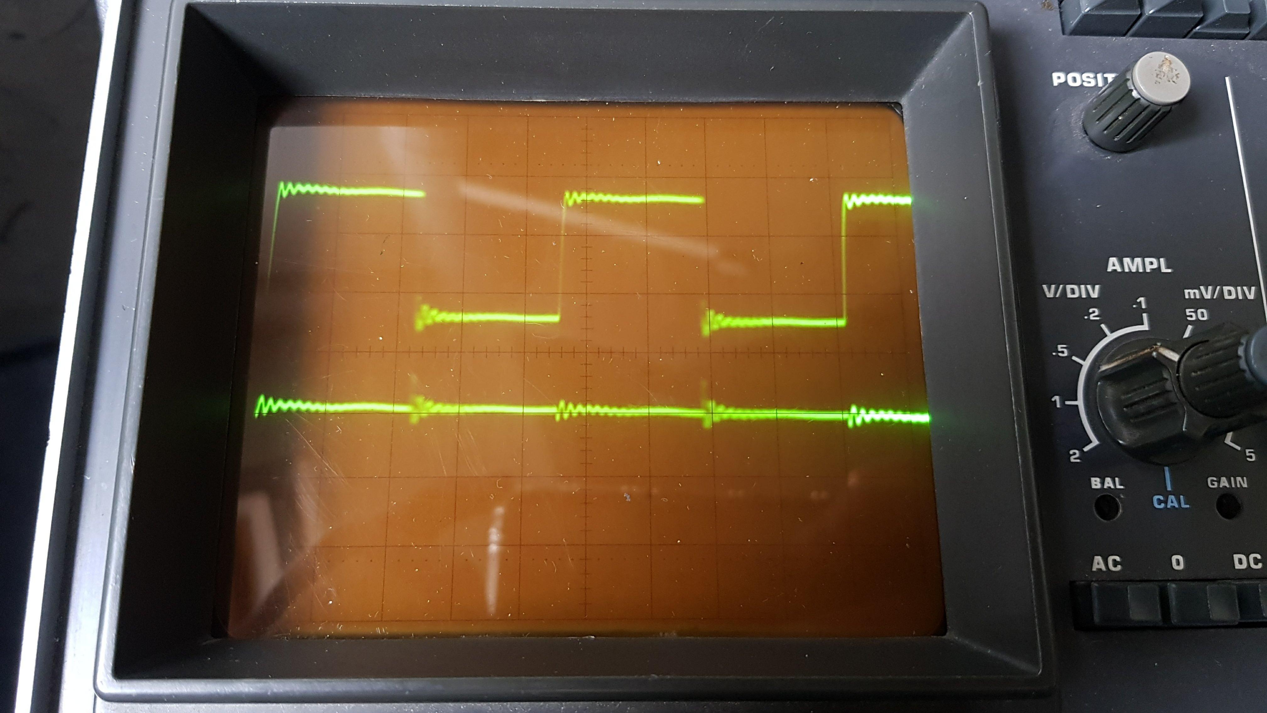

So, I bought a better working scope, with a couple extra probes. Here we go ^-^
One probe on the Gate, another probe on the Source. Both on DC coupling.
0.5V/div
2ųs/div
Both probes on 10x
0.5V/div
2ųs/div
Both probes on 10x
Photo one is the drive signal to the Gate
Photo two is the signal on the Source
Photo three is both Gate and Source seperated and clear seenable
Photo four is both Gate and Source combined (DC coupled)
