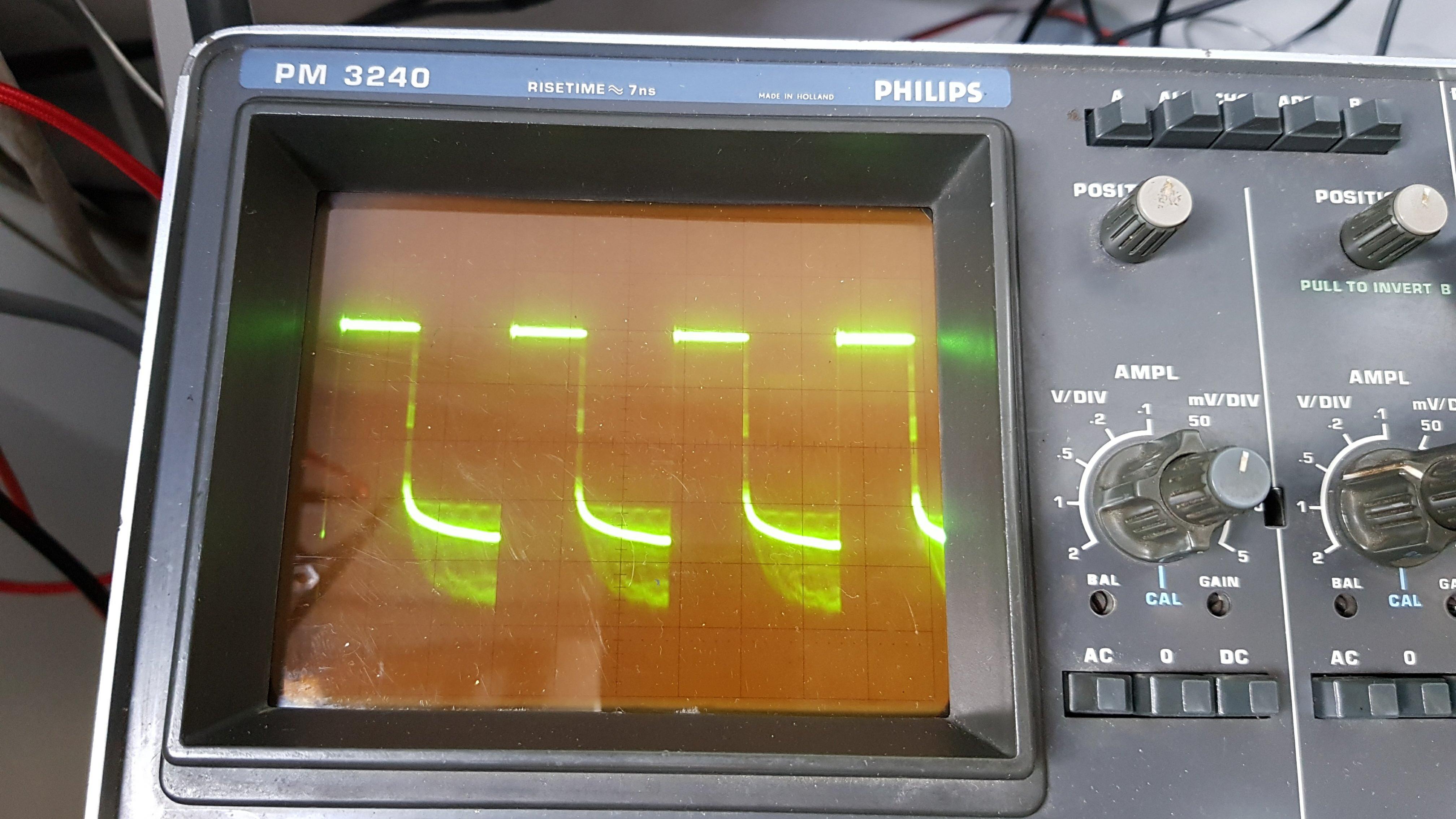

Photo 1 is the waveform of the Low-side 6n137 Pin2 referenced to secondary GND.

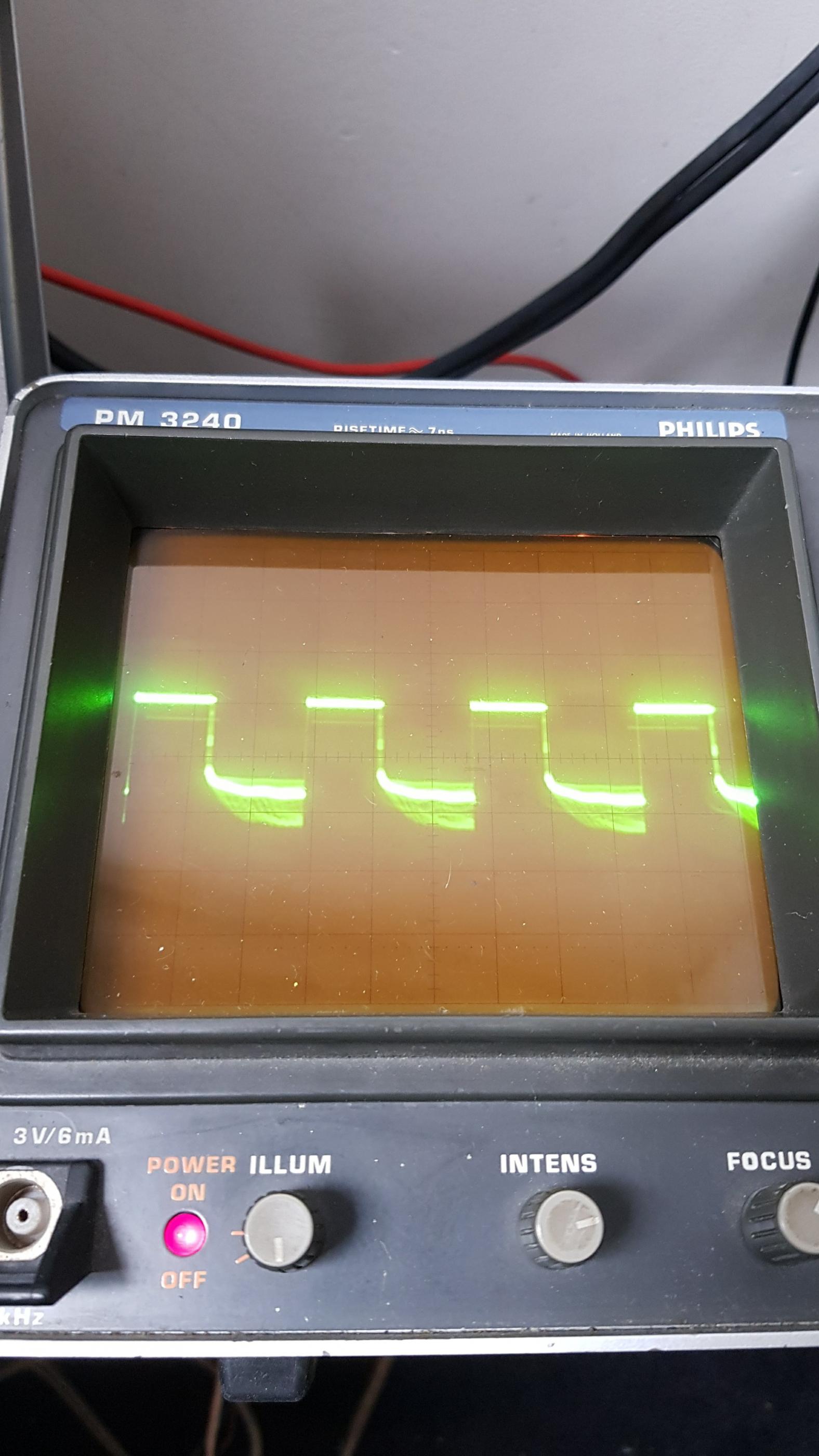

Photo 2 is the waveform of the High-side 6n137 Pin2 referenced to secondary GND.
10mV/div
2ųs/div
AC coupled (It does not show the waveform in DC coupling, it jumps out of the screen)
Probes on 10x

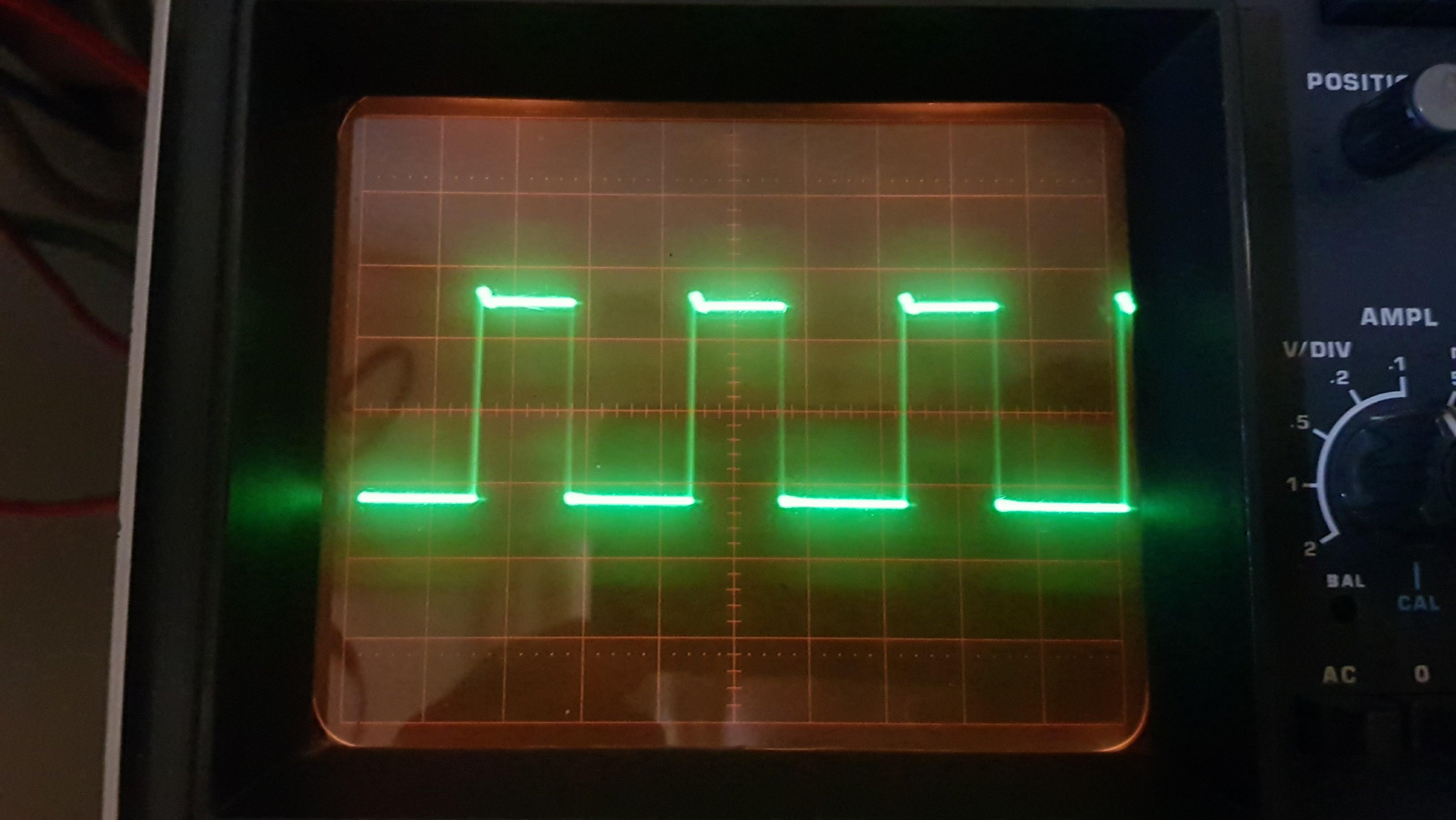

First, measure the low-side drive. Remember, ch2 probe on the source. Post a photo of the drive.
You need to use DC coupling (possible in differential mode).

Set the timebase and vertical amplifier so that you get about 3 full cycles and the waveform fills approximately 3/4 of the top half of the display.

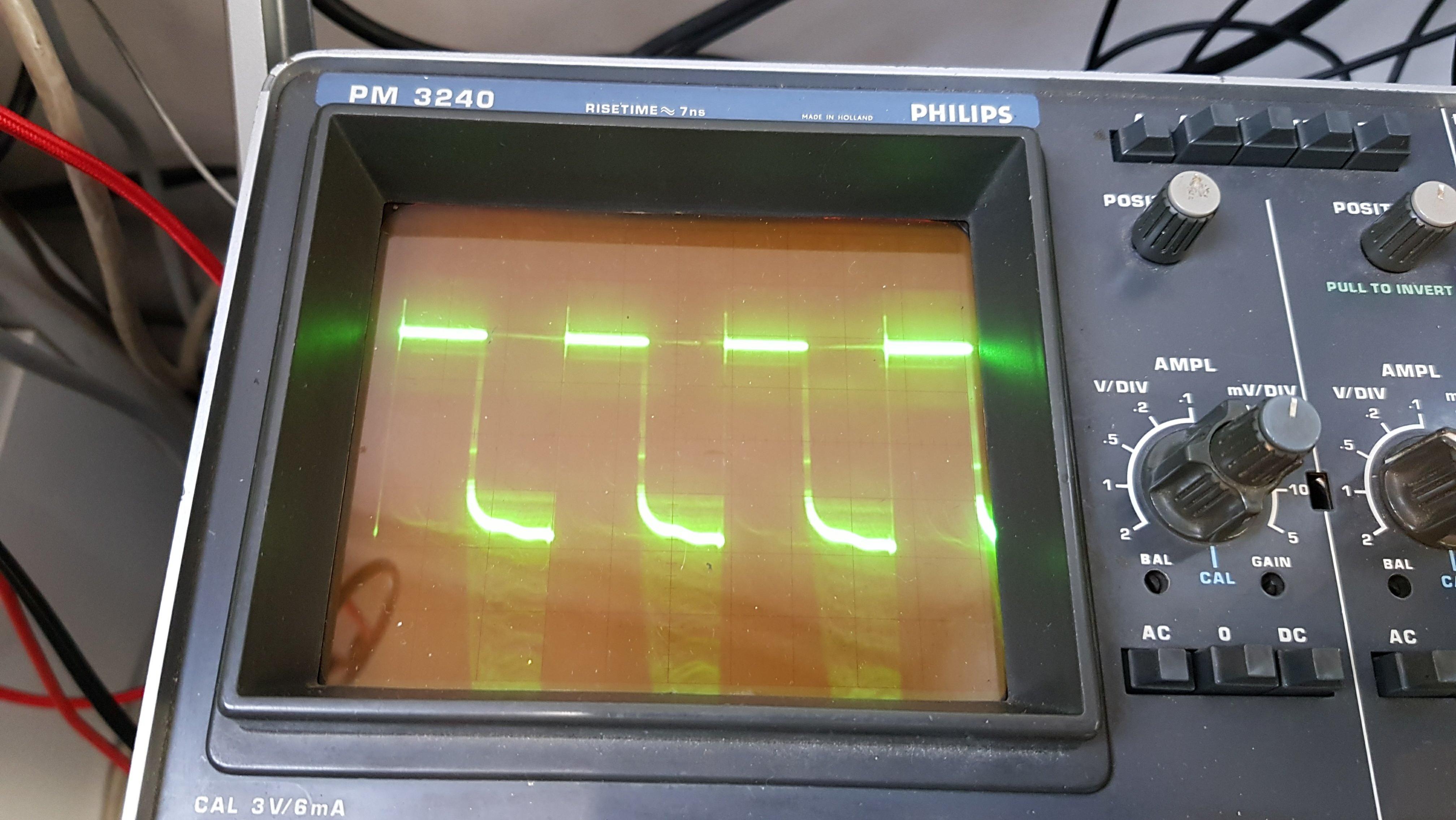

So, I measured the low-side gate drive here
Ch2 attached to Pin4 (source) of the driver board.
Ch1 attached to the gate resitor
I needed to press the HF button (below the TIME/DIV potentiometer) in order to trigger the scope at DC-coupling (first the DC button was pressed). Otherwise the scope could not be triggered in DC-coupling.
0.2V/DIV
1ųs/DIV
Probes on 10x
It was not possible to set the vertical measurement to a larger amplitude. Otherwise the scope does not trigger and makes it a straight DC line.

Did you align the trace to the reference line before probing those points?
The trace should not be below the reference line.
Are both channels set to DC coupling?
If the differential setup is working, when probing the low-side gate with the ch1 probe alone, the trace should disappear down. Then when touching the ch2 probe to the source leg, the waveform should show up as a normal waveform.
