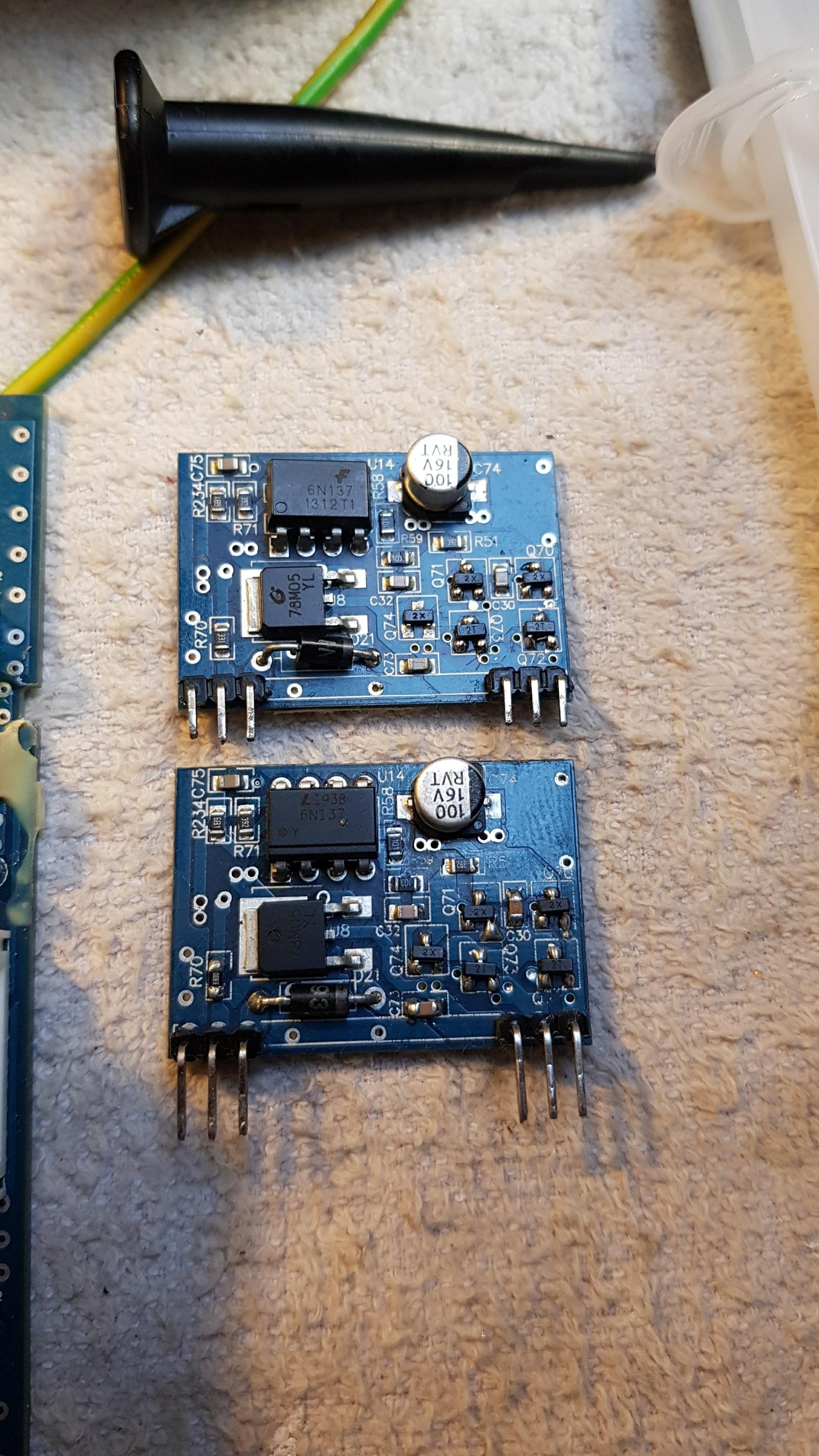

This amp has 2 Optocoupler driver cards on the output.
(photo attached, pin configuration from left to right)
Pin 1: GND
Pin 2: Input PWM drive (coming from a 74HC00 IC)
Pin 3: Power supply transformer PWM
Pin 4: VCC
Pin 5: Output PWM drive for bank 1
Pin 6: Output PWM drive for bank 2
One side of the amp does not want to create an OUTPUT drive PWM going to the gates of the IRF640N's. Even putting in a 100% good driver card results in no usable PWM gate drive.
The driver card receives a PWM drive input on Pin 2.
Also the power supply PWM on Pin 3 is present.
The GND and VCC is also present on Pin 1 and 4.
There is just no output on Pin5 and Pin6
Almost every part on the output PWM circuit has been replaced (all the 2x and 2t transistors, 74HC00, 6n137 optocoupler). All resistors on the driver card has been checked and are OK.

Finally I found the problem 😀
The 15V zener diodes attached to the gate resistors were leaking.
Now, the 2 output drive cards output a PWM gate drive.
Just one output card outputs a wobbly PWM gate drive (first attached photo). I imagine this could be the reason why the output fets of this amplifier died.
This driver card recieves a wobbly PWM wave from the power supply transformer on Pin3 (second attached photo).
The transformers are driven correctly.

Yes, this is true, sorry, forgot to mention.
This is the other driver board (not the driver board from the start of this thread)

I rewound the transformer winding. Still the wobbly oscillation is present on Pin3.
With the driver card removed, the transformer PWM with oscillation is still present on Pin3.
I suspect the problem is the transformer, but rewinding did not make a difference.
This amp is slightly different from what I was using as a reference.
The winding that you're referring to is rectified on the driver board. Measuring from pin 4 to the input of the 5v regulator should give you the DC that I was expecting.
Pin 4 of one driver board (low-side) connects to the negative rail. Is that correct?
Pin 4 of the other driver board connects to the source leg of the high-side driver board. Is that correct?

The driver board which outputs a wobbly PWM gate drive is the high side section.
Do you mean the hum which is present at Pin3?
As reference from the same good working amplifier, this oscillation should not be present.

Currently the driver boards output a PWM gate drive. Just the high side driver board outputs the strange wobbly oscillation. To check how this oscillation would react on switching fets I tried 1 fet per bank with a very low amount of current.
The amplifier is instantly killing the output fets at this point when they are installed (in all 4 banks, also the good looking low side banks). Even with only 2amps of PS current.
When the amp powers up (one fet per bank installed) the amplifier gives a single ticking sound and the output fets are instantly killed.
