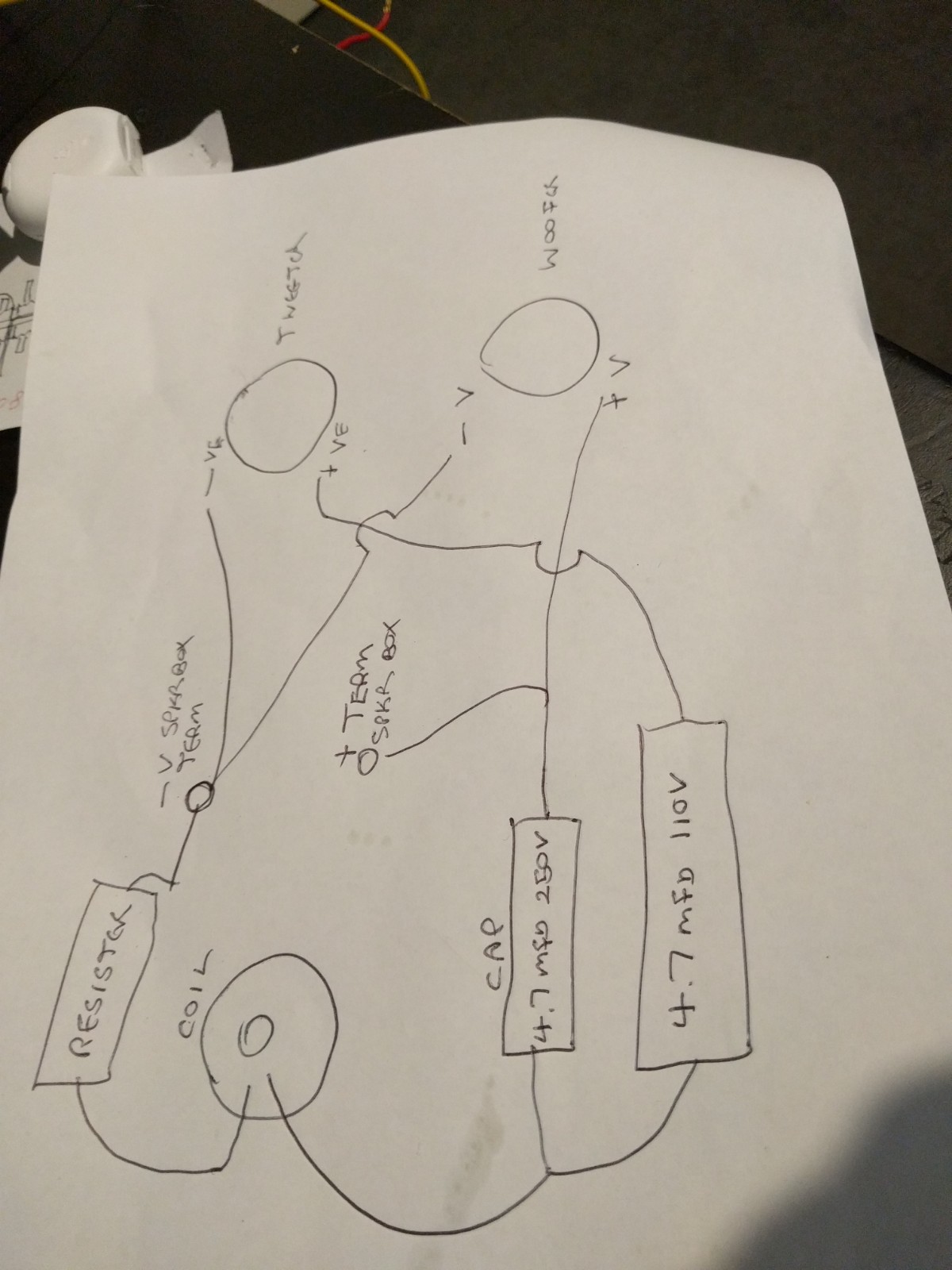

Do Soundlabs sell suitable resistors.

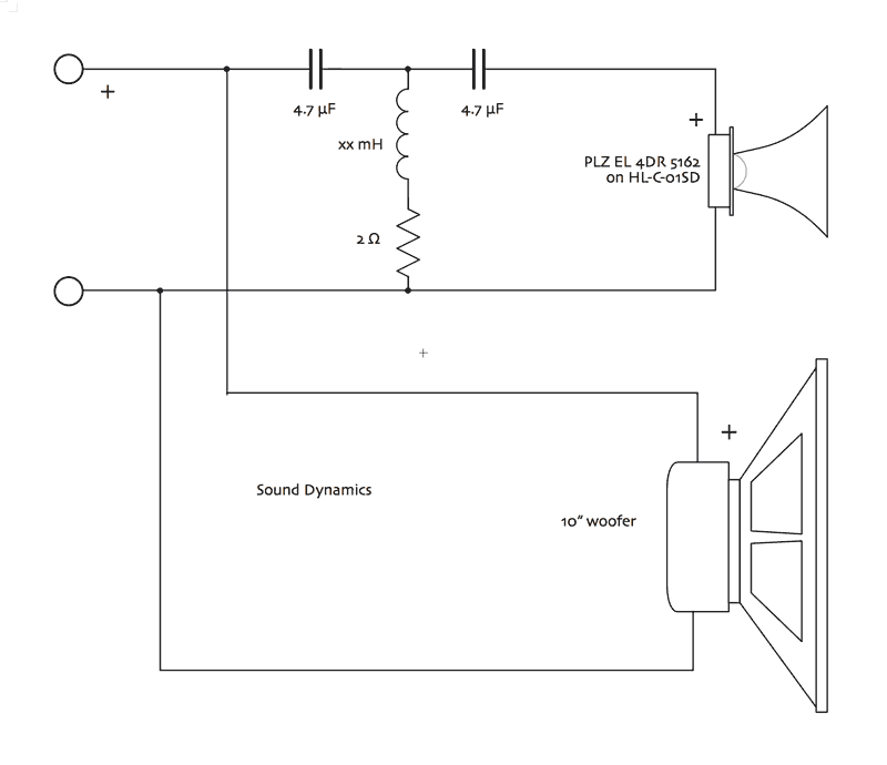

Looking for 2 ohm, 2.2 ohm, 3.3 ohm, maybe 5 or 10 watts?

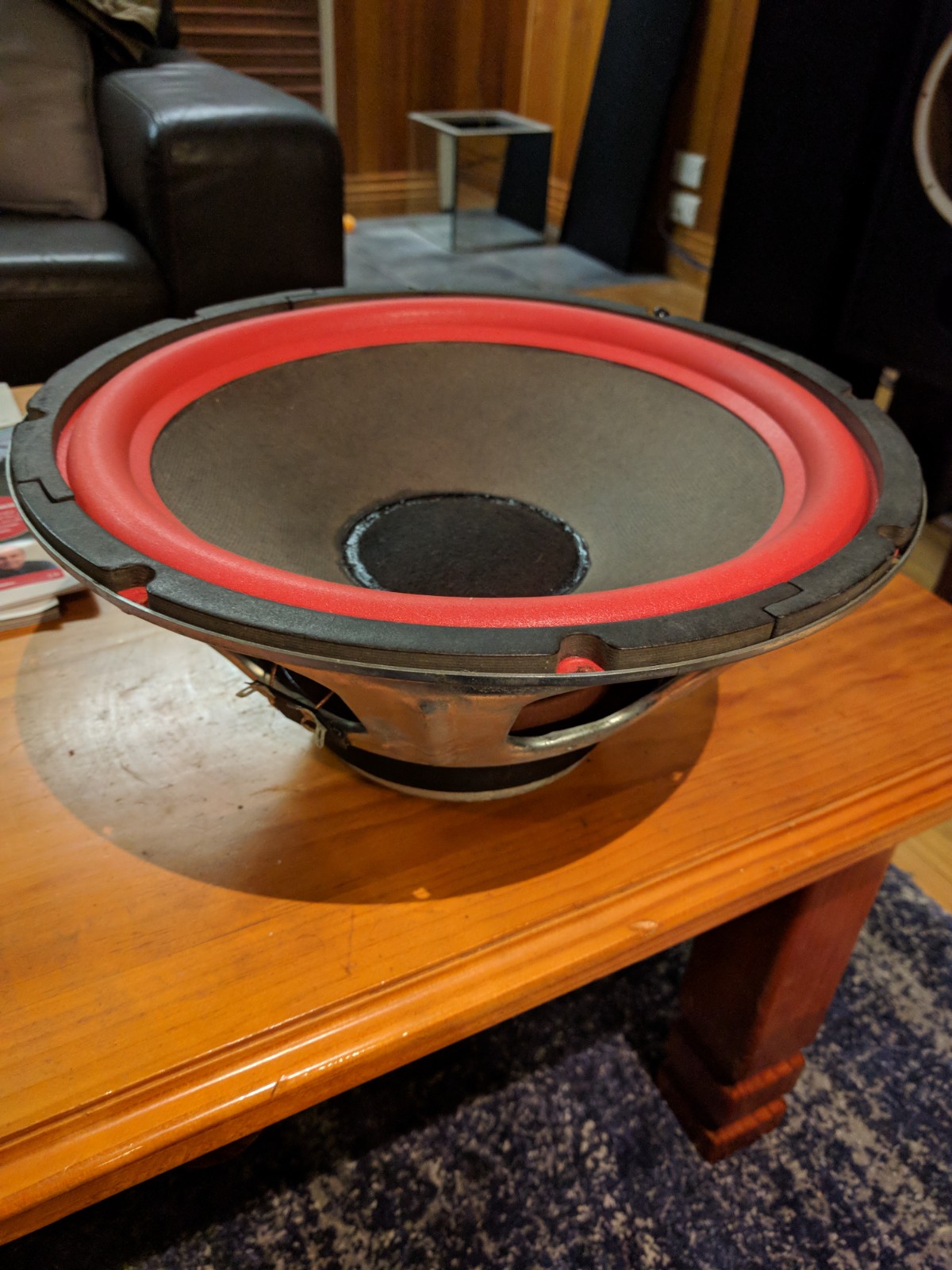

The Sound Dynamics Concert 500 Loudspeakers are first off the rank to be rejuvinated.
These Speakers sounded OK but were lacking in any kind of treble.
Treatment:
  • Internal 20mm x 12mm Hardwood bracing.
Side, top and bottom panels, and Baffle to Rear just above the woofer.
  • Fully lined with 2" thick furniture grade foam.
  • Drivers treated with butyl mastic.
Applied between chassis and magnet, and along chassis ribs.
  • Replaced all Crossover caps (PP) & resistors, and rewired.
  • Soldered internal wiring directly to drivers.
  • Sealed bass cones with matte Mod Podge.
  • Isolated boxes from stands with blobs of butyl mastic.
  • Heavy duty stands spiked to floor.
Things remaining to do:
Add 100ohm resister across terminals.
Pack the area behind the tweeters with wool (top 30% of box)
Replace speaker terminals with non ferrous.

Originally Posted by Max Planck View Post
One easy and useful mod is to fit 100R across speaker input terminals, 0.6W is enough power rating for low level listening, 5W WW for full power usage.
Are you saying to place this part across the internal section of the +ve & -ve speaker binding posts?
What improvement will be achieved from this?
Yes directly across the binding posts, if you fit them to the outside of the binding posts you can AB compare easily.
Such resistor provides a load to terminate the cable at high frequencies and quench RF pickup that can cause subtle noise in some amps.
Doing this helps with taming highs harshness.

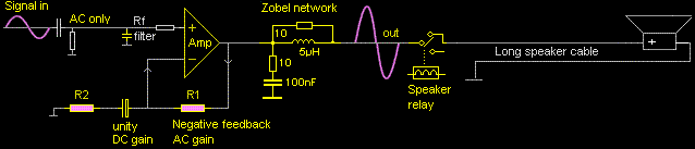

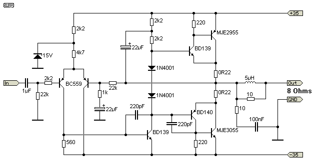

Take a look at the circuit of an amp, in particular the output.
Then consider this..
Zobel Network
and this..
Zobel network placement
No, what i am intending, is tha wuld affect the amp, not the speaker.
I would be wary of anything Max has to say.
As, i think, Allen is suggesting something in an amp, it could be akin to a speaker Zobel, something else that affects the amp (althou if on a woofer or midrange can make an XO easier).
