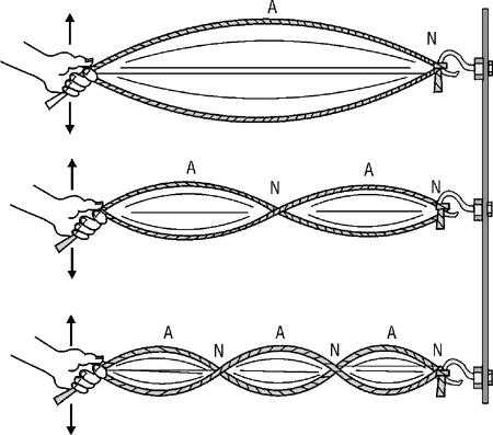

I have a different take on damping a vented box. 1-2" may not always be enough to dispatch the box modes (standing waves).
There is a concern that too much damping material will diminish the vented resonance, but there are a few reasons I can suggest to instead use enough damping material to deal with the standing waves and not stress as much about the bass alignment. (Note that I'm not saying you have to stuff the whole box, less than half should be plenty).
1. Damping material doesn't work as well at the bass frequencies.
2. Higher frequency issues are generally more important and standing waves are more complicated in nature.
3. The bass resonance can reasonably be compensated by re-tuning, equalising, room position etc. etc.

Whatever amount you decide, be it 20%, 30% etc.. have this much of the top to bottom, side to side and back to front dimensions covered.
One way you can avoid crowding the driver and port is to put it all in the top and back, rather than the bottom and front.. assuming the driver is in the middle and the port is at the bottom.
The other effect I was talking about..
Not sure of the payout you're suggesting.
..will be covered by this arrangement. The higher (middle) frequencies get tangled up bouncing between the surfaces. This causes hot spots and nulls that vary with frequency and may cause a rough response. Dealing with this requires for example that at least one surface of each opposing pair is covered.

Hi Allen.
The illustration and description has thrown me a little.
Not sure how it relates to insulation layout.
The front panels of the enclosures in question house a tweeter in the top 20%, then a 10" woofer in the next 60% and a vent in the bottom 20%.
Using your description do I line the entire box (top, bottom, sides, front and back, but in the top 20% where the tweeter is I also stuff this section so its volume is filled?

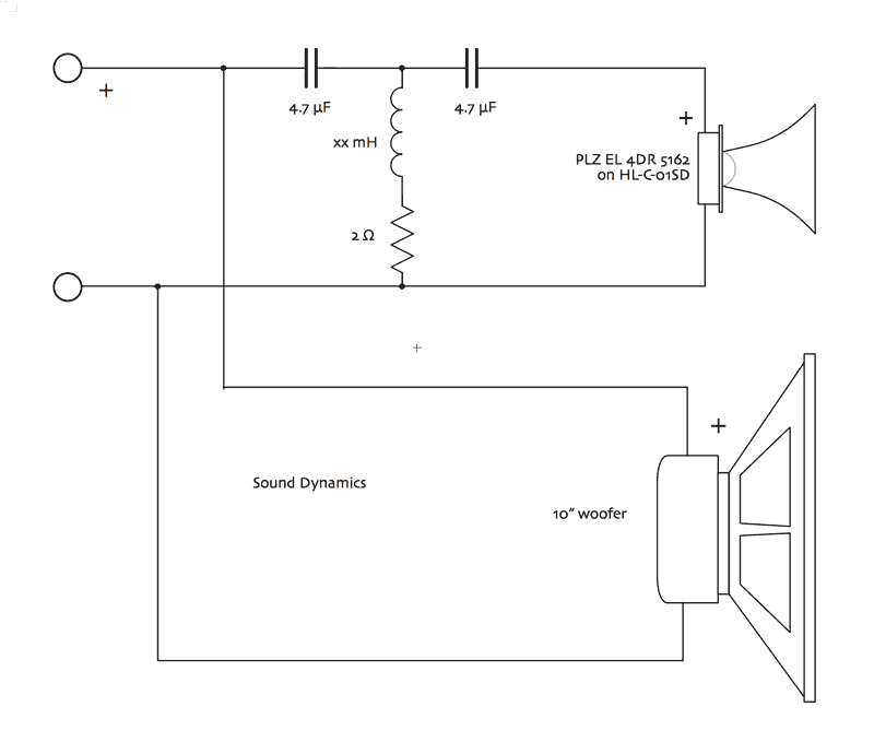

Prettier XO diagram
833383d1586764746-sounddynamics-loudspeaker-crossover-upgrade-sd-xo-map-png
dave
Hi Dave.
Although the schematic shows 2 x 4.7 MFD Caps, the actual crossovers feature a smaller 4.7mfd 100v BPT cap and a larger 4.7K 250v Intercap cap.
Is 4.7K another way of describing 4.7mfd?
Also the circuit illustrates a 2 ohm resister.
Do I go for 5W or a 10w resister?
thanks
Cliff
A 250v cap will be larger than a 100v.
100v caps are fine, but often poly caps are hard to find with that voltage rating. 50v is probably fine. Get 4 of whatever you can find.
5w Rs are also probably OK, but 10 wouldn’t hurt. Non-inductive if you want to splurge.
dave
