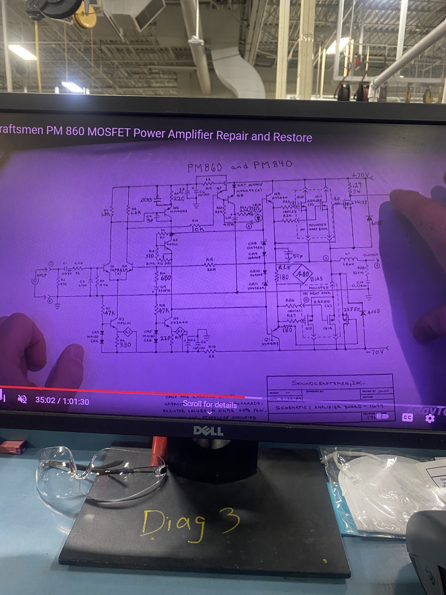

Hello, good day. after pulling the amplifier apart i found 50v dc on the positive pin that goes to the led light. after comparing it to the other channel the volts are close to zero. the grounds measure the same. I am sure the problem is on the positive side. R22 IS 3.3K RESISTOR and it looks burned,but still shows 3.3k ......some how i have too much voltage on +of the ledOk, check the small parts as mentioned in post #40.
Can you please post the part of the schematic with the LED that stays on?
What is the LED number? The schematic is very bad and it's hard to tell
what is connected where.
The clipping lights have nothing to do with the IC chips in there. It's likely Q8 is shorted. Q8 for each channel should be on the driver board on the front side of the heatsink near where the power wires plug on.
Ok, I did check Q7 and Q8 ... both seem to check out ok with my dac-55 transistor tester. I did notice that the 3.3k resistor near Q8 is chard. Would that cause a problem ? I measured the resistance and it does show 3.3kThe clipping lights have nothing to do with the IC chips in there. It's likely Q8 is shorted. Q8 for each channel should be on the driver board on the front side of the heatsink near where the power wires plug on.
That resistor burned because the circuit is stuck on. It is possible that R10 (10k) is open, but I doubt it. Otherwise something isn't adding up here. Did you remove them and test or was it in circuit?
