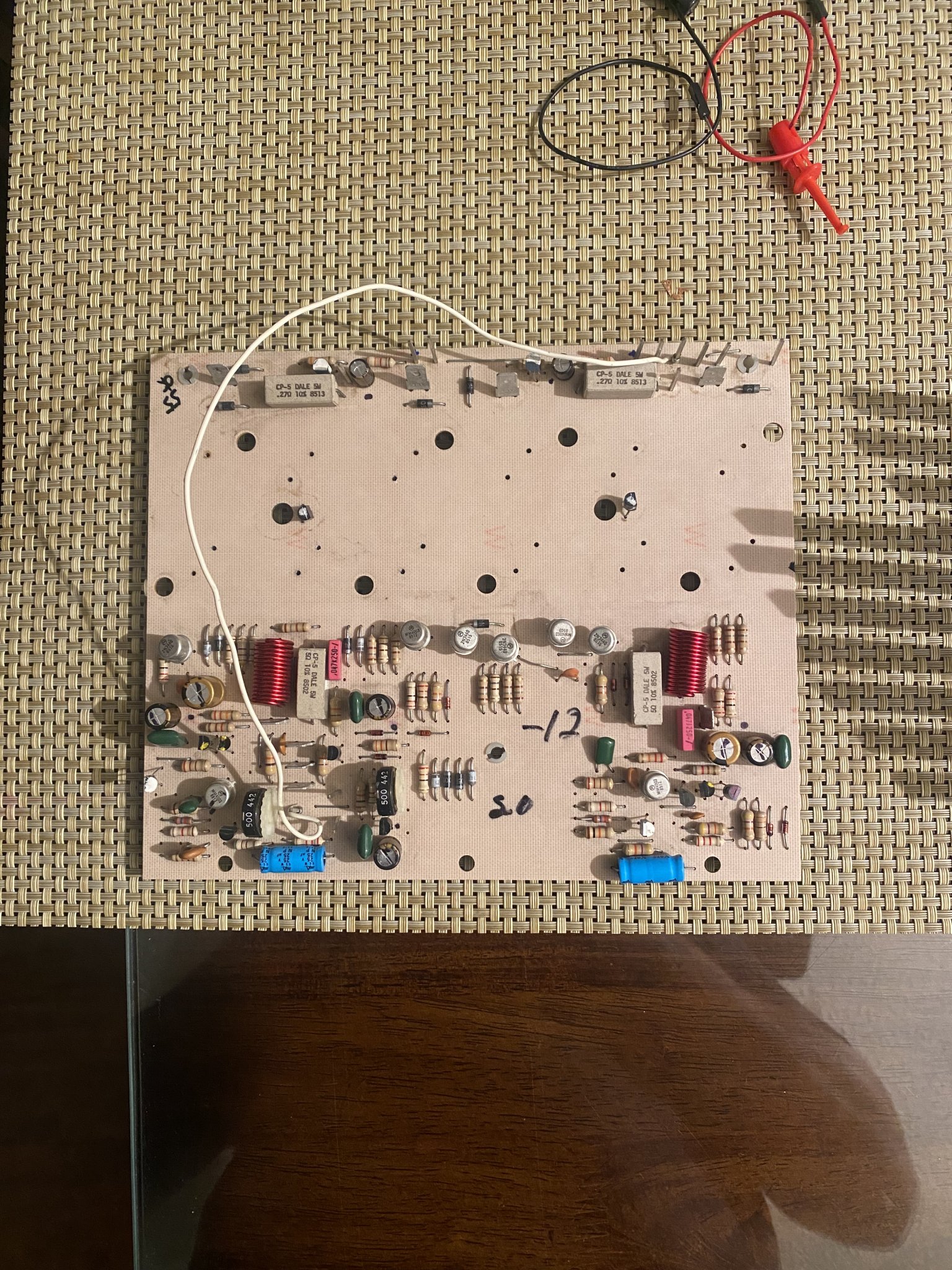

I found R22 is connected to the cathode of the led, it shows signs of overheating but the resistance is what it shows in the diaghram
Could you check the number of the resistor again, that can't be right.I found R22 is connected to the cathode of the led, it shows signs of overheating but the resistance is what it shows in the diaghram
R22 is not connected to any LEDs.
i think the r22 is located on the driver board,not the pwr supply board....Q7 AND Q8 ARE MPSA93 and are connected to R22 WITH...look on the driver boardquestion? is there a difference between a mpsa92 and a 93
i replace q7 and q8 with mpsa92The 92 has higher voltage rating than the 93, but either is ok in this circuit.
if you look on the top left side there is a cement dale resistor ...close to a small capacitor..you will see 2 pins sticking straight up....those 2 pins are connected by wires to the led
