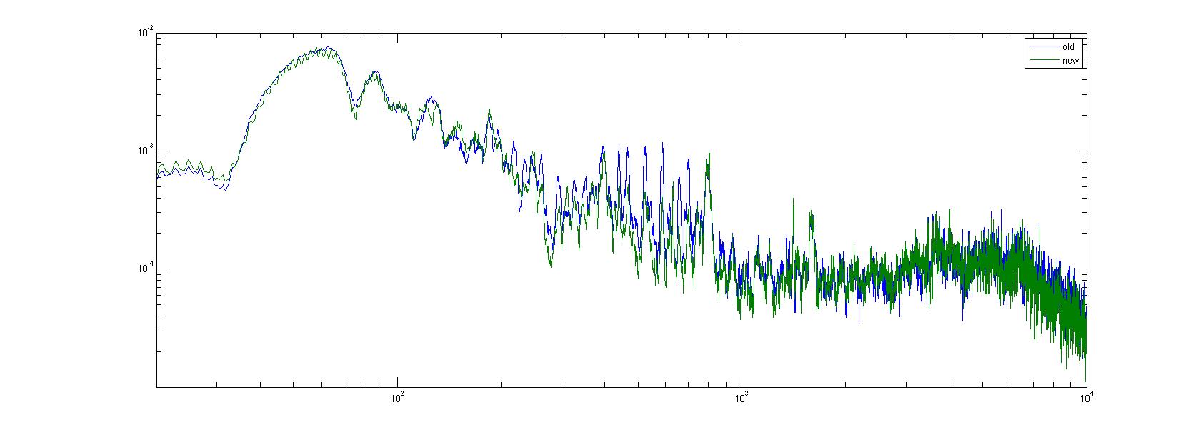

I still have not accessed internals to see how to improve caps, but i tested a new trafo. While the old ones have +/- 21.5V (no load) outs , new one have +/- 19.7V (no load) with a beefier 60VA rating.
Here it is FFT response of a short same audio snippets of house track i am working with, taken first with old trafo, then with the new one with very same desk setting (and room temp etc.)
I can hear a noticeable improvement on bass drum which sound tigher, maybe due to better response on midrange or less overall compression. Possible higher noise floor is not such a big deal since the music i used to work with.

The +-17volts is the same. Have you got an over furtive imagination ... how can there possibly be an 'tighter' sound.thank you for your suggestions Xoc1
