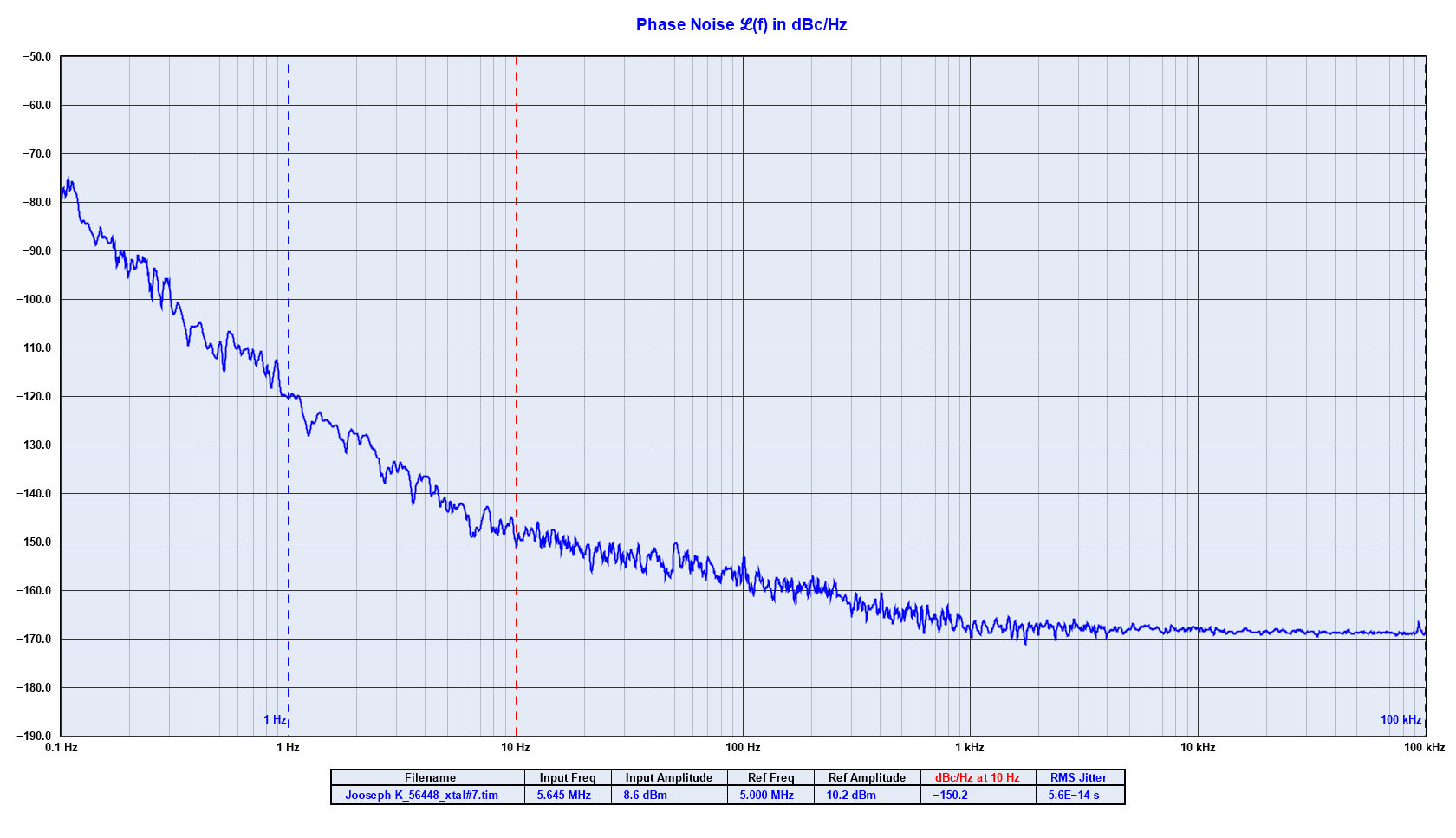

Seriously, you are so frustrated for designing such a poor oscillator that you climb the mirrors disputing the reliability of my measurements.
I attach the phase noise plot of the oscillator I have sent to George alias Joseph K.
He owns the suitable tool to repeat the measurement so he can validate mine.

Sorry Scott, I'm not sure I have understood correctly, do you think the Timepod 5330A (now Microsemi) cannot measure -150dBc at 10 Hz or -120dBc at 1 Hz from the carrier?

the oven does not matter, we have measured the same SC-Cut crystal oscillator with and without the ove and the short term stability did not change, the close in phase noise was exactly the same.
Of course, with the oven you also get a spectacular Allan deviation while without it the long term stability is poor.
But in audio we don't care about long term stability, unless you have to sync multiple time domains.

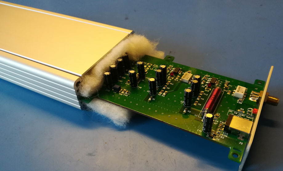

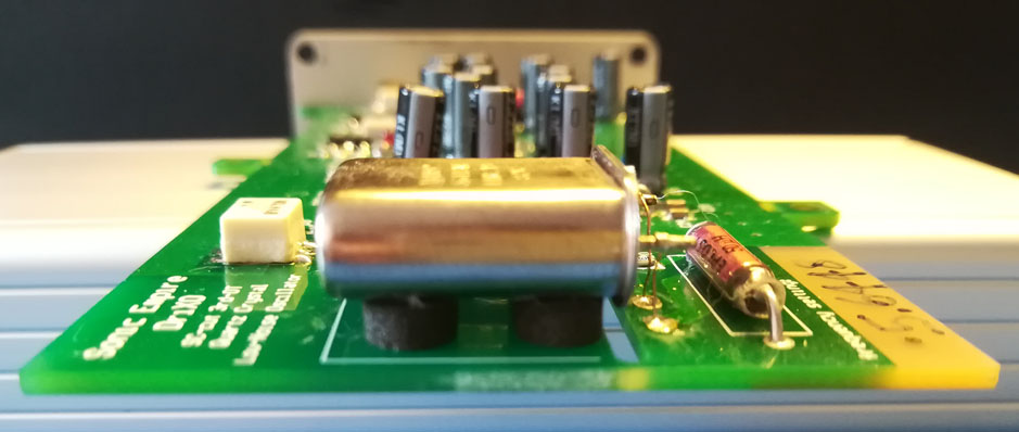

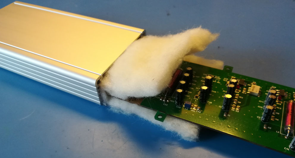

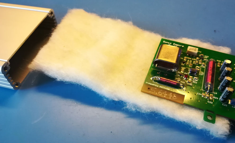

Back when I did a shootout between $1 oscillators, with my 50 cents phase noise rig, consisting of a NOR gate used as a mixer, putting a demakup cotton ball on the clock reduced low frequency phase noise substantially, by keeping it at a stable temperature. There was also a big difference in sound quality between these cheap clocks. The one with lowest jitter sounded best.
Indeed this is the way we install our oscillator inside the enclosure.
The crystal is placed on a pair of neoprene discs and its terminals are connected using thin copper wire.
This minimizes the close in phase noise.
