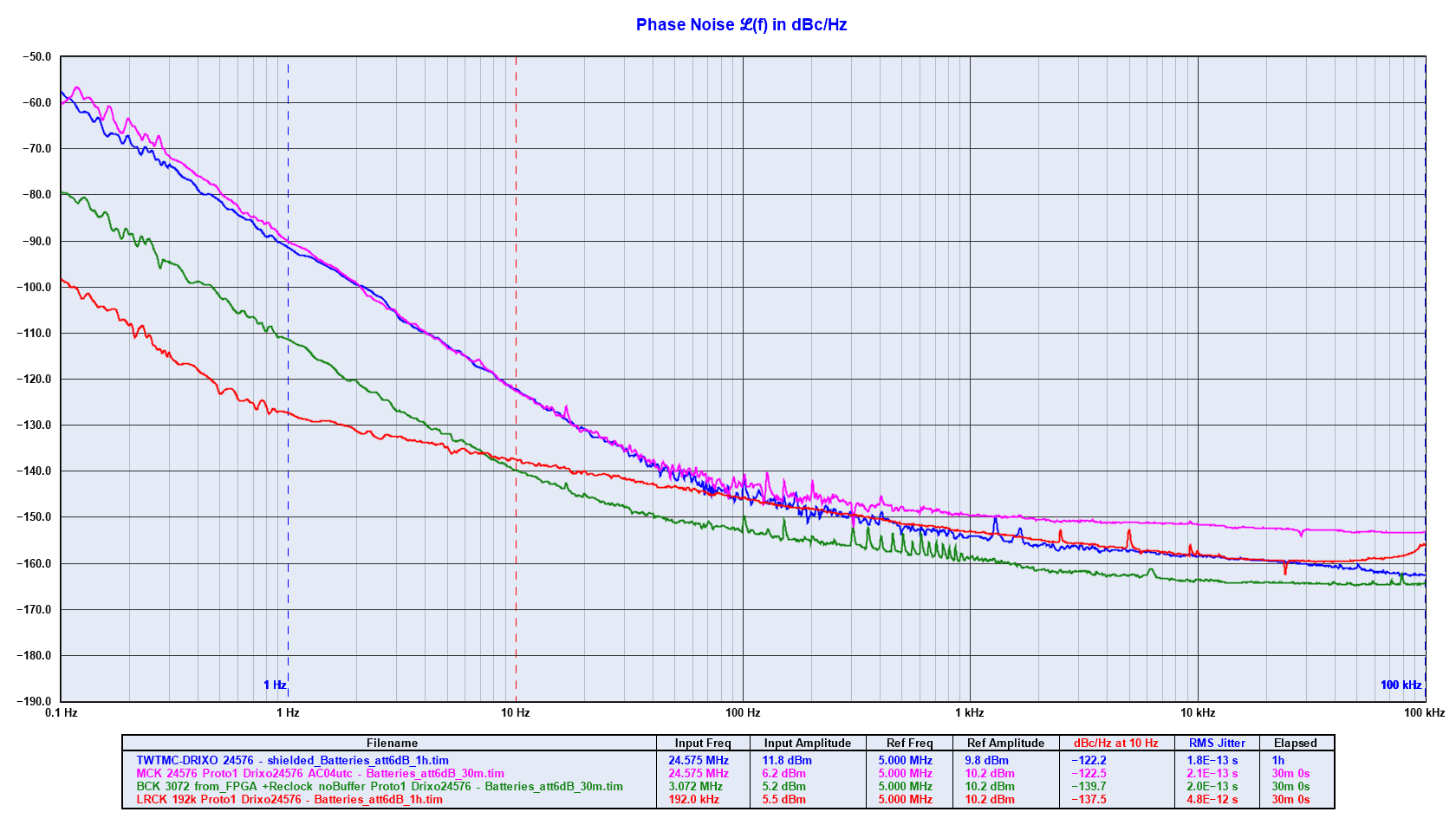

Then, since you will write the same thing again, now we are working on the digital front end, a FIFO buffer to be precise.
We are performing the same kind of measurements, we are measuring the phase noise of the I2S/PCM clock signals like BCK and LRCK, like in the attached plot.
If you believe we are performing the wrong measurement please let us know what measures we should perform.
After the digital front end we will work on the DAC, on the amplifier and on the speakers.

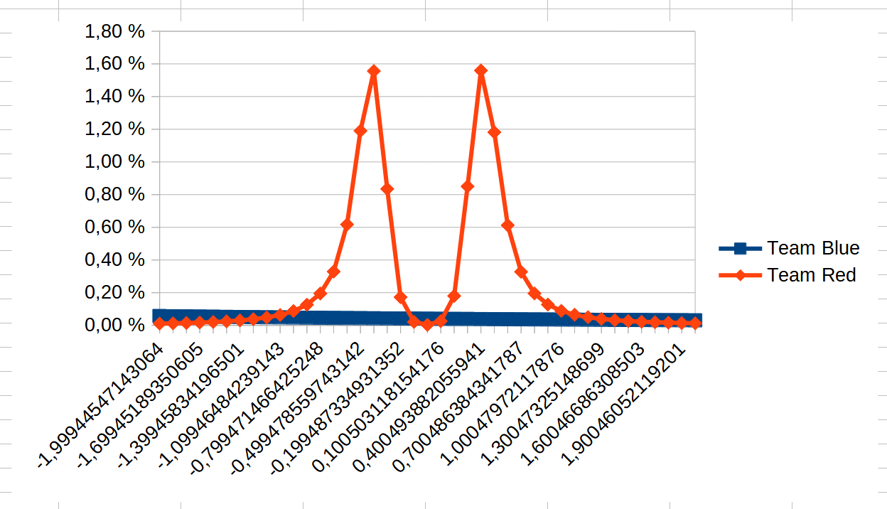

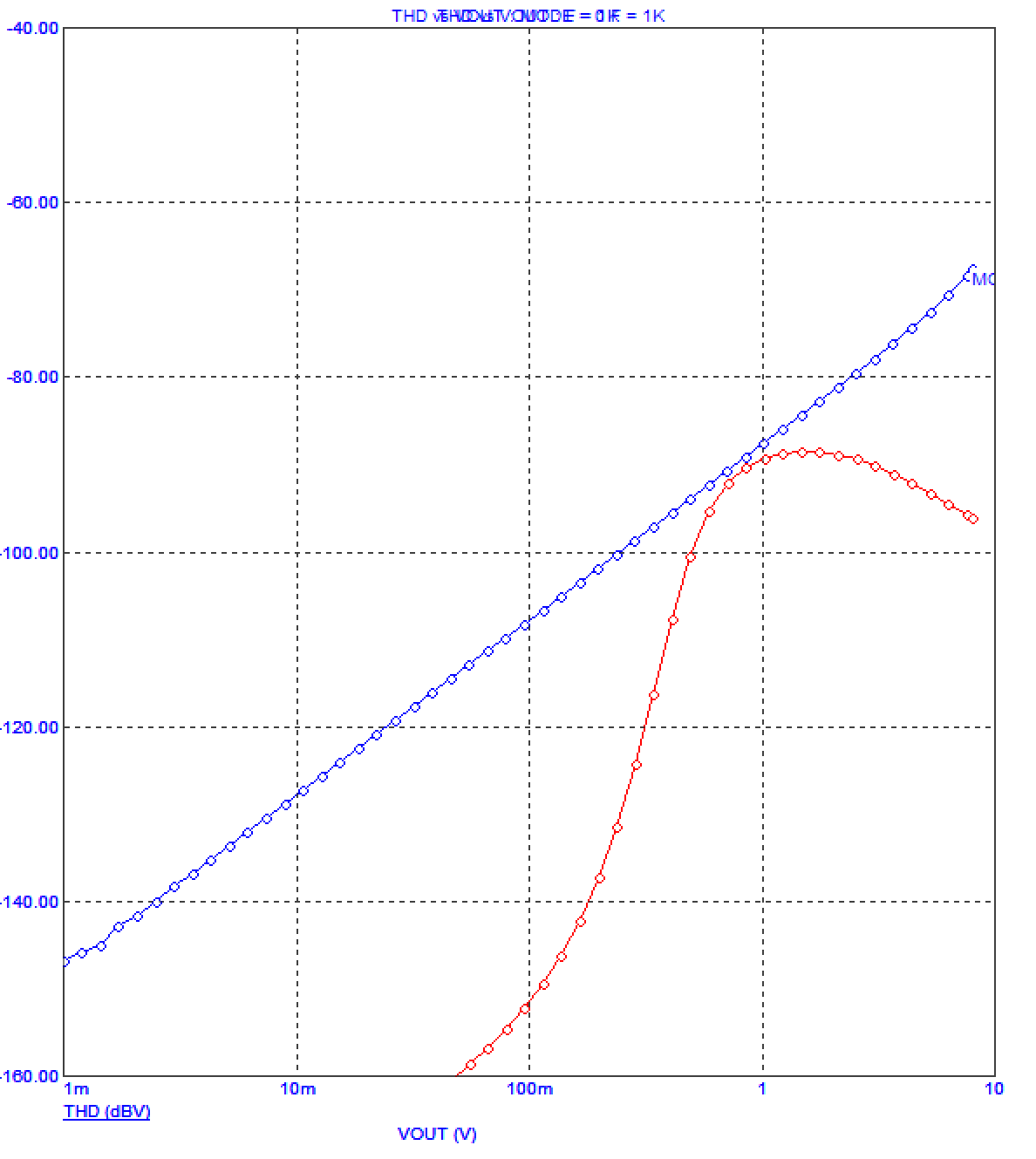

Damn, no-one took my little quiz. I'll add one more hint.
On THD vs output level, red circuit looks good...
Measuring THD vs DC offset gives a completely different picture.
I've never seen anyone do this measurement. Intermodulation is similar, but it does not reveal the circuit's problem in the same explicit way.
