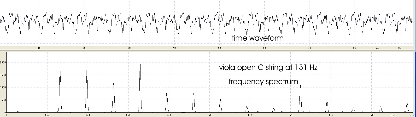

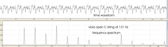

Wondering if noise modulation in high loop gain amplifiers is one problem. Attached below is the harmonic spectrum of one viola. Consider then the number of frequencies generated by a orchestra where instruments are never perfectly in tune with each other. There might be 10,000 distinct frequencies present at once. What if a slight signal-correlated change in noise is happening from each distinct frequency signal. The sum total of that dynamically changing noise may be what buries musical details in SOA measuring amplifiers. Why do I come up with this hard to believe conjecture? Because a modified Aragon 8008 revealed more musical details that Benchmark AHB2. That so, despite the Aragon having audibly more IMD. Something has to be wrong with our models of what is happening.
I don't claim to have all the answers at this point. I am just trying to consider possible physical explanations other than to assume that everything is explained by human hallucination. To my ears, AHB2 buries some musical details in some kind of noise. That seems like what might be happening when other people have described some low distortion circuits as loosing details, "some of the details just disappear." So they argue that feedback loses information. Maybe it just hides information. Not due to basic control theory of course, but real circuits are not ideal. The model in an engineer's head is only so good at representing the physical world.
