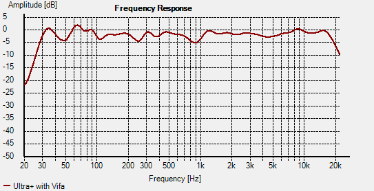

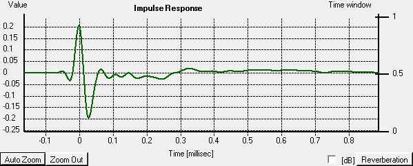

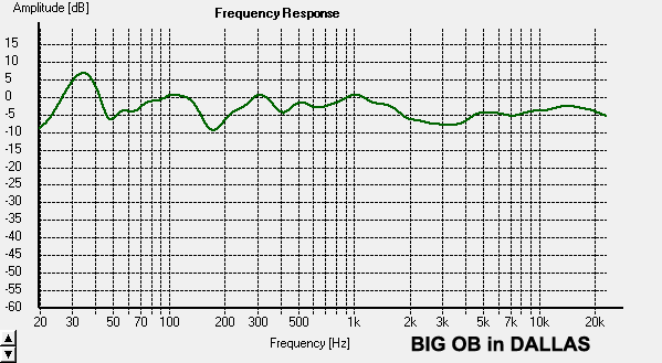

Below you'll see 2 FR charts from open baffle speakers. These are in-room at the listening position, real world. Not 1M near field anechoic. One is at an audio show, the other in my room at home, but different speakers. The 5dB drop above 1.5K is done on purpose for voicing. I ended up doing the same for mine when going passive - it works.
Pano, that looks pretty impressive and I would love to hear your home set, given that the audio show is probably over by now..

Pano, the in room response is now looking rather impressive, not at all like the first few graphs you posted.
One question - could you please list the drivers used and espeacially the size of the panel used to get that room response?

Thanks. But I didn't post anything before. 😉Pano, the in room response is now looking rather impressive, not at all like the first few graphs you posted.
The graph with the green line is: 2x18", 1x10", 1x dome tweeter.
The graph with the red line is: 2x15", 1X3" fulrange.
No EQ, other than the passive crossover itself. Acoustic crossover point from 18" woofers to mid is 200Hz, from 15" woofers to fullrange about 300Hz.
Baffle are approx 2 feet x 4 feet with shallow wings. A little bit bigger for the dual 18", IIRC.
A similar response can be had with a single woofer, tho efficiency and dynamics suffer. I also feel that 2 woofers per side sounds better, more at ease.
