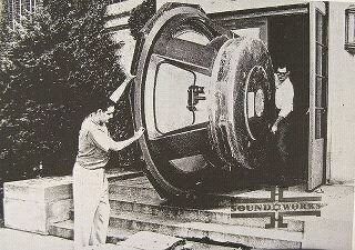

Mr Wayne has a point . 18 inch which is still cheap enough , is a baffle in it's own right . Love that photo .
