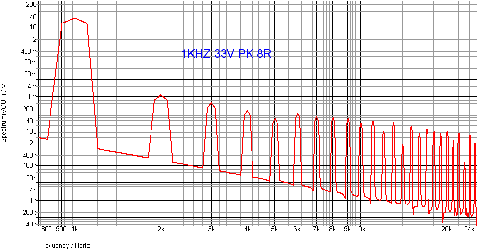

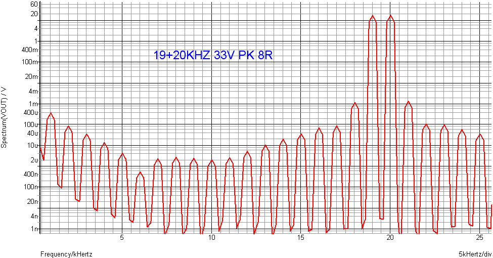

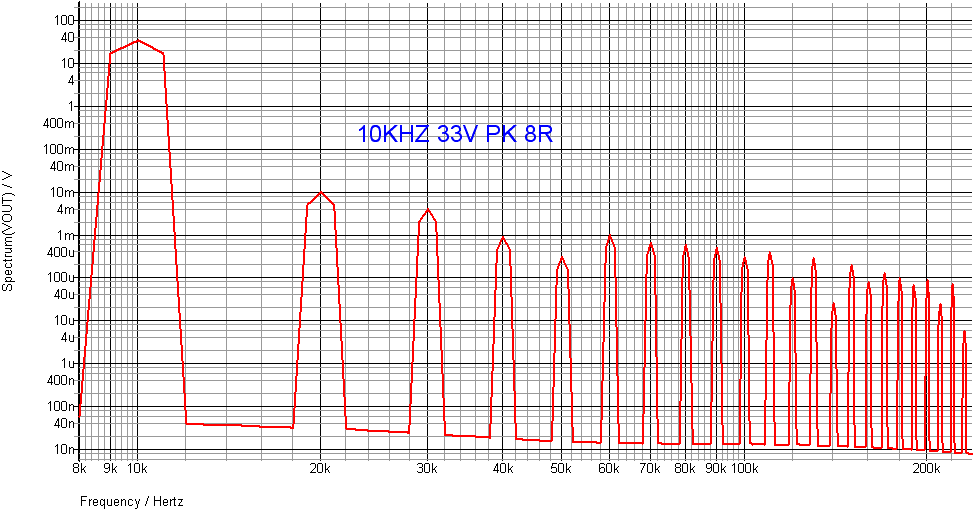

I m not talking of reducing degeneration and maximize the OLG
but to find the good balance between all theses parameters
to yield unconditionnal stability even with 2uF load , lower
possible THD and IMD as well as excellent harmonic distribution,
not counting better PSRR and DF..
As a clue , using your last schematic with almost no modification:

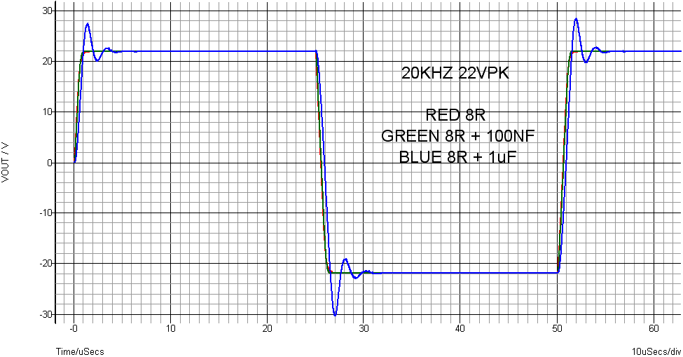

Wahab, the transient response plot you present looks good to me especially if the 1uF case is supposed to show stable but not necessarily optimal response. What criterion do you for phase margin when subjected to the extreme load capacitances?
-Antonio
-Antonio
First things i look for is sufficient phase/gain margin to drive highly
capacitive loads , at least 2uF or even more, unconditionnal stability
whatever the load being a plus.
Generaly used numbers are 26db and 90° , although 120° is better,
one never knows.
Of course this will translate in not so impressive perfs on the THD/IMD
as well as in the slew rate fronts , still , good enough numbers are
easy to obtain with very few components.
This will mandate either heavy degenerations or compensation or boths,
depending on the designs preferences.
Wahab, if I read it correctly, in your graph of say 1 kHz distortion, with a peak output of 40 V, the distortion is around 2 mV, or 86 dB down, or at 0.005%. This is "unrealized potential"?
This is the modded version simulation.
The schematic he published , if ever he manage to stabilize it
enough , will produce 20dB higher THD , not counting an erratic
behaviour on capacitive loads.
The main mistake is that a cascoded VAS cant be compensated
the way he wants to , as the VAS local loop ,comprising the common emitter
and common base VAS transistors, is so fast that the input stage is unable to transmit the signal derivative back to the VAS input , as its slowness will integrate the said signal and render any phase lead compensation unfonctionnal.

I m not talking of reducing degeneration and maximize the OLG but to find the good balance between all theses parameters
The basic amplifier will have a "build out network", actually, to be precise a tapped aircore inductor that will act as bidirectional 300KHz lowpass (a Ham Radio style one, not audio, mainly to protect the Amplifier from RFI ingress via the output), however I have not drawn that in, as I call it "housekeeping", together with overload protection, speaker protection and so on.
Seeing the 100nF curve I think the Amplifier is overcompensated as is, and I can loosen up the compensation, once the build out impedance / output filter are added.
lower possible THD and IMD as well as excellent harmonic distribution, not counting better PSRR and DF..
I a not interested in improving Total Hopless Disintegration, Interfaith Malarkey Disintegration or Duping Factor beyond what is shown. As I know how to design power supplies with low noise I do not necessarily view high Powah Supper Replication Reason as a desirable quality, however the Amplifier circuit as shown should do pretty horrorshow anyway.
Any of these parameters are already sufficiently past "good and bad" that any further improvements are meaningless.
The only thing that would interest me, is how to reduce upper harmonics more and/or how to keep the performance the design is capable of while removing looped feedback completely.
Almost no modification means "with modification". It would be polite to state what the modifications are.
Also, you may want to check your analysis parameters, those overly broadened spectral lines are an indication something is not horrorshow and you may have to align windowing, sample number and time-steps to get a clear view.
Past that -90dB H2 for 33V and 8R @ 1KHz (0.003%) look already way too good for my taste. The 0.03% for 33V and 8R @ 10KHz are still way good. It indicates an increase in negative loop feedback that is unwanted.
What I would lime to see is feedback lowered and adjusted so we get 0.1% H2 for 33V/8R with both 1KHz and 10KHz.
Of course, those are MY design goals.
Ciao T
I did mention before that I expect having to apply some Miller compensation. However I want to see what is possible with minmal Miller compensation.
The main mistake is that a cascoded VAS cant be compensated the way he wants to , as the VAS local loop ,comprising the common emitter and common base VAS transistors, is so fast that the input stage is unable to transmit the signal derivative back to the VAS input , as its slowness will integrate the said signal and render any phase lead compensation unfonctionnal.
Well, good thing we have some capacitive load on the VAS to slow it right down, so the IPS can keep up then, innit? Also, I doubt that the VAS is actually "faster" than the IPS.
As my Tina-Ti circuit has all "wrong" parts and parasitics play a great role in all of that I simply currently leave it at "stable 10KHz squarewave into 8Ohm".
Ciao T

First things i look for is sufficient phase/gain margin to drive highly capacitive loads, at least 2uF or even more...
one never knows.

Since you have a model it might be interesting to see the transient response with the lead capacitors removed.
-Antonio
pure uF capacitance without significant ESR is a silly test load - nearly nonexistant in the wild - ESL are driven thru step up xmfr with series leakage inductance, winding R that decouples the panel C from the amp way below frequencies that stability problems occur
typically the 1-100nF range is where actual stability problems with Cload occur - loudspeaker cable C usually lies in the lower decade of that range
