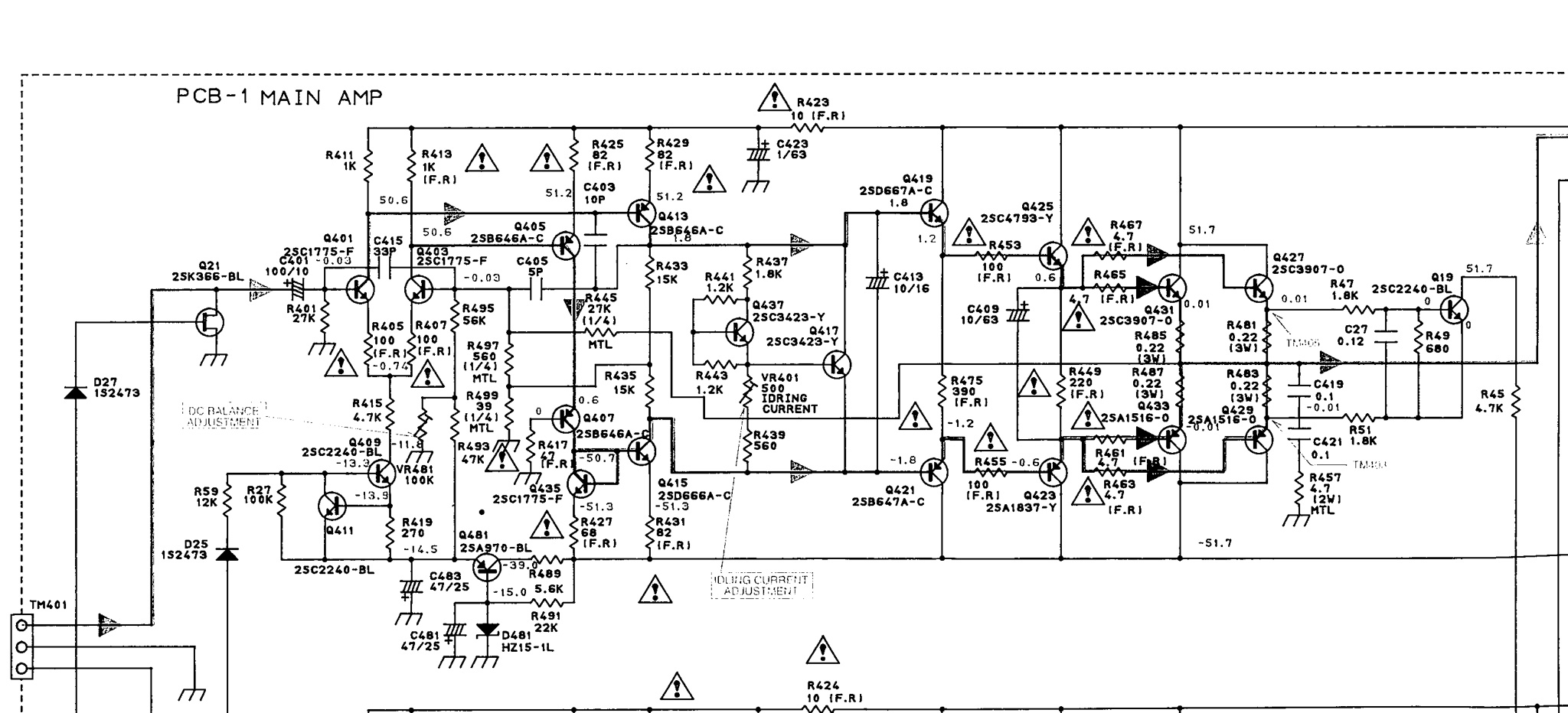

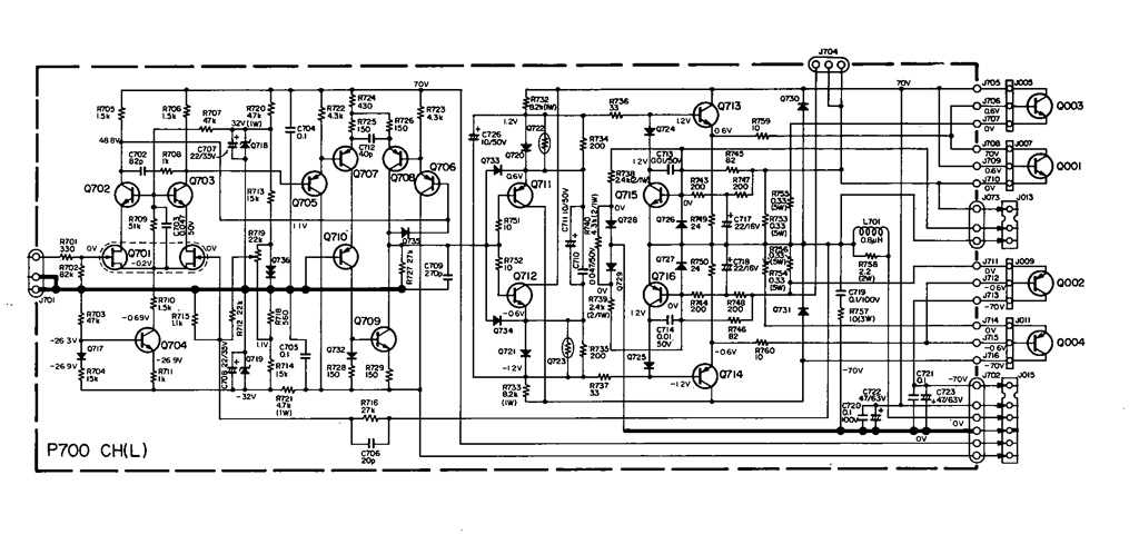

Thorsten, does the schematic of Harman/Kardon 870 power amp vaguely remind you of something?
The other is the power amp schematic of Marantz' 300 DC, a 2*150W power amp. It's exactly the same schematic as several of their other models (with different values, of course), including my integrated amps. Their sound I really love very much.
Marantz to the left, HK to the right.

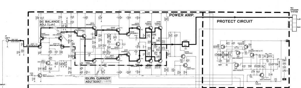

Theses schematics are generic of many japaneses brands as
JVC , Mitsubishi , Denon and so much others.
HK as well as Marantz were late to implement theses topologies
wich are indeed more seriously thought that the one a few post above.
Really? It may interest you to know that the Marantz schematic dates back to the first dates of production, January 1978.

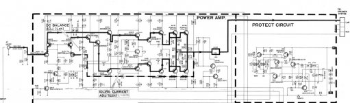

Wahab, can this work at all?
Look to be a functionnal amp , so i suppose that it works , indeed.
The output stage stability is implemented using the usual base resistors,
a somewhat brute approach but generaly quite efficient.

Besides , the input stage is not degenerated at all , surely an
other plus to improve stability.
There was obviously serious work done to get this stable. 3pF cap inside one of these big boxes can be achieved by moving a wire harness asside. The R/C step network in the Vas was certainly optimized with some experimentation (115pF?). That's a standard value for max range on trimmers.
Nothing more frustrating than putting your finger on a node and making a circuit behave perfectly and not being able to find a cap put anywhere that does the same thing. 😀
Indeed it does, and "it" is the Harman/Kardon 680 integrated amplifier, rated at 85/130W 8/4 Ohnms, using only 12 dB of global NFB.
I've had it for 13 years now, and can attest to its very lively sound. Compared to him, about half of its competitors sound positively dead.

They were the last series designed in the U.S.A. and manufactured in Japan, by what was later to become the one and only Marantz.
Wrong again on plural "subcontractors" - Marantz never had more than one, which was later renamed Marantz Japan Inc.
