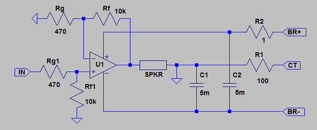

Tom,
Pro's :
Con's :
In fact I'm using something like a 24V/3W lamp for R1, that catches a couple of things well. Output snubber also goes to the neg rail. It can be used for multiple channels without effort.
The circuit is useful for insight on what decoupling really is about.
Basically it is a single supply amp, but the output cap is inside the feedback and is not charged to mid-supply through the load. The mid-supply reference is derived from and used at the back end of the amp, not the front end.
I'll try to post a full-blown example amp (P2P style) in the chip amps forum some time.
Pro's :
- Circuit input and output AC-referenced to the same point than the chip's internals, the negative rail.
- The remaining little ripple voltage on the opamp input vs reference is fully linear correlated to load current vs. a chopped copy + PSU ripple. And no PSU noise here.
- Supply and load ripple runs pretty much into the void on the positive rail, which has much better PSRR.
- DC-coupled, no output capacitor (as it INSIDE the full feedback).
- Also works with true single rail, with only little compromise (R1 mutates into half-supply resistor divider then).
Con's :
- Can't sustain long term DC or extremely LF signals or large chip voltage offsets, resulting in more than a few mA, otherwise the midpoint shifts (a voltage drop along R1) until balanced is restored -- well that's a pro as well, DC protection.
- Can't be used with speaker which don't have a DC path. Output saturates to a rail without a load connected.
- Need some protection, especially for power down, for both the speaker and chip. One diode from GND to chip PWR+ does the most important thing.
- Needs higher voltage caps, or series connected ones (with bleeders/stabilizers).

FWIW, see pic for my take on that neg-rail referenced super-CG, showing the concept. There are gotcha's, as usual.

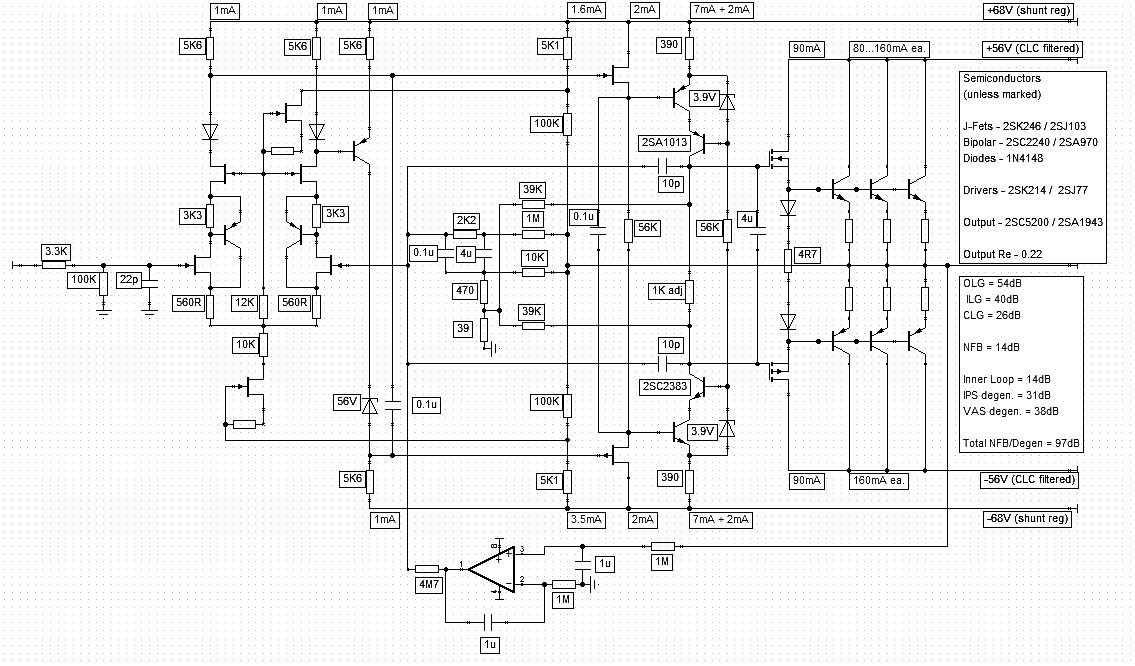

Folks,
So I posted and found the design simmed and criticised by others... I made some changes and got fed up with working in the "pen, paper, slipstick" domain.
I recently found the latest update of Tina-Ti included more devices and stuff, so rather then spending time in LTSpice, I assigned some moderately close devices found readily in Tina-Ti, to get a basic idea. Tina-Ti has various areas where results are either seriously funky, or their display is funky. It is necessary to discount/adjust for this. For example it's Fourier shows a "constant height grass" growing at higher harmonics if general HD is low, this seems a process artefact, as other simulators and reality beg to differ.
There are considerable differences between the modelled devices (which all seem to be 1960's/1970's devices - going as far as forcing me to use TIP33/34 as Outputs and IRF610/9610 as Drivers). So some devices ended up worse, others possibly better than what is on the page.
For example, the drivers in the Sim have way more Crss than the actual devices, but they have less than halve the output impedance too, the J-Fets have a touch more capacitance and transconductance.
So the simulation results should be taken "cum grano salis magnitudinem montis". I attach the current schematic, including the final DC nulling circuit (which combines very low gain servo and trick circuitry to get low offset and low sonic footprint).
Anyway, simming cascodes convinced me that even heavily degenerated VAS benefit from cascoding. The added complexity of cascoded VAS vs. Parallel VAS is modest. So Hawksford cascoded, J-Fet buffered push-pull VAS it is. That said, I'd not loose excessive sleep without cascode.
In fact, the circuit uses many features that are also shown to reduce circuit thermal memory, but as feedback is low, memory distortion is minimised anyway.
I did most of my investigation with 50KHz sines and squares, adding 10Khz and 1KHz tests for completeness.
I also simmed the same circuit as 16dB Gain line stage (see the High End Tone Control Thread to see what circuit that will drop in) as well. This means a joined shunt regulated +/-60V supply and no BJT outputs, just a pair of Fets.
Overall I am reasonably happy with the results.
The Linestage sims at < 0.001% THD (H2 dominant ~ 10dB+ above the rest) for around 12V / 50KHz into 10K//1nF load. I guess the sim is overly enthusiastic, given only 36dB NFB, or maybe not... I guess time to drop the open loop gain...
Other measurements are way past good or bad.
The Poweramp sims as 0.1% THD (H3 dominant) for 26V / 50KHz into 8Ohm with 14dB global NFB. For reference, the 1KHz result is around 0.03% (equal H2/H3) for 26V/8Ohm.
Anyway, these two observations illustrate that most of the distortion in the Poweramp derives from the output stage.
Additionally, with the filter on the input and the antique (1968) TIP33/34 in the output stage (with 3MHz Ft vs the more modern transistors with 30MHz Ft) the 50KHz square-wave suggests > 75V/uS slew rate, I suspect with much lower capacitance from the lateral driver Fet's and much higher FT for the output transistors the real HF distortion and slew rate will be much better.
Given the parts models used and the real parts that will be used I am quite happy with the simmed results.

FWIW, here my take on what to implement in a nice case, with a pair of 0.3K/W heatsinks and a 1200VA mains transformer...
PS, the attachment has not been build or tested (yet), but is intended to be implemented to some existing hardware, using existing PCB's and as many existing parts as possible, while getting something more to my liking.

Vincent's are no Krell , there maybe hell to pay thou , trying for good sound ..
...but as feedback is low, memory distortion is minimised anyway.
kinda at odds with every application of Bode Sensitivity analysis, feedback amp theory I've learned - thermal/memory distortion is best alleviated with high global feedback
only the common mode input diff pair power modulation is "outside" the feedback - and high global feedback reduces the diff signal pwr to uW making matching highly effective
still the bootstrapped cascode of the diff pair Q is a good idea to reduce amp input Z nonlinearity

Thermal memory presents an error signal that is outside the loop for the IPS (not just common mode) and can reach levels that are comparable to the IPS error signal with high levels of global looped feedback.
Local degeneration also acts against thermal memory distortion and with the same effectiveness, yet overall in the closed multi-state loop, any resultant impact of thermal memory is minimised as it becomes small next to error signal.
Ciao T
Ciao T
To the contrary , the more the NFB the less the instantaneous
linearity variations , among others the thermal variation dependant caracteristics.
There s a lot of stages in your amp, and this invariably
increase phase shift wich will mandate heavy degeneration to reduce
global transconductance , to a point that there will be no benefit
in pursuing this path.
Once you really understand this, you ll focus on improving
global linearity.....
Really. Closed loop - yes. Is that what matters most?
Actually, there are two gain stages in my Amp. All other (buffer) stages are included precisely to counteract bandwidth and linearity limitations, arising from non-ideal transistor behaviour.
So, they do not introduce phaseshift, they reduce it. It is called broad-banding a circuit, generally the lower the source impedance for a bipolar transistor the wider the bandwidth (and the lower the attendant phaseshift) and the lower the distortion.
First, the heavy degeneration is one of the main design "features", not a side-effect. Secondly, what benefits do you expect from persuing a different path (you may remember that there is zero proof that very low THD improves sound quality)?
I have not interest to improve what you call global linearity beyond certain minimal requirements. There is no evidence that doing so provides any tangible benefits.
Once you understand that you may be able to focus on things that actually matter.
Ciao T
To the contrary , the more the NFB the less the instantaneous linearity variations , among others the thermal variation dependant caracteristics.
There s a lot of stages in your amp, and this invariably increase phase shift
Once you really understand this, you ll focus on improving global linearity.....
Ciao T
Thorsten, thanks for posting this. I am trying to figure out how the DC servo works but I might not quite get it. The there is no DC feedback over the servo opamp, so that at DC it is open loop. Wouldn't it be better to limit it's DC-gain by placing a resistor in parallel to the cap? Or am I missing something,
vac
vac
The best to imagine the servo is to consider the capacitors first as resistors. In this case an inverting Op-Amp is in the Feedback loop of the servo and thus the servo is non-inverting. Any Voltage on the output of the inverting main amp is amplified by the Servo Op-Amp and then re-injected into the inverting input of the Op-Amp. This will oppose any change of the output voltage of the main amplifier.
Now we add the capacitors back.
Above a certain AC frequency, the capacitors will have a very low impedance, yet the DC resistance is basically infinity. So for DC the circuit of the amplifier has a gain of 1. For AC the gain is around 20.
As the input section does not use monolithic pairs and the input fets (as well as the VAS Buffers and driver laterals) are not necessarily matched, we still get potentially quite a bit of offset, especially given the amplifiers relatively low DC Gain (a little over 50dB). Hence the servo is added to null out this offset.
The fact that we inject the servo output through 4.7MOhm into the inverting input where the impedance to ground is around 470 Ohm (assuming the capacitors in the main amplifiers feedback network are shorted) means the output from the servo is attenuated by around 80dB. Another way to view this is to say that the signal from the servo passes through a first order 0.01Hz lowpass, with a Zero at around 16Hz, thus giving a PI regulator behaviour.
The servo itself is differential and has 0.16Hz cutoff. It means at 0.16Hz the gain of the circuit is only 3dB above unity and the input filter will attenuatre 3dB. So at 16Hz the servo itself will filter any signal from the main Amp by 40dB, so the AC on the servo output for a full 50V peak swing becomes 0.5V. This as remarked is then attenuated a further 80dB due to the way the servo signal is injected into the inverting input.
Meanwhile DC will be amplified by the full DC gain of our Op-Amp (OPA-627), that is by 120dB. The DC Gain for the injected signal is around 0.2, we we retain over 100dB DC Loop gain. This gain of the servo Amp charges the capacitor in the Servo Amp feedback progressively, while shifting the output of the Op-Amp, which in turn charges the capacitors in the Amplifiers feedback loop.
This in turn causes the DC voltage appearing on the output of the Amplifier to be reduced. Eventually the system will reach an equilibrium. As we are dealing with a total 2nd Order filter in a loop we have potential for instability, so I will have to do a sim for that to check.
Ciao T
Ciao T
Just one question, Thorsten.
In my experience, the "easiest" way to reduce overall distorion is to degenerate the input stage and to add output devices, so that the work is divided even more.
For the first point, you did it anyway, so that's that. For the second point, in view of your targeted power, why didn't you add another pair (or two) of the output devices? I mean, they are fairly cheap, readily available and time proven. It can't hurt, it may not reduce overall distortion by much, but it will offload the output stage even more and spread the heat dissipation to yet another two points, making your heat sink even more efficient.
Just wondering.
Just wondering.
