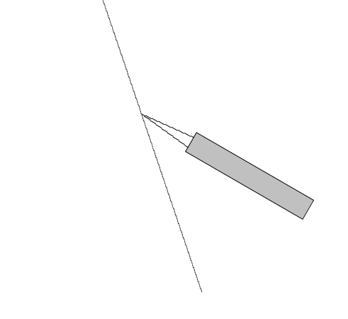

My procedure is to tilt the pcb at about 60 degrees, and with the tip shown below and reasonably hot, and the iron held as shown, and apply plenty of new solder to the top of the joint.
The excess solder flows down under the tip and can be lifted away and discarded.
I do this procedure at least twice to each joint to ensure flushing away of old solder, and good (perfect) tinning of both pad and lead.
This procedure wastes quite a lot of solder and plenty of flux is left behind, but I get perfect joints on old boards. (standard solder is cheap and the customer pays for it anyway).
Isopropyl and an art brush and tissue cleans up economically.
Oh, and I also clean the board before I start the resoldering.

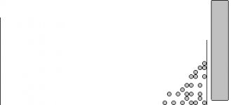

Solder Sponge Tip.....
Side on drawing of a diecast box, with a vertical panel slid down into slots, and the sponge mounted verically.
A couple of rubber feet glued under the far end ensures that water is present at the bottom of the sponge.
Twice a day I suirt a fine stream of water on the top of the sponge, and this trickles down through the sponge, taking flux & junk down, so the working top edge of the sponge is always clean.
The used solder collects in the bottom, and forms a porous lump of solder that can be removed easily and dumped into a container for selling to a metals recycler.
I have used this sponge setup for years and find it MUCH better than any other sponge setup I have used.
