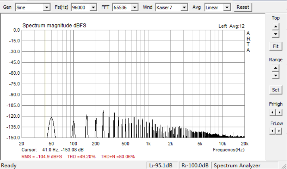

Hi Jan,
Thanks for your comment! I think I know why the waveform is triangle. It is the result of Cap charge/discharge time difference, the discharge time T =RC, where R is the load, is slower than charge time. Please correct me if this is not correct.
Also I poked around with some trouble shooting, and I found this. I disabled the XD circuit which draws quit some power, now the amp works like a normal blameless circuit. The bias is still at 26mv Vre, and the power comsumption is now 210W. I got this FFT chart on the compuer with nothing attached at idle:

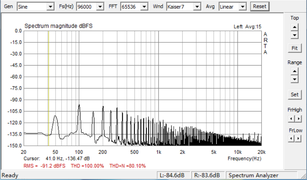

With nothing changed, when I just put the scope probe on the positive rail, I got this on the compuer FFT chart:
attachment.php
Obvirously, the PSRR of my amp is not good at all, right? The noise were injected throught the ground, right?

In case you don't use the card's output, your case is much easier 🙂
Anyway, pay attention to the way your standalone waveform generator's ground is connected. Test / calibrate the measurement system first with no amplifier connected.
