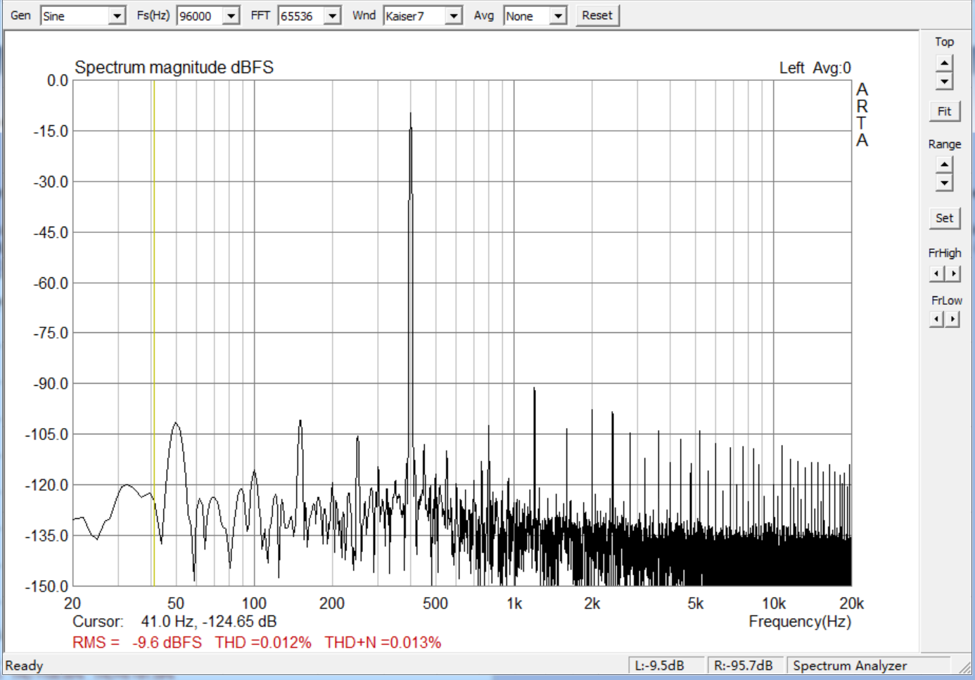

Hi Richard,

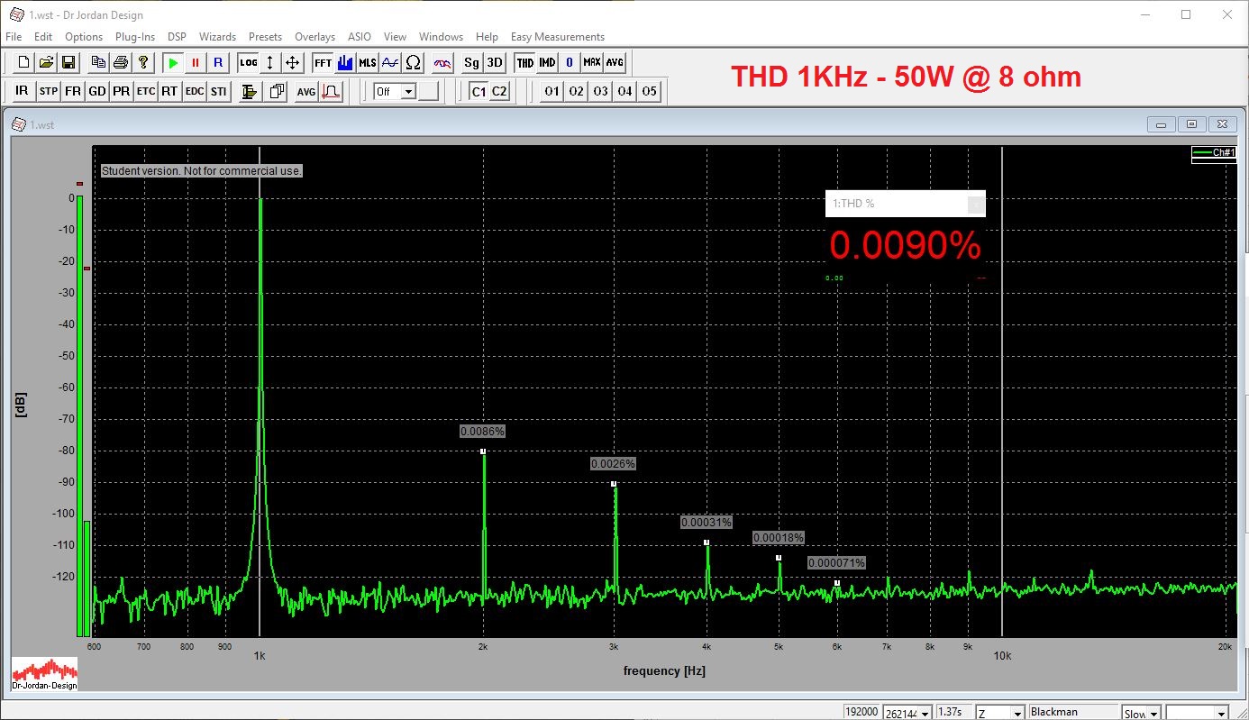

First you need to set the 0dB reference right. The FFT chart done by Stereophile is set at 0dBr=2.83Vrms. With the 0dB level the same, we can compare main's harmonic component directly.

Sorry, false alarm! This is just due to the ground loop. I'm buying an isolation transformer...

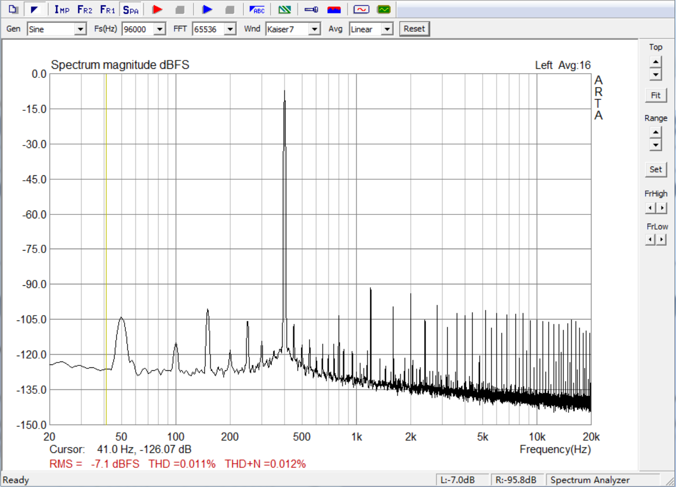

Hi Jan,
I know I have to make the ground right in order to make whole thing work along with all other equipments, otherwise, this is just a peice of junk. But the transformer will make my life easier when doing the trouble shooting. After all, I just don't have much experience in the ground loop thing, a lot to learn.
Also, I think I know exactly what is wrong in my build. I just powered the amp up using a pair of batteries and all the hamonics are gone. I followed the tips Mr. Self mentioned in his book when laying the board, but I think I just not fully understood why. I need to digest some more books and articles before I can make this right.

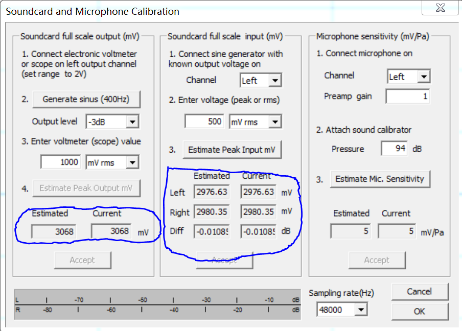

Got it, I'll try to isolate the computer using the isolation transformer.
The sound card is ASUS Xonar STX, which is a PCI-E card. No balance input and output.

I have mentioned grounding and showed the right approach in Post #22 😉
Transformer is not really required if no ground loop arranged (your measurement system is connected to the amplifier at a single point).

Thanks, and I do read your post 3 times, but that is not my case. I only have input to my sound card, and the output is not utilized. I think the groud loop is caused by the earth connection on the mains.

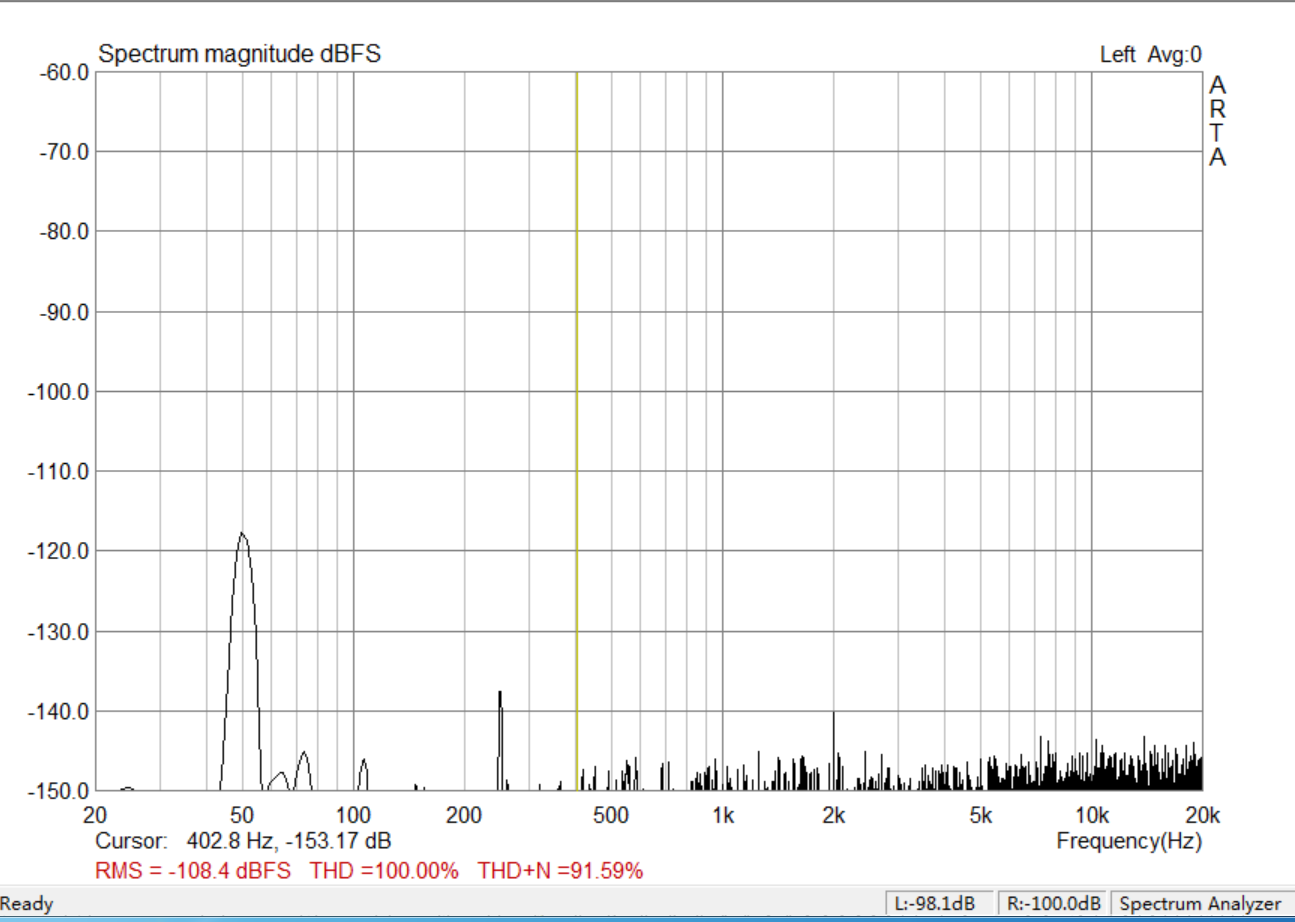

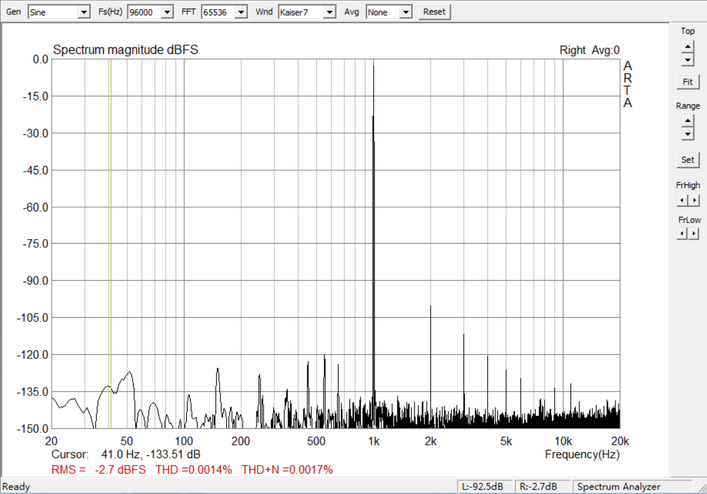

Also I poked around with some trouble shooting, and I found this. I disabled the XD circuit which draws quit some power, now the amp works like a normal blameless circuit. The bias is still at 26mv Vre, and the power comsumption is now 210W. I got this FFT chart on the compuer with nothing attached at idle:

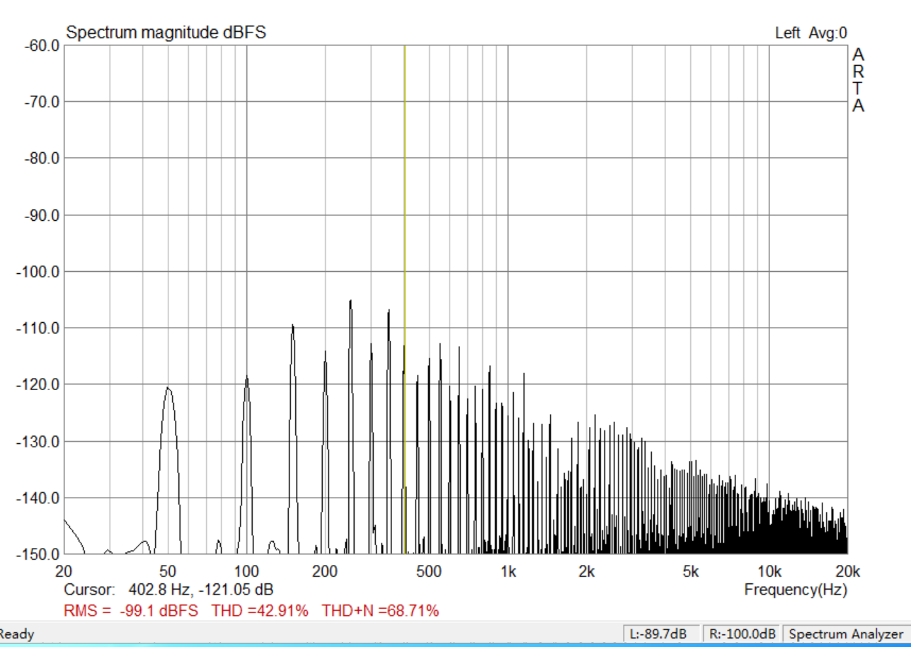

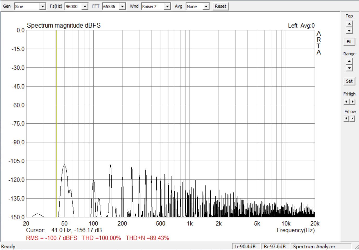

With nothing changed, when I just put the scope probe on the positive rail, I got this on the compuer FFT chart:
Obvirously, the PSRR of my amp is not good at all, right? The noise were injected throught the ground, right?

In case you don't use the card's output, your case is much easier 🙂
Anyway, pay attention to the way your standalone waveform generator's ground is connected. Test / calibrate the measurement system first with no amplifier connected.

(below) is the real "baseline" for a typical "blameless" (with either TPC or TMC)
.... transitional 2 pole feedback compensation.
The amp has input pair noise dominant at low output but drops to <10ppm -100W (2-below).
If you are short of this , it is either layout or the shortcomings of the testing rig.
PS - this was a true test on a 2700 series AP. The forums "Honeybadger" is
pretty much the same circuit as the test amp (EF2 + blameless).
I'm sure a (EF3 +blameless) or Vzaichenko's non-switching EF would halve
these AP tests - especially with more load/wattage.
OS
