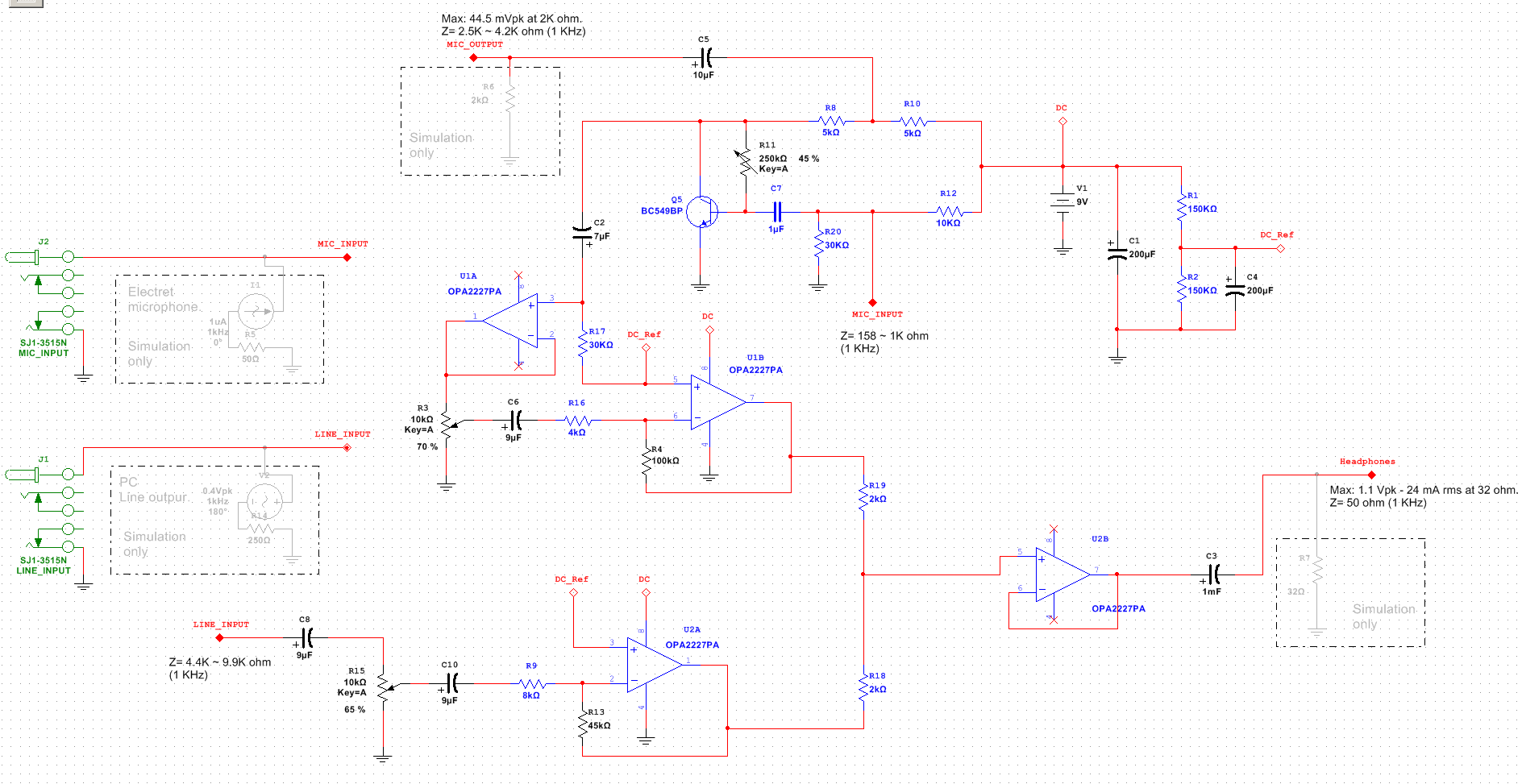

GOAL:
To build a circuit with 2 functions:
+ Pre-Amplifier of electret microphones with output to the PC's microphone input.
+ Mixing and Amplifying of the PC's line output plus the microphones' signal, and sending them to a 32 ohms Headphones.
CHARACTERISTICS:
  1. Preamplifier's output of about 20 mVpk (40 max) to be adjusted at setup time.
  2. Mixer/Headphones amplifier's output of about 1 Vpk, by a load of 32 ohms.
    (Actually, I'd wish to be able to connect 2 headphones, eventually, so I'm thinking of putting 2 jacks connectors in series to avoid the voltage dropping).
  3. I don't care whether the initial adjustment of the trimmer R11 affects the amplitude of the input to the mixer/amplifier. What I must avoid is that the adjustment of the volume potentiometers (R3,R15) affects the microphone's output. Due to that, I must isolate these two stages by means of a Buffer (U1A).
  4. Although I don't want bad sound in the headphones, the HIGHEST priority of the circuit is the good output of the microphones to the PC's sound card, for recording. Here I need the best amplification with the minimum noise.
  5. I must avoid to a maximum the cross-feed between the 2 channels of the microphones, because the main reason for building this circuit is to replace the horrible recording/monitoring features of my new motherboard's sound card in an application for directional localization of sounds. For the same reason, I should also avoid the cross-feeding between the two output channels to the headphones while I am monitoring or listening to the recorded audio.
DESCRIPTION:
  1. The circuit is split into two stages. The first one is an electret microphone Pre-Amplifier with the output MIC_OUTPUT (top of the diagram). The second stage is a Mixer/Amplifier of the first stage and the line input LINE_INPUT, for driving a 32 ohms Headphone.
  2. The circuit will be fed by an external power supply of +9V. For simplicity, instead of using a supply splitter (virtual ground) for the op-amps, I'm using a Reference-Voltage of 4.5V.
  3. In order to keep the amplified noise to a minimum, for the first stage I'm using a transistor instead of an op-amp.
  4. To isolate the impedance between stages, I'm using one half of the op-amp (U1A) as a Buffer.
  5. To be able to present a low impedance to the low load of the headphones, I'm also using one half of another op-amp (U2B) as an output buffer.
  6. In the first stage, R20 keeps under 7V the voltage applied to the electret microphone (the maximun uses to be 10V in most of the datasheets I've read).
  7. To simulate the electret microphone, I'm using an AC Current signal generator of 1uA and to simulate the sound card's line output I'm using a AC Voltage signal generator of 0.4V.
  8. The variable resistor (trimmer) R11 is soldered to the PCB and will be used to adjust the microphones' sensibility at setup time. After that, it will remain fixed.
  9. The Volume potentiometers R3 and R15 are dual audio-logarithmics, external to the PCB. Maybe I'll replace them by linear ones with a resistor, in order to simulate the exponential curve.
  10. For simplicity, I'm not using neither an active mixer nor a panner to mix the microphone and the line outputs. I could add, instead, a global volume by means of a potentiometer to ground, just before the output buffer.

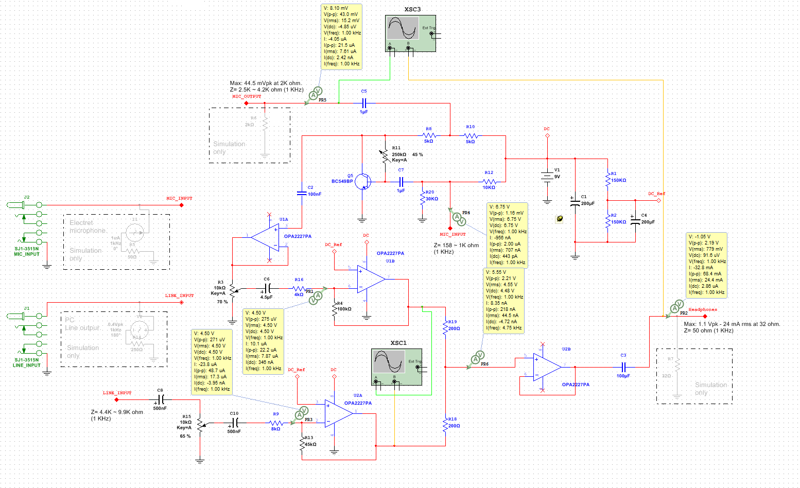

  11. With the same configuration as in the image, I'm getting in the simulation values of 21 mVpk at the microphone output and 1.1 Vpk (24 mA rms) at the headphones output.
  12. The circuit depicts a single channel. Both channels will share the same power supply but no any other element, save the dual volume potentiometers (R3,R15) and the stereo jacks.
  13. Still to be implemented, there will be a Led and a Switch between the power supply and the circuit.
DOUBTS:
  1. Will it even work?
  2. What are the correct values for the resistors (R1,R2) and capacitors (C1,C4) at the Reference-Voltage output? ¿May they be electrolytic ones or should they be Film (polyester) ones? I haven't found any examples for voltage reference, but for supply splitters only.
  3. If I simulate the electret microphone with an AC Current source, everything is fine but if I simulate it with a JFET transistor, all the signals drop near to ground. Why?
  4. At the Microphone output and at the Headphones output, I'm putting resistors (R6,R7) in order to simulate the impedance of the sound card and the headphones. Although all those external elements will be connected most of the time, should I put some real resistors there, in case some of those elements are disconnected from the circuit? May be 5K and 500 ohms resistors?
    In the case of the headphones, it's really simple because I can put a 32 ohms resistor between the detection pins of the jack connector. But the output from the microphone preamplifier will be a soldered cable, in order to minimize noise.
  5. To avoid the crossfeeding between the 2 channels of the microphones, I'm avoiding the use of the same dual op-amp for different channels. So, the buffer at the end of the preamplifier and the main microphone amplifier are both one half of the same op-amp (U1A, U1B). There will be any problem for doing the same with the line amplifier and the buffer to the headphones (U2A, U2B)? Would it be better to use the same op-amp for both amplifiers and the same op-amp for both buffers?
  6. The capacitors C5,C6,C8,C10, should they be electrolytic, film type, or ceramic ones (at least for C5)?
Thank you, very much.
I have attached some screenshots and a zip file with the whole project (Spice netlist, images and the circuit file for MultiSim). The oscilloscopes image shows the final output signals (DC coupled) and the op-amps outputs before being mixed (DC coupled, shifted -4.5V).

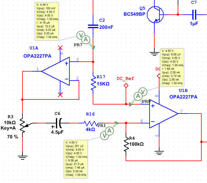

Humm. I think I'm watching a big mistake here.
The first buffer (U1A) is AC coupled to the preamp by C2 but, because the power supply in not giving negative voltages, this op-amp should be clipping the output signal. But it's not! The simulation depicts a shift of aprox. +1 volt DC in the input and, because of that, it is working.
Is it possible or Is this a bug in the simulator?
Shouldn't I feed the non-inverting input of U1A with DC_Ref too?

Where are the other inputs to the opamps connected ... I see "DC_Ref" which is a voltage divider and filter that bisects the power supply... correctly biasing the inputs to the chips.
Well. I think I have now correctly biased the Buffer U1A.
  • I have connected its non-inverting input to DC_REF (+4.5V) through R17.
  • I had to increase C2 value to 200nf for a good response at 100Hz.
  • Output signals keep almost the same.
Have I done it right?

Since you are still in simulations you should toy with the value of R17. You might find that a higher value (47k?) will give you better frequency response without a big increase in noise.
Also looking at your first schematics... I would increase c8 and c10 substantially, unless you deliberately want it to lack bass response on the line input. Try 10uf. To get reliable 20 to 20k response you want your low frequency roll offs to start at about 5hz or so.
Yes, thank you Steve. I'm aware of such limits of the simulation. That's why I don't trust when it says that my circuit works fine. So long, the numbers for the capacitors that Douglas gave me are working well but I need to adjust some others, because I was doing the simulation for 100 Hz as the minimum and I see that all the signals drops dramatically when I go below of that.
My comments: Biasing a transistor like that is bad practice - transistor gain is not a well behaved parameter, you should not be relying on it. Use a resistor-divider to bias the base voltage and emitter degeneration to set the standing current and the gain. A low-noise transistor is the best choice here.
The summing point is via 200 ohm resistors, meaning the two opamps are each driving a low impedance reactive load - change those to 2k resistors to avoid overloading the opamps.
And lastly I can't help feeling that there are more opamps than needed.
Thank you, Mark.
I've changed the resistors at the summing point.
I'm still tuning the capacitors. Signals are decaying a bit.
I think I understand what you mean about the transistor. I didn't know that. But I don't know whether I know how to do it. I'll do a bit more research about this.

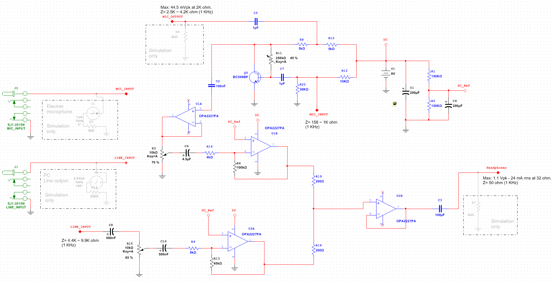

Modifications 02 - Capacitors and Resistors values.
These are the changes made to the values of some capacitors and resistors, following your advices:
The value of these capacitors were drastically increased, to minimize the cut-off at 20Hz:
C2, C3, C5, C6, C8, C10
All of them are now polarized (electrolytic or film types?).
The values of these resistors, at the mixing point, were drastically increased, to not overload the op-amps:
R18 and R19

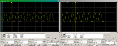

Signals at the outputs remain the same above 1KHz but are drastically improved in the range of 20 to 100Hz.
I'm still studying the advices from Mark Tillotson about the biasing of the transistor.
But it's past time to go to bed here, in the Canaries...
Attached you have the new images and circuit files.

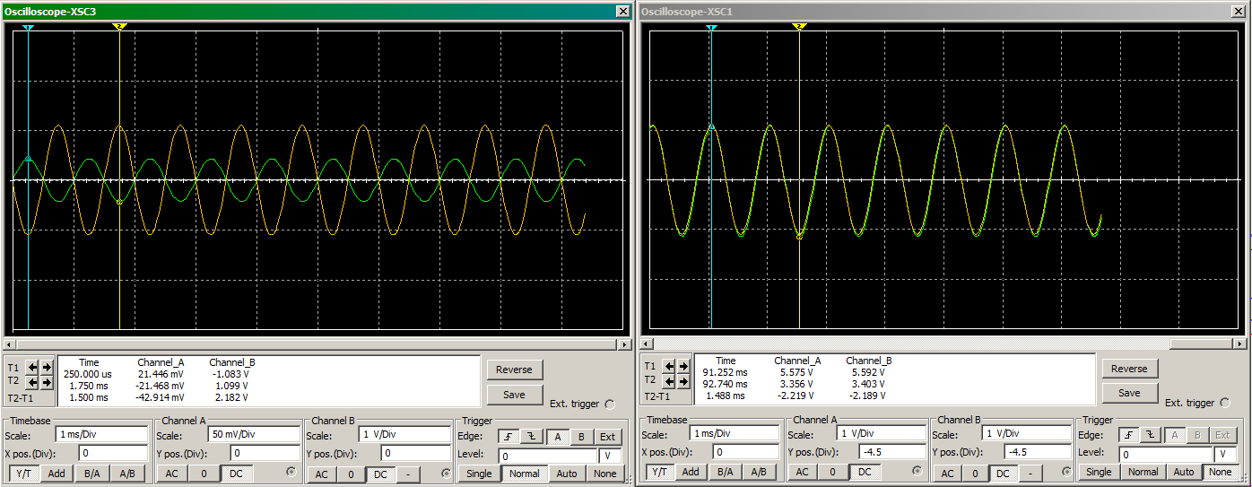

But, when you go that low in frequency you let the signal to drop a bit, don't you? I mean, to drop a 10 or 15 percent? I had to change almost all the capacitors and some resistors after your replay and can't avoid the signal to drop a bit, running the simulation at 20Hz.
Does your software allow you to do FFT (spectrum) analysis? Simulating at a single frequency is seldom very revealing. if it doesn't you should look into new simulation software ... I use LTSpice which is free.
Capacitors roll off at about 6db per octave so if you are seeing a drop in response at 20hz it has probably started at 40hz (one octave up). This is why we design for 5hz or less. If we are down 6db or less at 5hz we will be at full output by 20hz.

Thank you for the smart trick and its explanation.
Regarding the FFT analysis, yes it has this feature but I've been there for one hour, trying to figure out how to set it up and it's being hard. I think I will still doing it by analyzing at the low end and middle frequencies until I learn how to use it.
