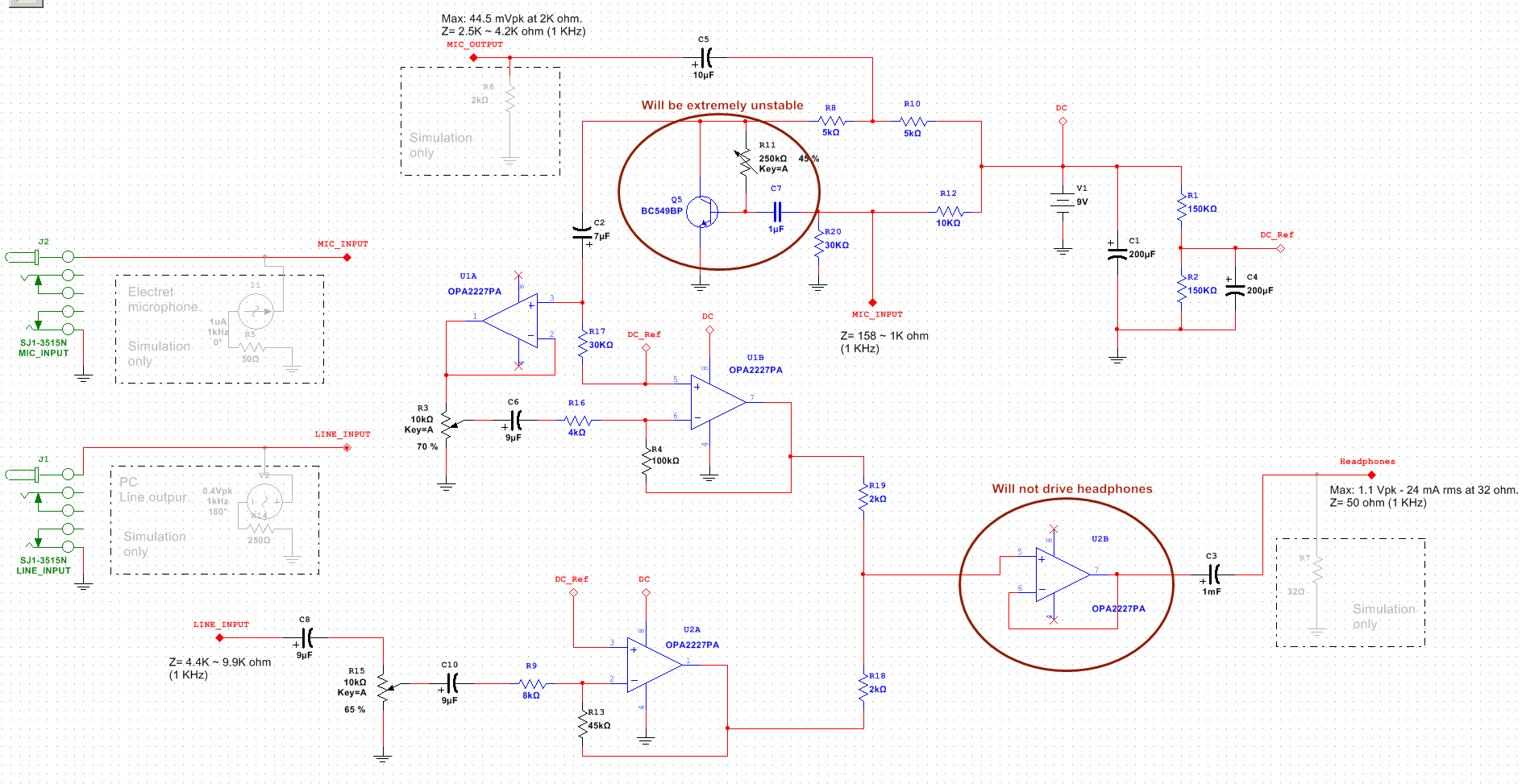

Sorry, Douglas; it seems I didn't explain myself correctly. What I mean is that If I don't let the computer and start soldering/testing/readjusting, having it physically in my hands but only in a simulator, I will let it go and buy some sound box. I will go crazy with only ideas and diagrams and not having a solder in my hands. I think you can understand me now.
Regarding the computers, I was born almos 60 years ago with a solder in one hand and a nanocomputer in the other (my mother and my father worked in Philips when they met each other). But I chose the nanocomputer instead of following my father steps, and I gave away the solder.
What I mean is that I'm not abandoning the electronics and I'll continue with baby steps on it forever, but, as you can imagine, I am sick of computers and simulators and need to go to the breadboard just now. So that, I have imposed myself a time limit to start building/testing. It expires on Monday. I hope not to burn my house when I connect the circuit, but I expect to only hear cracks and hisses when I do it.

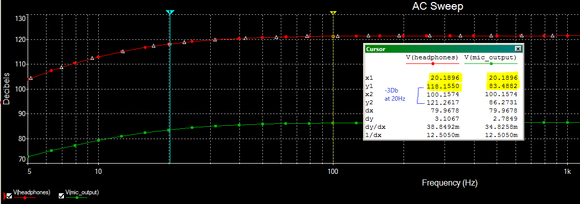

Regarding your notes about computer sound cards, you are very right but, trust me, everything has been tried out so far. The circuit is for personal use. What makes me crazy is the software thing. Too much thinking, not fighting (I think this is from Far Cry 5).
This is the result of an AC Sweep: only -3db at 20Hz. It's not too bad, is it?

Sorry to say but ... Impatience is not a good way to design a circuit.

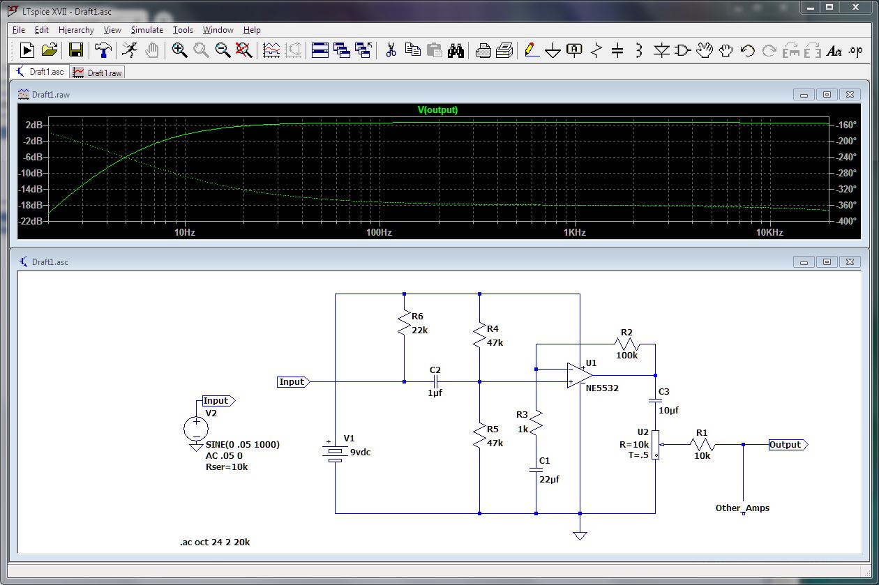

I'm taking from this that you want a dual microphone with stereo line input mixer ... Ok, that's not terribly complex... The attached thumbnail shows a very basic microphone preamplifier.
The input is for a medium sensitivity Condenser mic. For a Dynamic Mic, remove R6. The output is line level.
Gang 4 of these up and you have a 4 channel mixer.
The gain is set by the ratio of r2 and r3, reducing r2 reduces the gain.
So for a line level input you probably want more or less unity gain so set r2 at 2.2k and remove r6.
The headphone amplifier needs a little horsepower so you may want to look into a 1 watt amplifier chip for the task. Of course your parts arrangement will depend on the chip you choose.
