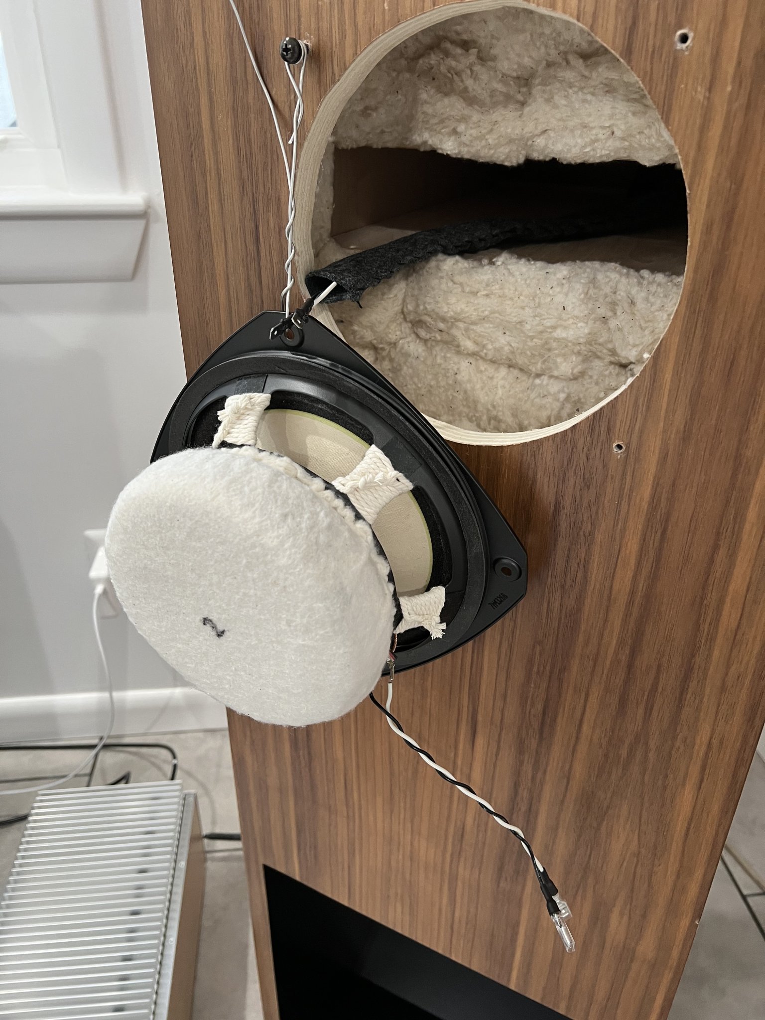

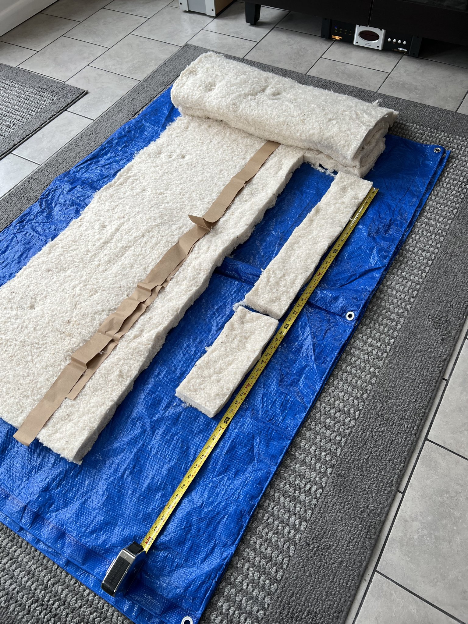

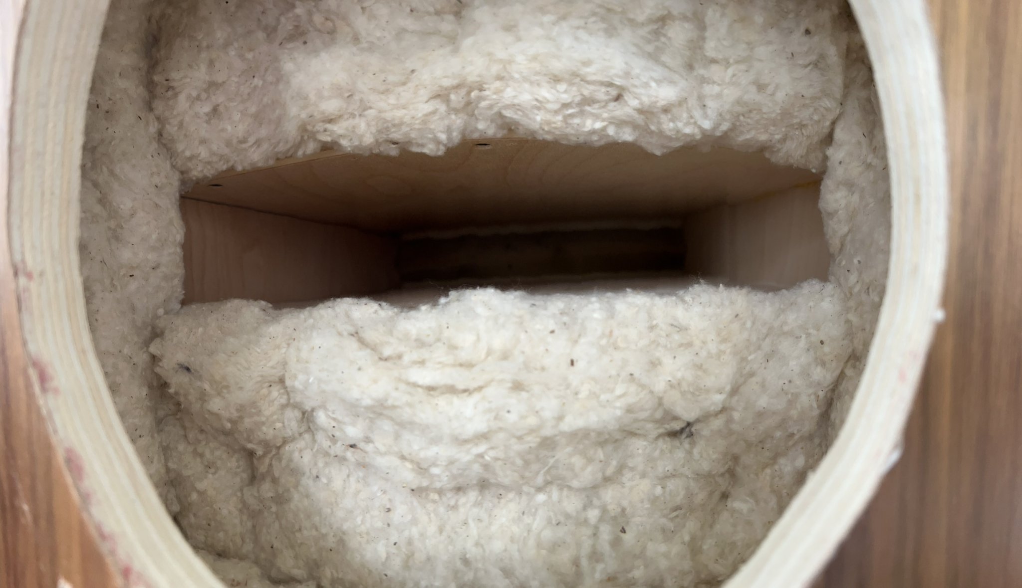

Well after spending another month listening to these speakers as they came, I finally pulled myself away from some other distractions.
I had ordered some thick raw cotton batting to try as a chamber liner. It was a much cheaper alternative to any of the wool options I came across.
It was a bit more delicate than I expected, but I managed to line the chambers and get a small stapler inside to tack it in place.
I also took a closer look at the wiring that had been done with the original drivers.
The soldering was pretty shoddy at the driver and binding posts so I decided to pull it out and replaced it with some surplus silver plated mil-spec wire I had on hand and then cleaned it up and properly insulated the connections.
I also wanted to be able to try different drivers more easily. I decided to add some insulated spade connectors to use with pigtails I added to the drivers temporarily to facilitate that.
I added a felt sleeve over them after twisting the wires to prevent any unwanted vibration as the new wire teflon insulation is a bit stiffer.
All in all things went pretty easily.
The roughly cut driver opening is a thorn in my OCD side, but I decided to leave it for now and possibly address it in the future if I decide to go back in and add a supra-baffle to try the 208EZ.

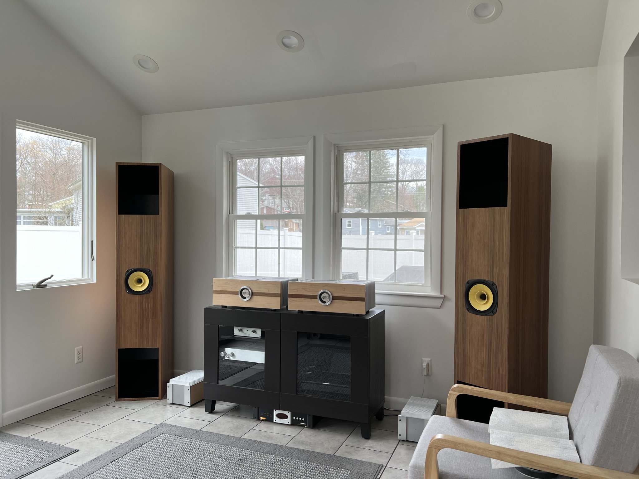

I immediately noticed a difference in the sound of the speaker.
It seemed as if it was a bit muted. I was comparing one speaker as it came to me and one I had finished the modifications on.
This morning I finished the second speaker and have been listening to different music all day on them.
It appears I also have to turn the volume up more to get to a satisfactory listening level.
My subjective opinion is that the combination of all the modifications I have done to the drivers and cabinets has suppressed much of the resonances and reflections they produced in the mid and high frequencies.
The changes seem to have improved the bass output and quality…or perhaps I am just noticing it more now due to the shift in sonics?
If had to come up with an adjective for the current sound of the speakers, I would say they seem smoother.
Previously they seemed to play louder and possibly with more air at a lower volume, but that came with shout and some other edgy qualities to the sound.
I’ll have to take a new room measurement to see what can be said about differences in the measured response.
