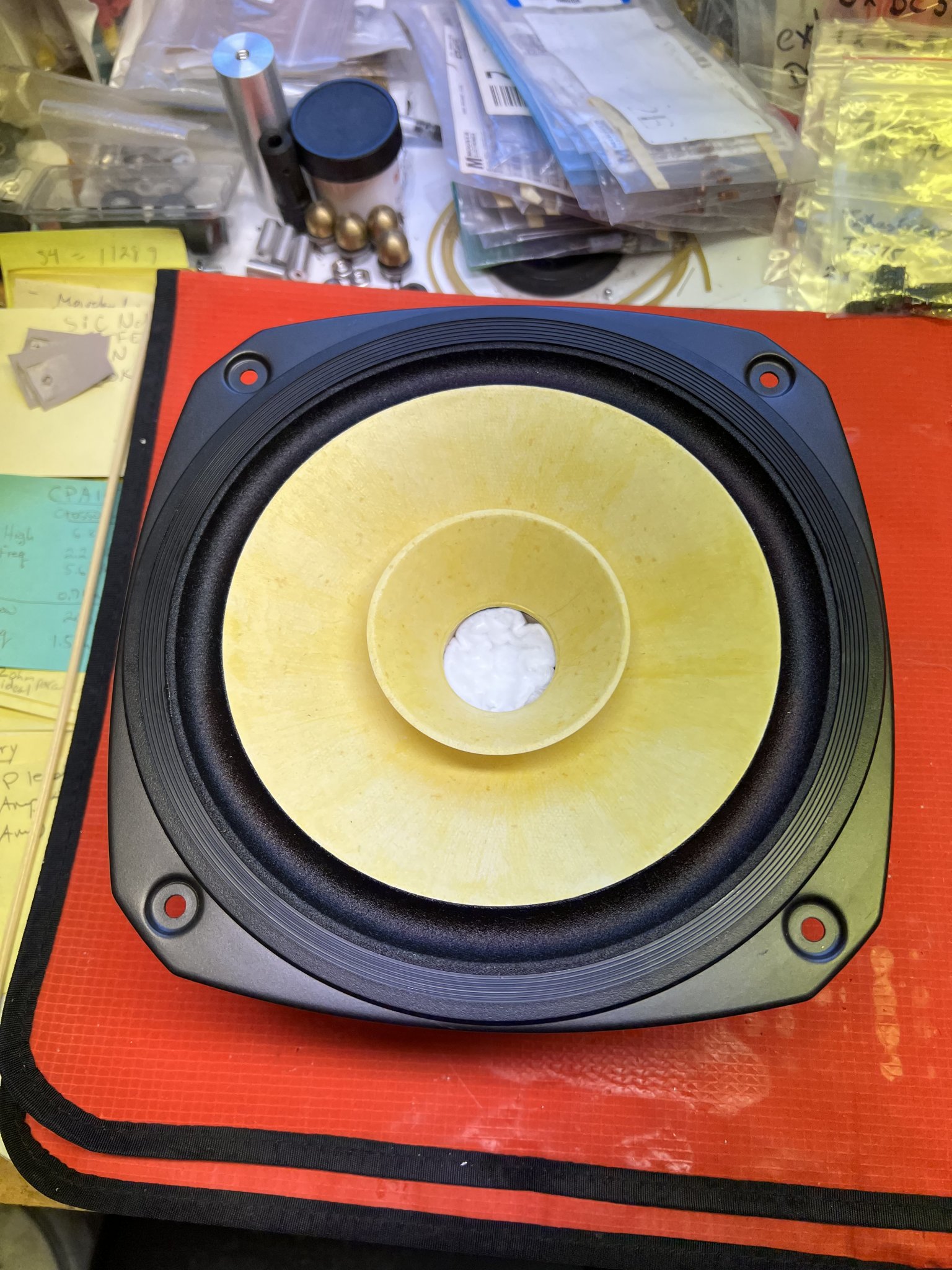

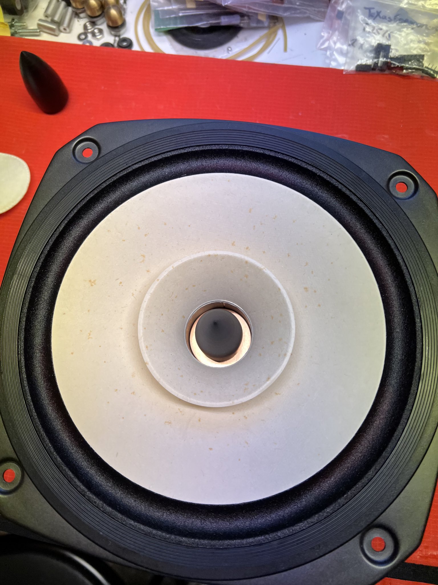

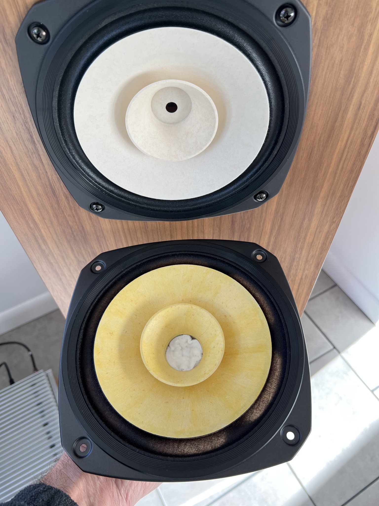

I went looking for information about the pre-treatment you mention.
I have outlined them a number of times, but even i have trouble finding them.
“conformal coating”
The last step in EnABLing. It does do (if you have not done so) some of the same stuff puzzlekoat/ModPodge does.
Step 0: Phase plugs
Step1: Modpodge — colour can be added at this point. Except for black i use some food colouring (a higher end brand gave me more choice of colour. Black is hard, since few things you think black aren’t. So i use a bit of black acyrlic paint for that colour. Thinning and amount applied depends on the driver. FR, thinned a bit and as thin as you can get away with/
Step 2:ZIG 2-way glue at teh surround/cone interface on the back (specific to Fostex FE/FF), 2 coats
Step 3: Massage the wizzer (GM) and coat the back side of the flattened part with acylic gloss
Step 4: Ductseal to smooth the shape of th eback of the driver and damp the basket
Step 5: Line the inside of the basket legs with thickish felt.
EnABL, if you develop the skill, can be done on top of all of these.
I also wanted to clarify whether the Micro Scale product is the only coating product that should be used.
I thought you had posted somewhere that other products like Modge Podge were equivalent and could be substituted?
ModPodge goes on first, acrylic goes over the EnABL spots. Micro Scale Gloss can be used in the role of the ModPodge but typicallly does not achieve the same level.
I’m not very fond of the high gloss appearance of the Micro Scale.
You can get matte and i believe one in-between. Same with the ModPodge.

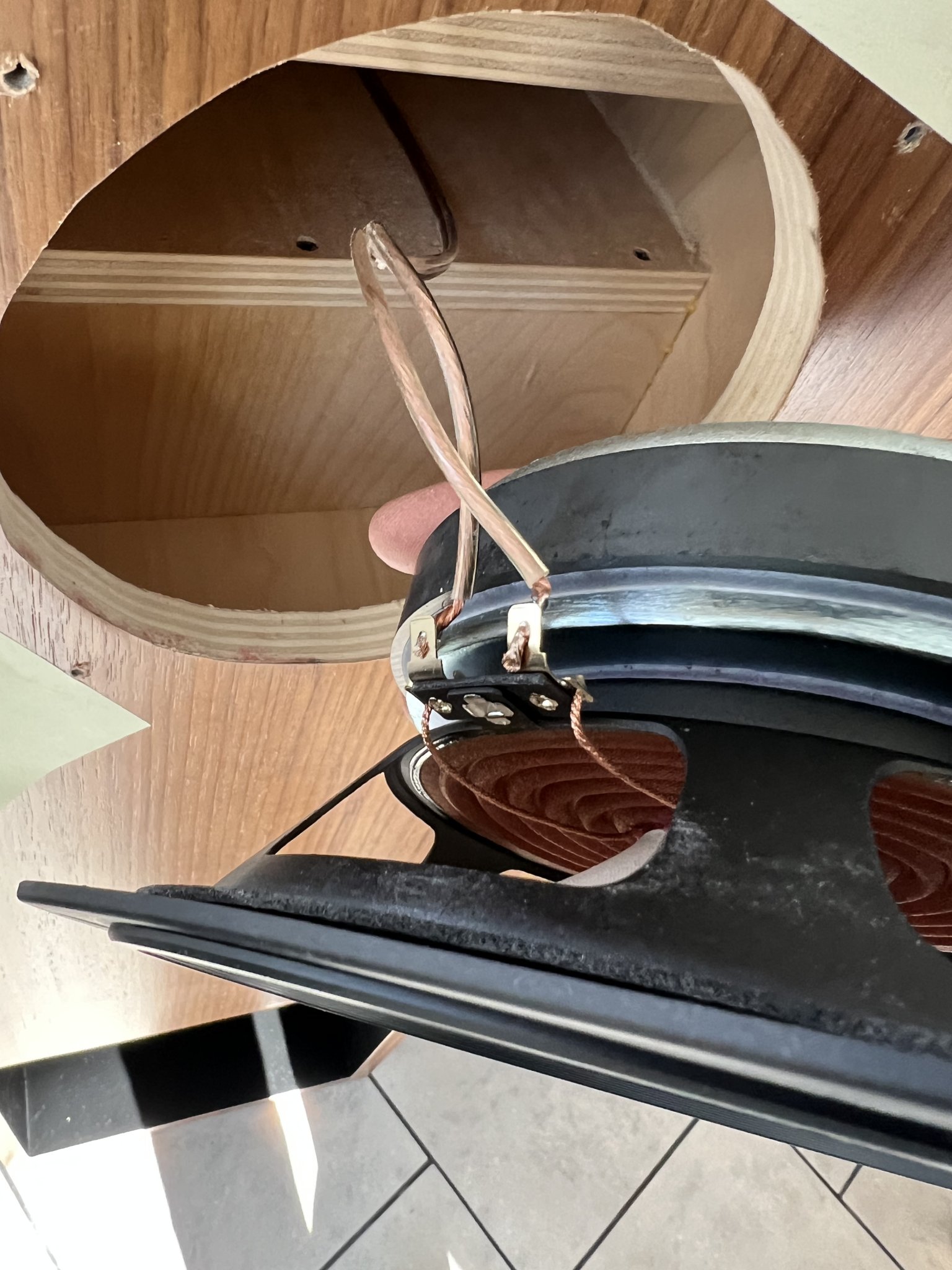

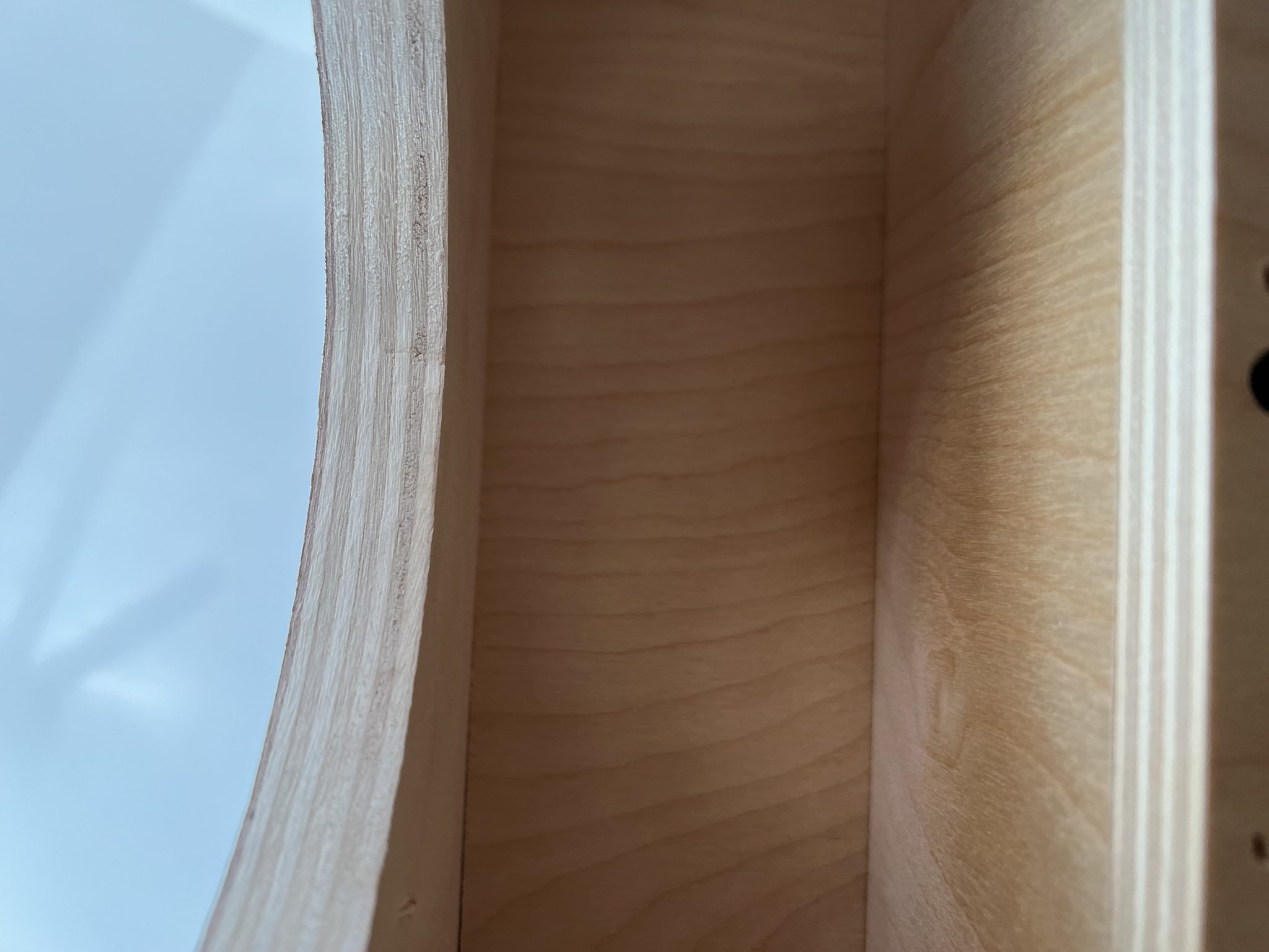

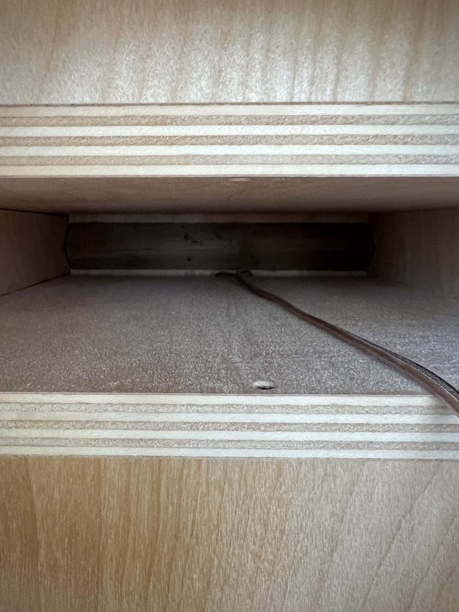

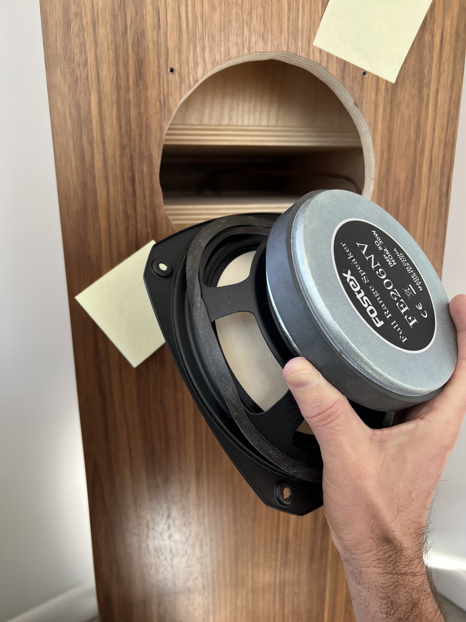

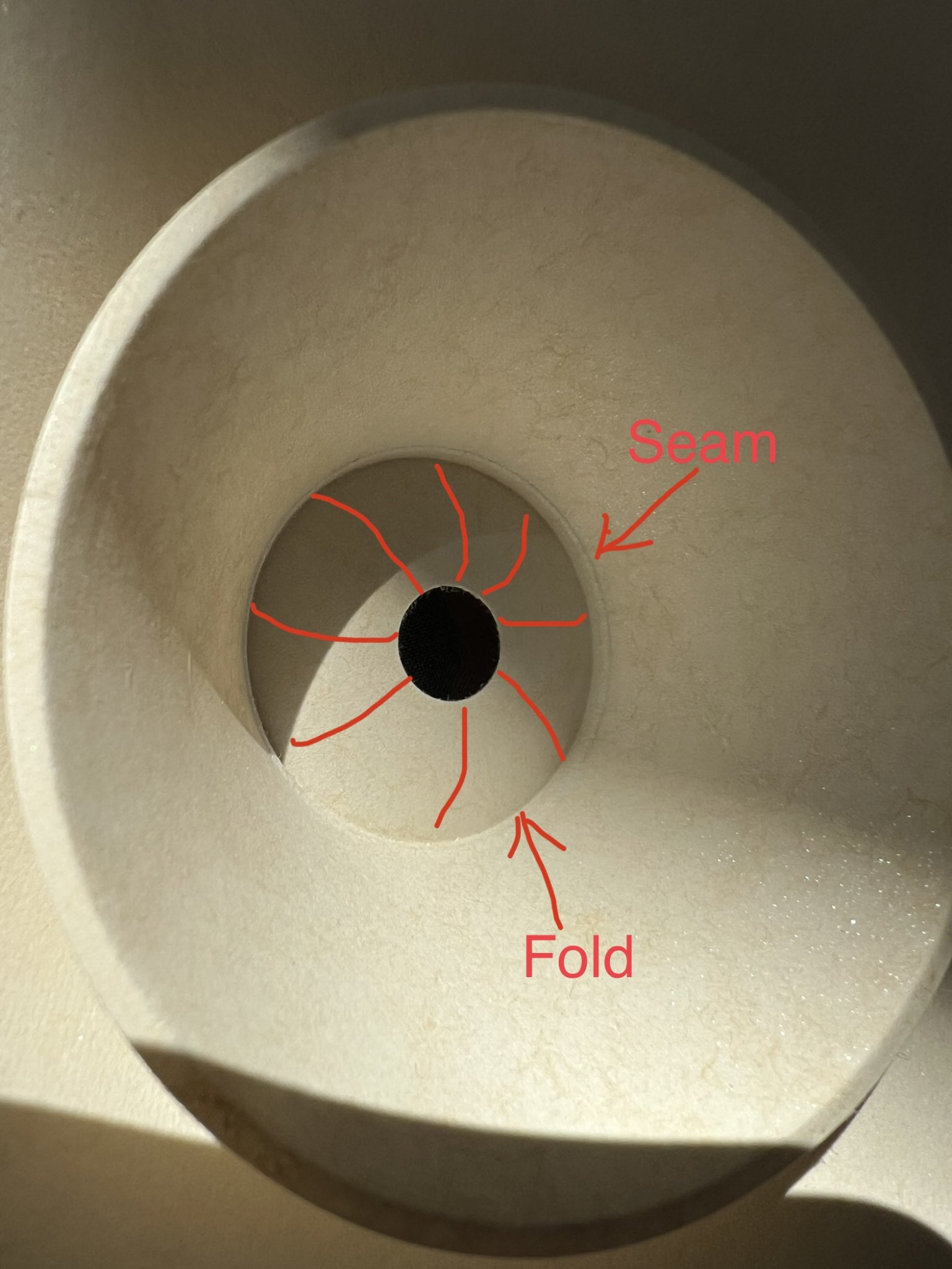

Curiosity got me to do some quick recognizance this AM.
I pulled one of the drivers to take a look at the state of affairs inside the cabinet.
So it looks like I’ve got a bare bones build.
It definitely looks like the driver chamber and throat of the Kirishima.
No modifications to the drivers at all.
No lining in the driver chamber at all.
Run of the mill 16 gauge hook up wire.
I’m a little disappointed in how the driver hole was cut. Its a rough jigsaw done affair.
It’s not clear that there was any attempt at beveling the edge of the opening…maybe a slight angle or just flexing of the jigsaw blade…only had one hand free to explore and take pics.
I would have done this with my router and a circle jig and then flipped the baffle and beveled the opening before assembly.
As I said, I will probably have to apply a supra baffle to try other drivers.
I may end up making a slightly bigger template with my circle jig to clamp to the front and recut the hole using a bushing guide on the router.
I can make the opening in the supra baffle with the circle jig and bevel it properly.
My only concern would be the slight increase of volume in the driver chamber resulting from adding the thickness of the supra baffle.
So those are my OCD quams.
Even in this state the speakers sound great playing Duo with Kenny Drew & Neils’ amazing bass virtuosity!
I suppose starting with something that sounds this good with absolutely no optimization is a good place to be!

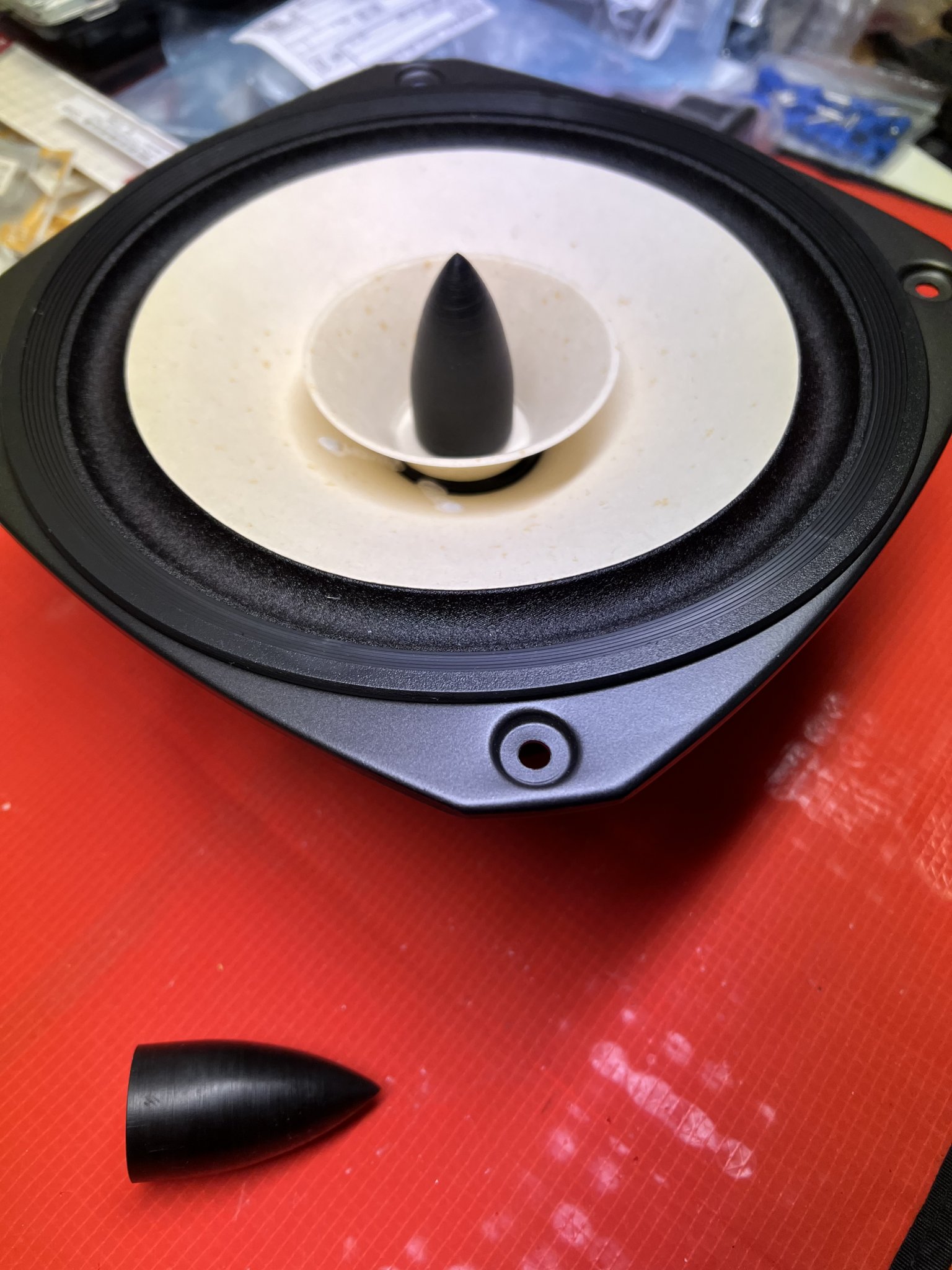

Haven’t done any tinkering in a while. I spent some time on the lathe this afternoon and tried my hand at some phase plugs (since that’s phase 0 on the mods list).
I used some Delrin I had on the shelf.
I think they came out pretty good.
I still need to bore and tap the base of them for a magnetic bolt to hold them in place.
Length may need adjustment…won’t know until I dive into the dustcap surgery.

My situation is a little different with 206e.
There is no surrounding bead of black adhesive where the dustcap mounts inside the whizzer. Although, there is some adhesive under the whizzer where it joins to the coil and cone (one of my drivers has an inconsistent bead here that may need addressing).
If I slice the 206e dustcap open and then try to pull it apart from the inside of the whizzer I am not sure if it will separate at the seam (see pic) without possibly damaging part of the whizzer or more.
I am wondering if I need to first perforate or cut at the fold (see pic) between the dustcap and whizzer to get the cap off cleanly without damaging the whizzer or cone?
http://www.planet10-hifi.com/pp-install.html
4 examples including FE167
For FE103 try this trick first. https://www.diyaudio.com/community/threads/fe12x-dustcap-fix.181603/
Sharp? Yes, but it may not seem so when you slice.
The VC issue was 2000-1010 FE127e, never tried to wreck any others.
dave

Thanks for that Dave
I was on your phase plug page…but somehow missed the links to the installation pics.
The 167 pics are perfect fir what I’m dealing with on the 206e.
When I read people were using 15/16” sockets as phase plugs in the 206e I figured I’d use 1” stock for my phase plugs…might even be too big 🤦♂️…ugh!!!…that’s the inside socket size bone head!
No idea why I missed this when I propped it on top of the dust cap.
Well…I guess I have some really nice 1” phase plugs I could put in what?…a pair of 107e in some reflex monitors in the bedroom?
No 1.25” Delrin stock on hand…have to find something else or order some.
On the bright side…surgery went well on the first driver .

Can I ask what you recommend for a gap between the phase plug and voice coil former Dave?
I took a look at my Sonido. I’m guessing they have maybe a 1 mm gap between the plug outer circumference and the inside of the coil former.
I measured the bore size inside the 206e coil former around 34.5 mm at the junction with the whizzer/cone…which is just short of 1 3/8”.
I was hoping to use a commonly available size of stock here.
A 1 mm gap would leave 32.5 mm or 1.28”.
The closest most commonly available stock size would be 1.25” rod.
If I were to use 1.25” rod for the plugs I would be left with about a 1.375 mm gap around the phase plug circumference.
Do you know think that’s too much?

As little space as you are comfortable with. Small.
My FE206 plugs are just over 33 mm in diameter.
dave

In the mean time, I decided to move forward with trying a coat of the tinted Modge Podge on the driver I removed the dust cap from.
Not easy to maintain a uniform coat thickness…so some color variations…especially where I began and ended where there was overlap.
I’ll make sure I start in a different spot in the cone for the next coat.
It doesn’t look bad.
I’m not getting as much opacity as I hoped for to cover the spotting on the cone.
Not sure if I should try adding some more Sienna to the second coat with hopes of blending in more with the spots…or perhaps adding some white for opacity.
I’m tinting with some Windsor Newton tube watercolors I had in hand.
Might go ahead and do surgery on the second driver and add a coat to it so I can see how similar they look.
The spotting only appears to be on this first driver’s cone.
Pic to compare original color (on the 206nv) to the 1st coat.
It does take some practise, and the FE206 is a big cone, particualrily tricky under the whizzer.
to the second coat
On a FR i try to use as little as possible and never a second coat unless i specifically want to blunt the highs.
Looks good, it is light colouring.
dave
Thanks for sharing that Dave.
I had read elsewhere that people do more than one coat…even several.
It obviously can’t be reversed once it’s on there.
I’d rather do the least amount possible and listen first.
So examining the cone in daylight after it dried for a while I saw that the unevenness I was picking up on was due to some areas being a bit thinner or even not fully covered due to texture in the cone.
I had thinned the Modge Podge off the bat because I first dissolved my coloring in a couple tablespoons of water…guesstimate about 1-2:10 mix of tinted water to Modge Podge.
So I sat in daylight and drybrushed a little more over the areas that seemed thinner or not covered completely as I rotated the speaker and examined it.
I’m happier with it now. Still some starburst strokes here and there, but nothing that is really distracting.
The spotting from the light mildew it picked up a few years ago is still visible…just pale Sienna colored spots here and there. Almost looks like part of a hand made paper making process.
Since the other driver in this pair was completely unaffected it won’t match really.
I’m thinking of purposely adding some spotting.
Gonna do some experiments with splattering some Sienna onto a manilla envelope with a fairly dry hog hair brush from a distance and see what I get.
