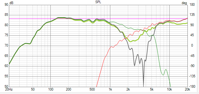

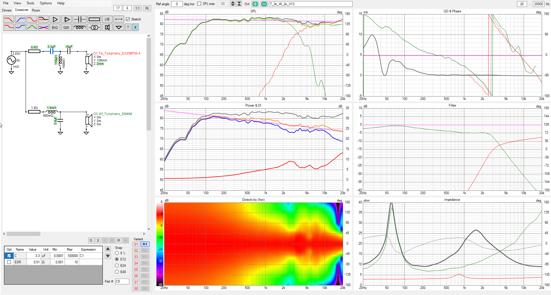

Measure the speaker with the tweeter reversed in polarity. This will show you how the crossover really works.
This is no weird or exotic thing to do, but a must when building a crossover.
If you ask me, the driver combination could make a much better speaker with a good crossover. The woofer is running too high.
If your two cabinets show different bass output, the "screw on" rear panel may be the cause. These 6 screws are not enough, make it 10 or even better glue it on if you you are finished (in this case you sure will change something in the future, so maybe stick with screws).
The resonace you see in the impedance plot is quite usual for such a high cabinet. You may reduce it with some damping material in the top of the volume (as your port is on the lower end). Some diagonal bracing can help, too.
There's a ~200Hz resonance in both speakers.
Probably the speaker heigth resonance - it will be excited at wavelength of double heigth (heigth 85 cm?). But it is not very strong - I wouldn't loose any sleep over it.
Also, the "port dip" is different in one speaker - same freequency but less deep - anyone know why that may be so?
The bass reflex / helmholtz resonator seems to be quite lossy. That may be caused by air leaks or "too much" dampening material.
Did you put any sealing strips when screwing on the back panel?
Yes - that 33Ohm mountain will be in the "lessons learned".
No problem at all and very normal at crossover frequency, as others have stated!

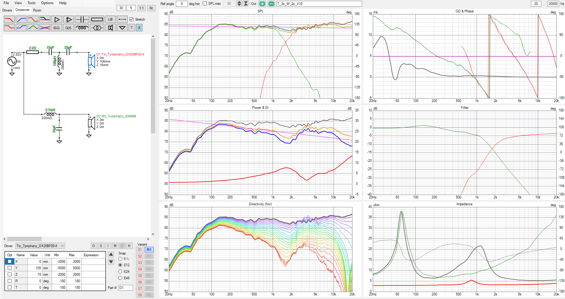

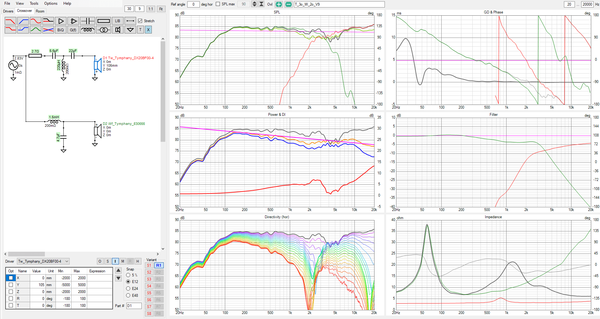

  • Since the backs are screwed on - I can make a new X-over. Which means nearly all new parts and more $$ - for a speaker I tried to make as cheap as possible. I suppose I can keep the exiting parts and reuse them for other projects. Here's a new crossover idea. Crossover moves down to 1400Hz from 3300Hz. Better? Should I bother?
I also thought about making a 3 way using these drivers along with Peerless 830992. Maybe I wait till spring and try making that speaker instead? How do you fellas keep from accumulating projects/stuff?
In some respects its better, such as the much lower amount of overlap through the crossover region, as well as the more resistive impedance curve.
However, I'd caution against using such a low crossover frequency with a 20mm tweeter, as the tweeter's power handling capacity is likely to be exceeded if playing music at loud listening levels. You could drop it down to 2.8kHz or 3.0kHz, maybe even 2.5kHz, but 1.4kHz seems fraught with danger as far as long-term reliability goes.
If you can share your VituixCAD files, someone might be able to have a bit of a look at some options.

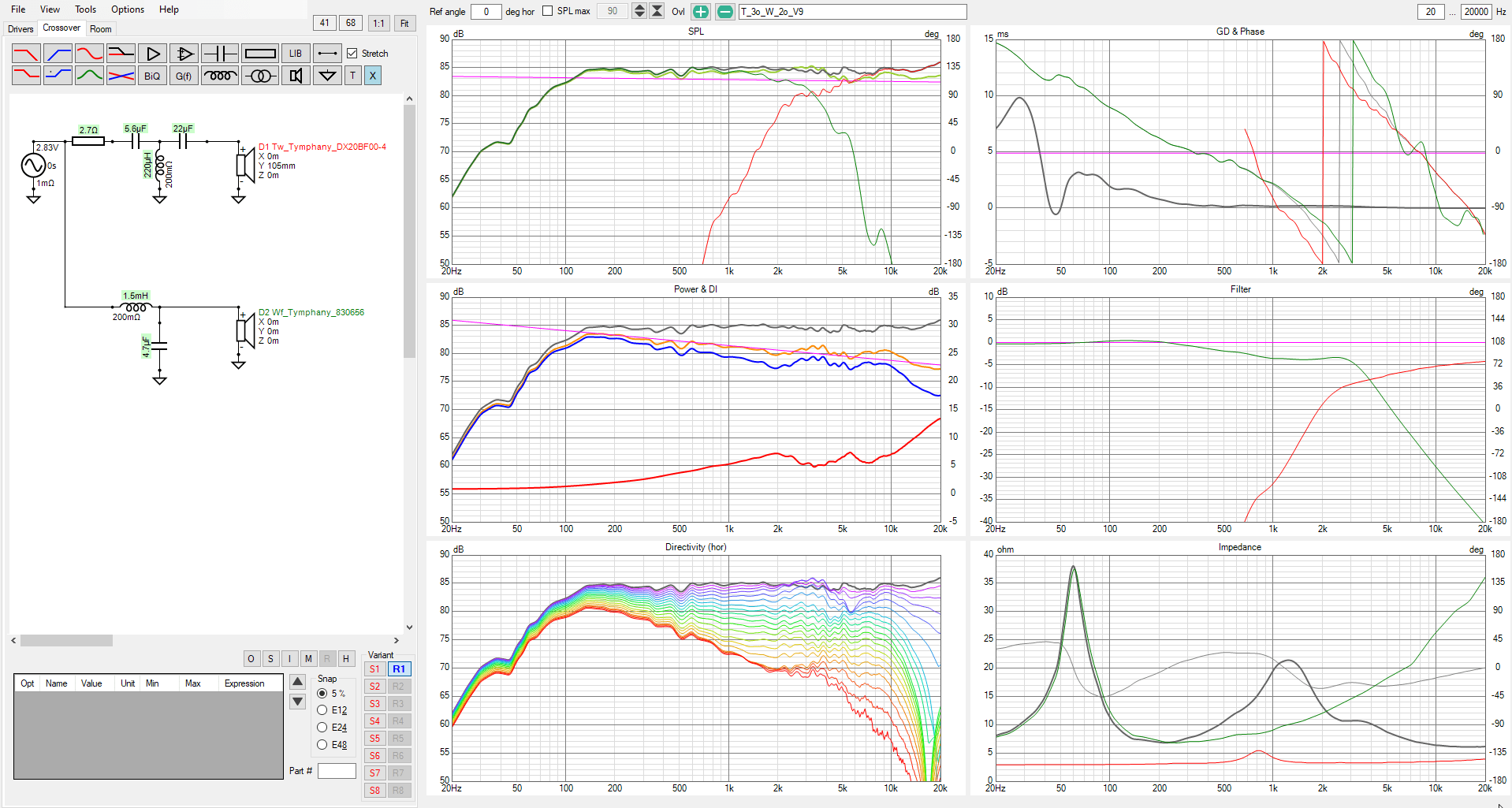

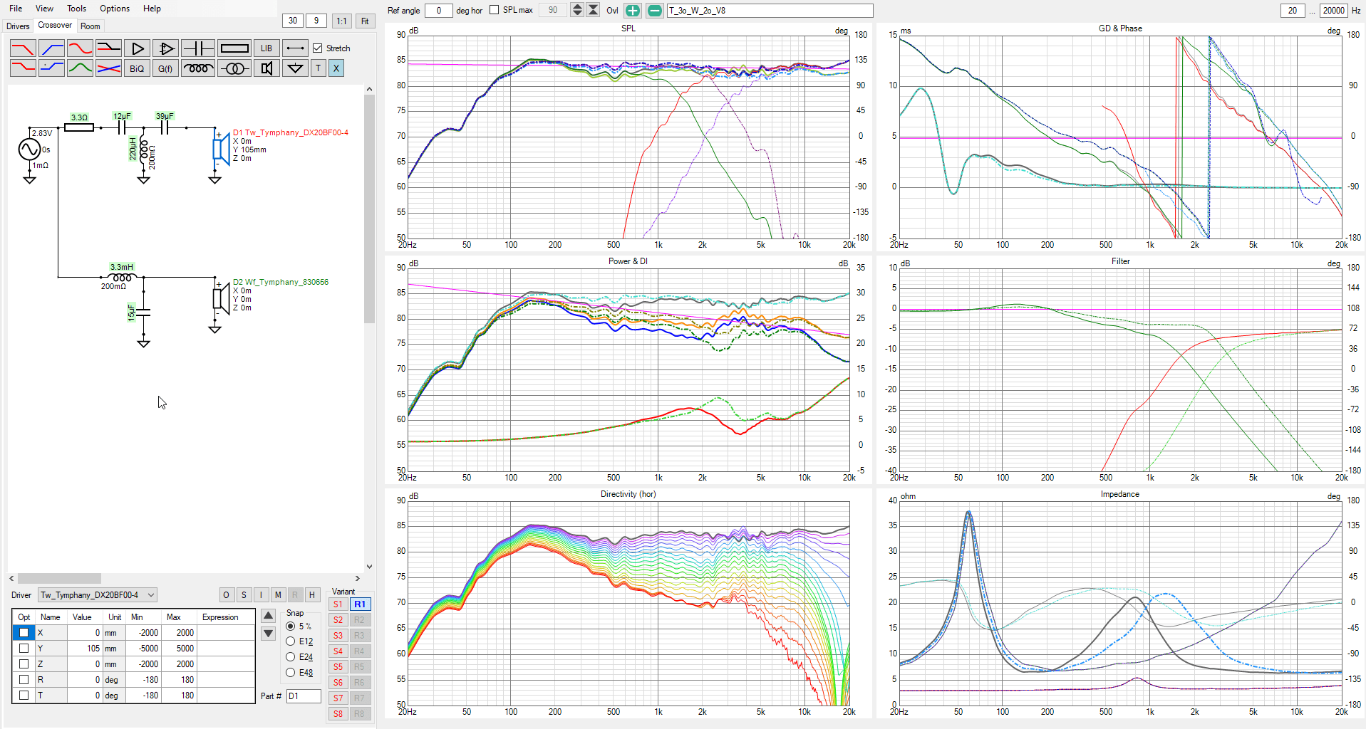

Yup. I am aware that 1.4 is low - but I can't seem to get to 2K without everything else going askew. This is the best I got at 2K, by going to a 4th order on the tweeter.
Vertical directivity seems a bit worse, narrower. More parts. More $$ 🙁

Your new crossover is set way too low. Sound and voice coil will suffer. You had a crossover at post #3 that looked quite promising.
Try to do that with a second order configuration.
Reactions: witwald

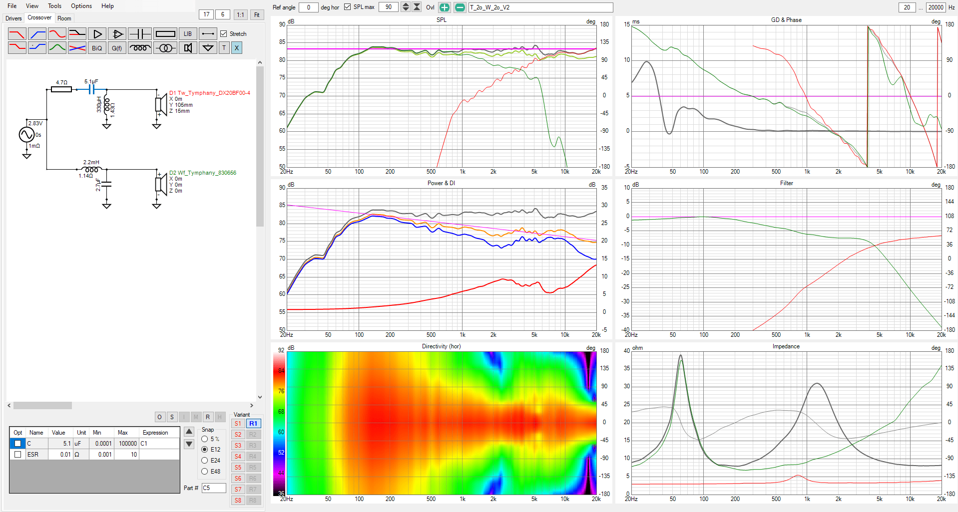

That is quite a good result. At least now your tweeter must cope with much-reduced levels at 1kHz. It's 29dB down at 1kHz, versus only 14dB down in the previous design, a benefit of 15dB. This translates to a reduction in input power of 96.8%.
Unfortunately, a blown tweeter, 😢 , also means more (replacement) parts, more expense, and also added repair time.
The newer tweeter filter that you have produced should help the tweeter give its best in your loudspeaker system and do so in a reliable manner.
