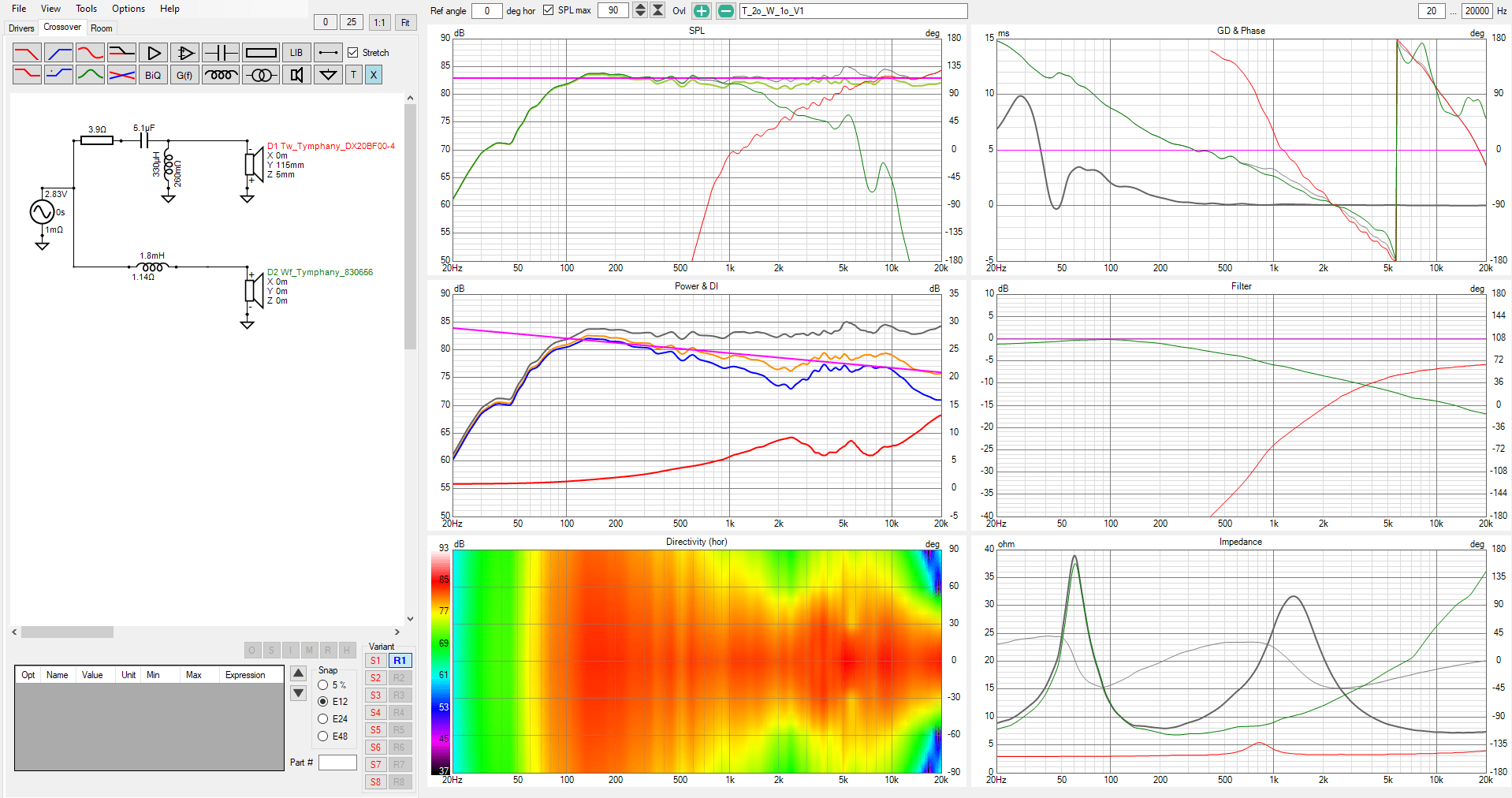

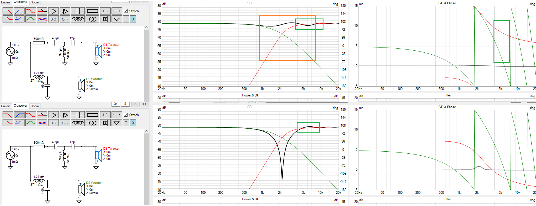

I confess that tracking / divergence only makes sense here re Phase. Re the cancellation, this asymmetric crossover with 50mm acoustic offset to show cancellation is trying to exhibit what I mean. I can see with a RN the constructive / destructive effect on the summed response. Yes I can see phase diverge and yes you can read the amount of cancellation from phase. I wasn't saying you couldn't.
The orange focusses on the more or less audible passband I usually focus on (~24dB below reference)
Reactions: ThatSoundsGood
If I decided I wanted 35 degrees positive phase difference between the two drivers held constant across the crossover region, I could see that on a phase plot but I couldn't easily see that on a null plot without deeper analysis.
Although phase "is not right", we listen to the frequency response, not phase unless I am mistaken.
That's right, but phase plays a role in what that response will be.
For the deep null, we see no destructive interference between drivers. i.e. when inverted, one driver is not cancelling the other out. Albeit this is only a single axis view. Although phase "is not right", we listen to the frequency response, not phase unless I am mistaken. Sure - someone could naively look at this inverted response and assume the on-axis inverted polarity would be linear, but we know that's not the case as we can see only a -3dB XO point, so combined with on-axis, I would not be worried about the relative phase between the drivers. they track well through the XO passband, would you not agree?
Anyway - I have no problem with people wanting different views of essentially the same information that leads to the same conclusions. Maybe I'm completely wrong, but I don't have a problem with phase only, or FR only views. Only if you mis-interpret the data to draw a wrong conclusion.
We will hear the phase if it's problematic. For example, if the drivers sum 6db at the crossover point then they are in phase there, but if we only see them summing 3 or 4db higher together then they could be 90 degrees out of phase and I promise you will hear that and it can be weird. This can often be seen better with a variety of off-axis measurements. Also, I have seen situations where drivers are in phase at the crossover point but out of phase at a different point below or above that. It can get weird when you're combining acoustic and electric slopes or manipulating the Q of the slope too far.
I will also add to this discussion that I think keeping this tweeter crossed higher is a better option and I think the 2nd order crossover above is the best looking one. I also think that these are simulations for a crossover and it's important to take actual measurements because they will almost always be different once the drivers are in a box.

X and Z are pretty close to reality (+-5mm maybe less) as per my sim screen caps.
Also, since I'm looking at the Xover again, I tried just a 1st order on the midwoofer and it might even be better than the current iteration. Also - fewer parts - so stays with the cheap and cheerful theme. My worry is that distortion and breakup will be more likely as there only 4db diff between the midwoofer and tweeter at ~5400hz.

EDIT - also disagree - I am comfortable with predictions that Vituix provides. If the resistor was a 4,7 - it would have been even harder to tell that the tilt is too much.
over time you will learn how to not have 30 ohm peaks
at crossover points.
Using impedance compensation and adjusting component values
to the driver impedance points at those frequencies.
Crossover points are likely not 8 ohms.
then of course most the issue is " pulling out"
all the baffle step from using too small of baffle.
Reactions: eddantes

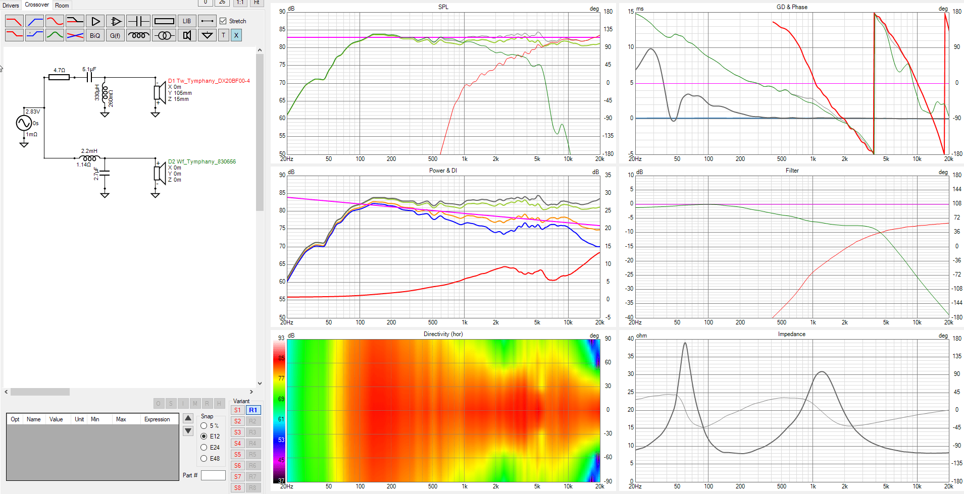

2nd peak is smaller. Thanks for your suggestions @WhiteDragon. Lets see how this translates to the real world.

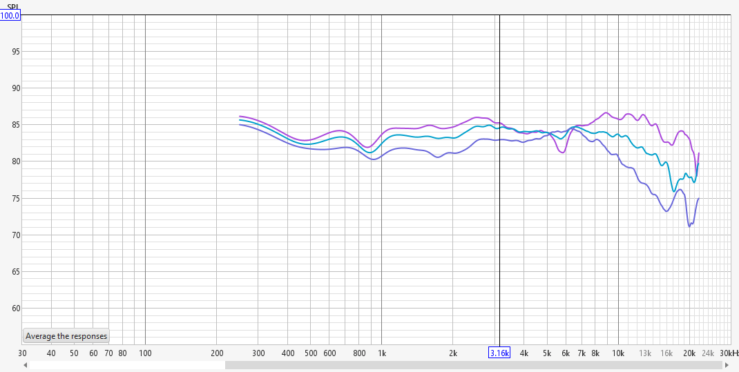

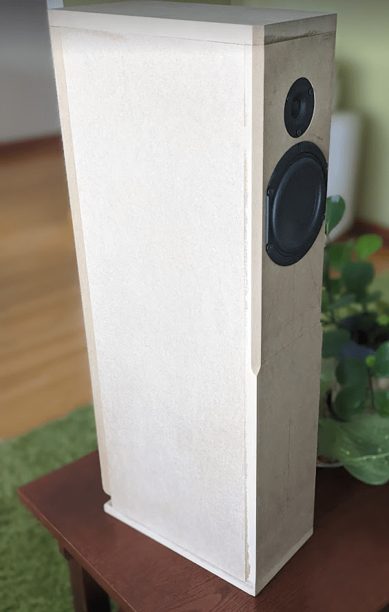

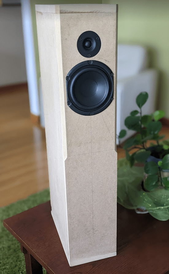

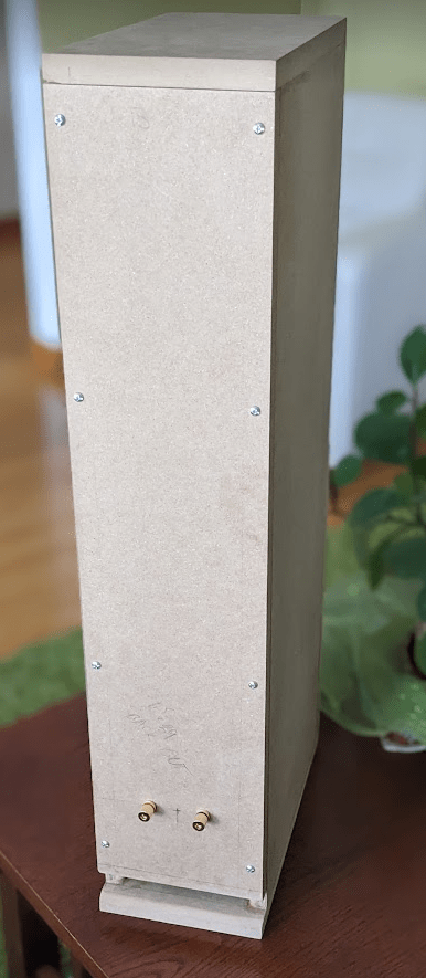

Hi all - just wanted to update. As mentioned I've built the speakers and today I got a chance to measure them (windowed to ~300Hz).
Executive summary: I built a short floorstander that doesn't sound good from above (D'oh!).
However, raising and tilting to get to woofer axis and below - it's really not too bad, considering the negligible parts cost (~$200CAD for the entire project). I am pleased with my first ever effort. (Lessons learned at the end).
Pics:

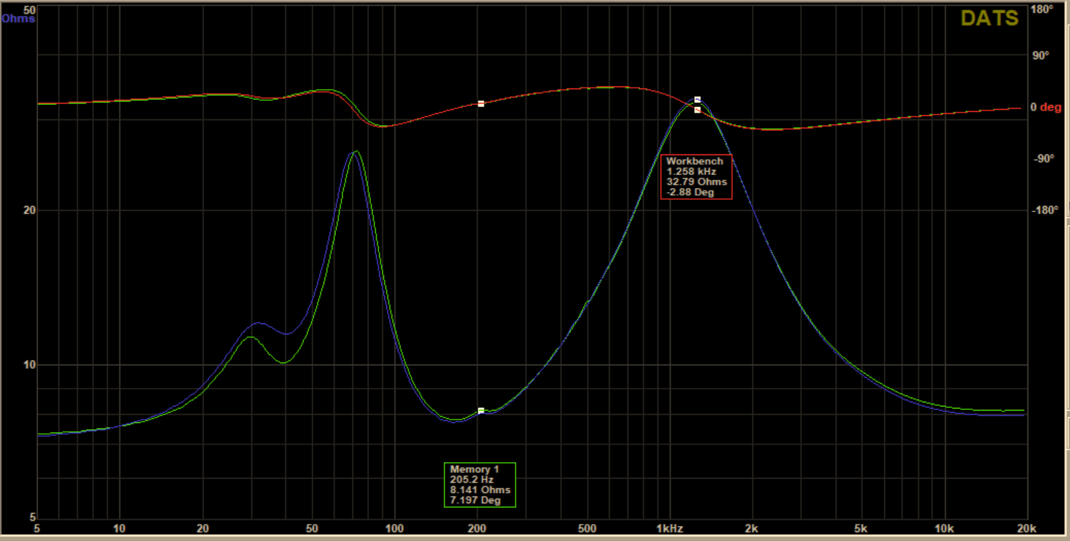

Impedance sweep:
There's a ~200Hz resonance in both speakers. Also, the "port dip" is different in one speaker - same freequency but less deep - anyone know why that may be so? Yes - that 33Ohm mountain will be in the "lessons learned".
Measurements:

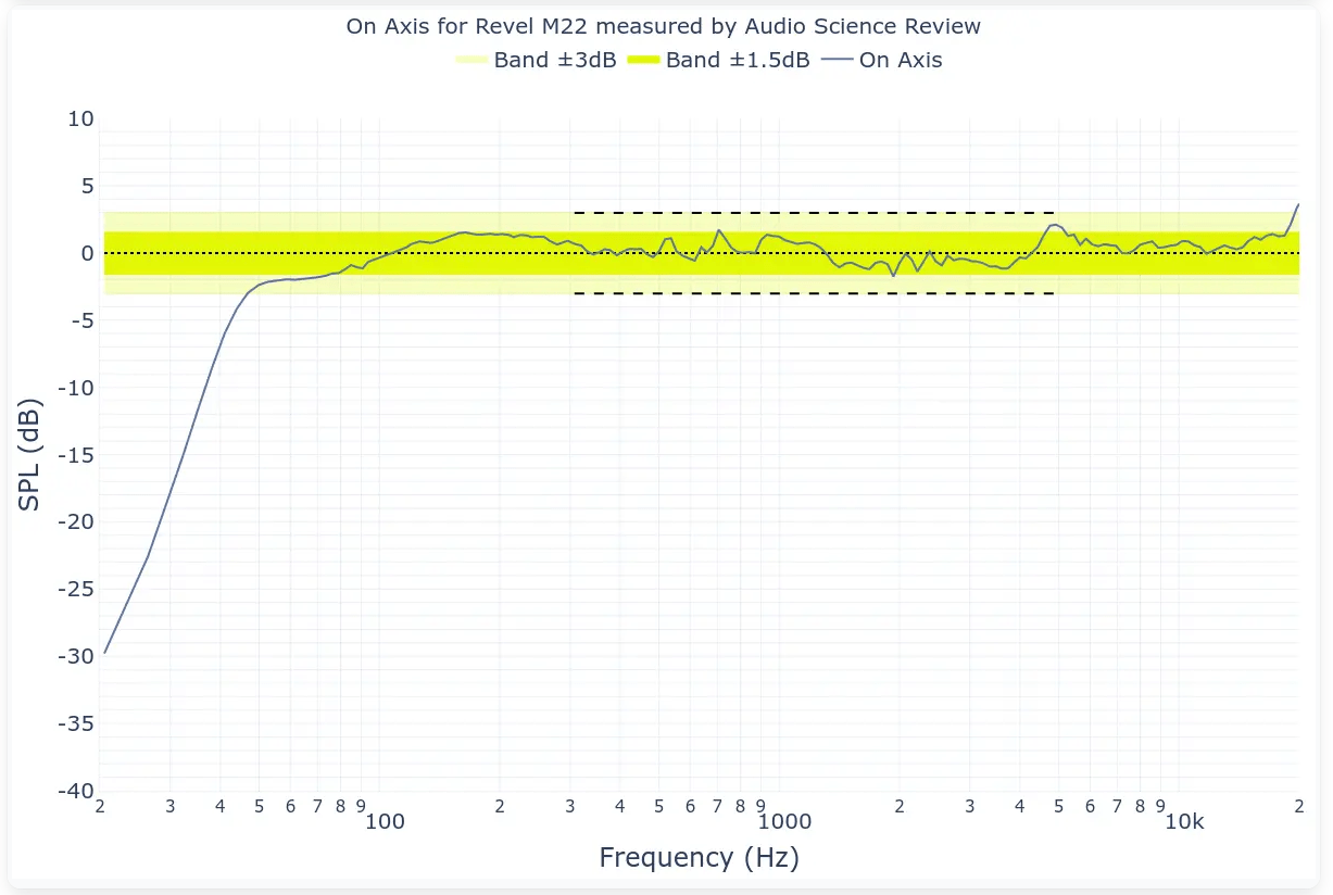

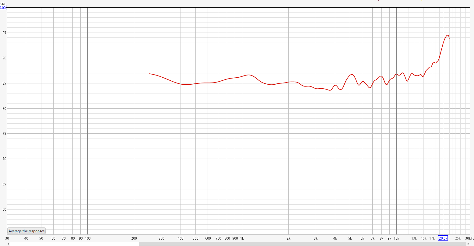

Measurement validation - I measured my M22 first, to see if what I get is reasonable compared to published data and it seems OK-ish (emphasis on the "ish").
And mine:
Not sure how to scale it to match ... but it seems OK to me. Dip between ~1K and 5K seems to match and the rising response towards 20K. I dunno - if this is too far off, then what follows is not good either.

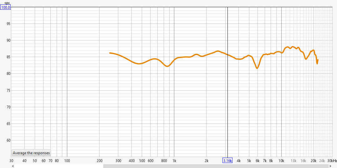

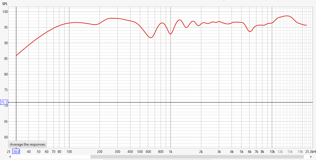

My speaker - on axis: Eeeewww what's happening at 6K!???
Horizontal (15, 30, 45): Hmmm - 6K dip smooths out a bit off axis?
Vertical Below (Woofer, 10 below, 20 below): Also smooths out at 6K.

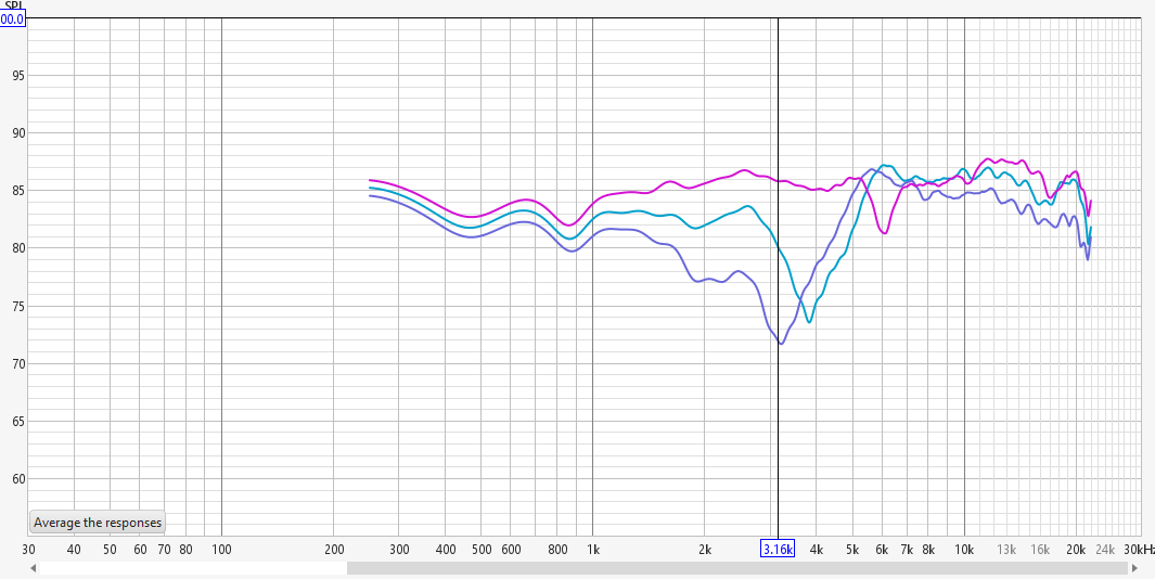

Vertical Above (Tweeter, 10 above, 20 above): OMG! Not good. Not good at all.

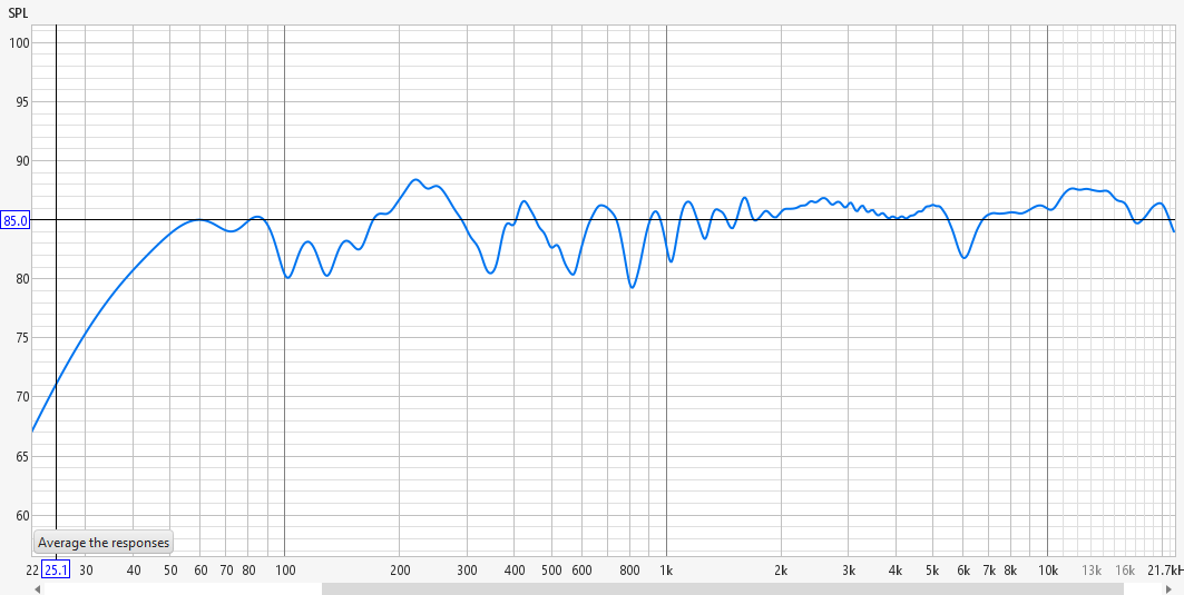

Bass: I attempted to do nearfield measurements and splice earlier with indoor measurements, but I'm not confident of it. So lets just leave this here as an FYI
And here is outdoor on-axis without IR windowing, also as an FYI
Subjectively there is enough bass / sub-bass in there to be satisfying.

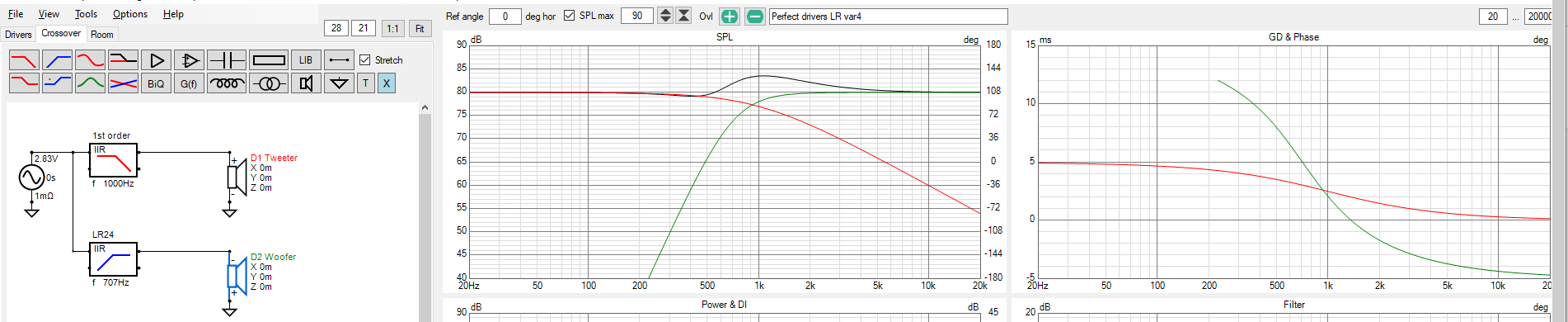

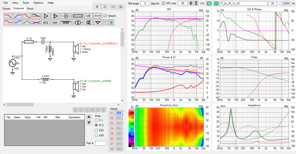

VituixCad Model and Crossover again:

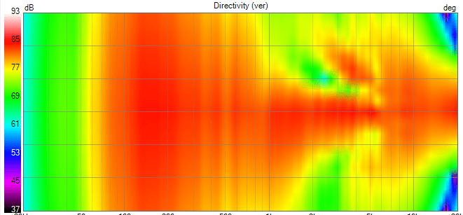

Vertical directivity:

  1. I need to pay attention to vertical dispersion/directivity also! Maybe this would have been a more successful project if the woofer was above the tweeter? I made the layout decision without really thinking about it. I can definitely hear that 3-6Khz chasm when I stand up. Oh well... next time.

1. This is inevitable with relatively higher XO points and larger midwoofer increasing the CtC spacing between drivers. The solution here is to either cross lower or reduce the CtC spacing (thereby using a smaller midwoofer). Of course there are compromises (smaller woofer, less bass and possibly dynamics). One possible solution to lower the tweeter XO point is to increase the order of your XO slope to provide more protection. You'd need to model excursion and measure distortion to see if this is a problem.

3. I agree. Full range / non-gated measurements are tricky. We only have 3 solutions.
a) Jack the speaker way up to about 3.9 meters off the ground to get a reflection free measurement down to say 50Hz at a 1000mm measurement distance
b) Do a Ground plane measurement. I've found these hard to setup and doing off-axis measurements difficult. You also get up to +6dB "mirror" image boundary gain that you need to subtract if you want to get an accurate SPL idea (2.83v @ 1m)
c) Quasi-anechoic. We splice the nearfield and farfield (gated) as you have done, but you must remember to add in the baffle diffraction and step losses to your nearfield BEFORE you splice, otherwise you will artificially boost the bass response by up to 6dB thinking you are getting more bass than you are in reality

The woofer and tweeter have a nice and close centre-to-centre distance, so they have the potential to work well off axis. 👍
I note that the tweeter is close to equi-spaced from the top and the sides, which could lead to some frequency response effects caused by strong diffraction effects. ❓
That might be due to an enclosure resonance.
Also, the "port dip" is different in one speaker - same frequency but less deep - anyone know why that may be so?
Not sure what's going on there? Is one of the ports partially covered over somehow?
Yes - that 33 ohm mountain will be in the "lessons learned".
The measured impedance in the 20Hz to 20kHz range shows a minimum value of about 7.8 ohms. That high impedance peak of about 33 ohms at 1.3kHz shouldn't be a problem, as the associated swings in phase response around it are quite moderate.👍
That's a good question. It does seem a bit odd. Looking at the VituixCAD simulations, you will note that at 5.8kHz there is a large phase difference between the woofer and the tweeter. If the simulations underestimated this, and the woofer had a somewhat higher output, then some phase cancellation might be coming into play. Or it could merely be a cancellation due to tweeter diffraction effects. Check by measuring and averaging the distance from the center of the tweeter to each of the three nearby edges. Even better, doing a simulation in VituixCAD using your baffle dimensions and the location of the tweeter near the top of the baffle might show something.
I'm a bit intrigued as to why you may have chosen the design axis to coincide with the woofer. Can you shed some light on why you may have made that choice? Many systems tend to place the design axis on the tweeter.
It's also quite evident that there is a lot of overlap in the acoustic responses of the woofer and tweeter below the crossover frequency at 3.5kHz or so. It could have been better to ensure that the tweeter filter network did a greater job of filtering, as the acoustic response is only 13dB down at 1kHz, which isn't a lot of attenuation. Of course, that would result in a need for tweaking the woofer's filter as well, as its acoustic response is characterized by a rather slowish initial roll-off.
