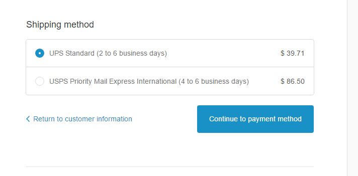

Shipping method
Hi Jason,
In your post here:
http://www.diyaudio.com/forums/pass-labs/276711-sony-vfet-amplifier-part-2-a-142.html#post4790857
you showed USPS Priority International shipping rates. However,
when I tried ordering, I can only see USPS Priority Mail Express International
rate, which is somewhat more expensive.
Is the express option the only one now available? If not, can this be corrected?
Thanks,
Dennis

Interesting and a little odd! Perhaps something to do with your location? I'm not sure. UPS should be fine, but I am not sure about the insurance situation on UPS. Please email contact@diyaudiostore.com with your delivery address ASAP and we will be able to review this for you. We can often see more shipping options than what is offered via the store interface, which tends to offer "the cheapest slow", "the cheapest priority", "the cheapest express". It might be that UPS price is "hiding" a slightly more expensive USPS Priority option if the system classes them as the same "level" of service. Anyway, let us know your address and we'll see what we can do!
