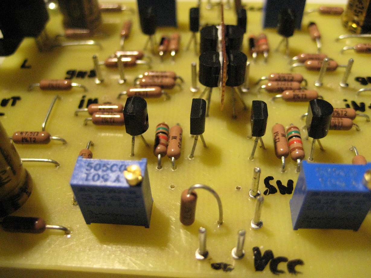

Some progress on the front end.
Everything seems OK, 13 Volts at the JFETs, I can trim the outputs to zero with the pots and bias them to 40mA easily. I used the new values for the resistors which Papa mentioned later on DIYAudio. I have no output capacitor and offset is not very stable, fluctuates with temperature and during warming up. So maybe I should use one.
I run the front end without feedback. Voltage is + and - 35 Volt, a bit high. See pics.

I think R24 sets the open loop gain without the feedback (higher R less gain, lower R more gain). When switched in R24 is in parallel with R46 which results in a lower value R to ground and so increases the open gain, which then gets reduced by the feedback.
Please someone correct me if I am wrong. 😱
I think you are right. With changing the value of R24 you change the gain. In the original part2 article 150 Ohm is parallel to 332 Ohm, this results in 100 Ohm. I tried and gain is higher.
I also implemented a switch, to switch in the feedback resistor of 4k75 only. And it results in around 10 dB lower gain.
Surprisingly also the offset variation gets much (3 times) better 🙂
Feedback makes amplifiers behave better😉
Also the loading of the frontend determines the gain. In the article Nelson says it sees around 1 KOhm but with the new resistor values it will be higher.
So if I drive my DCB1 with this front end, which has 220k inputs, gain values will be different.
I have to experiment more😀
