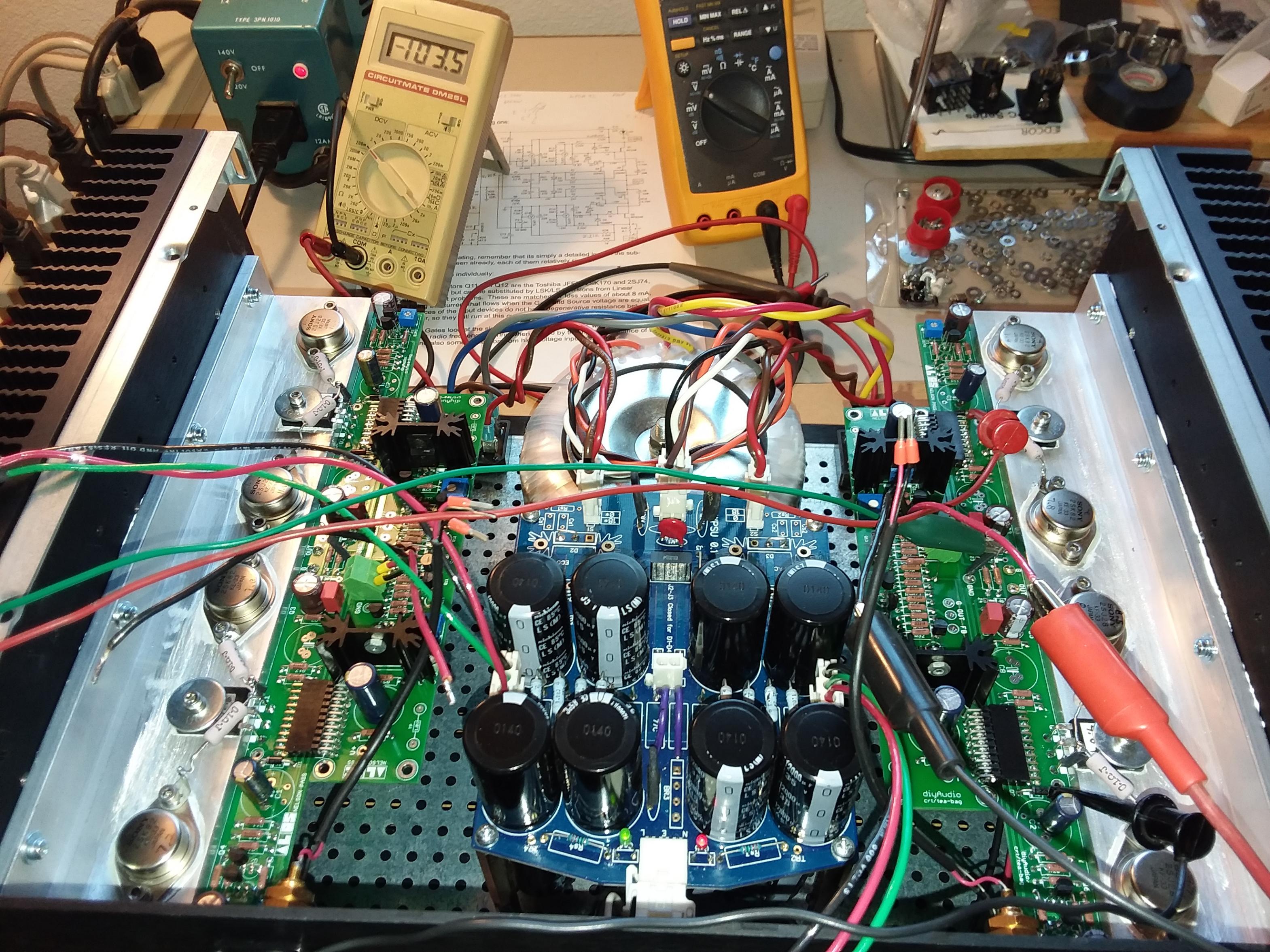

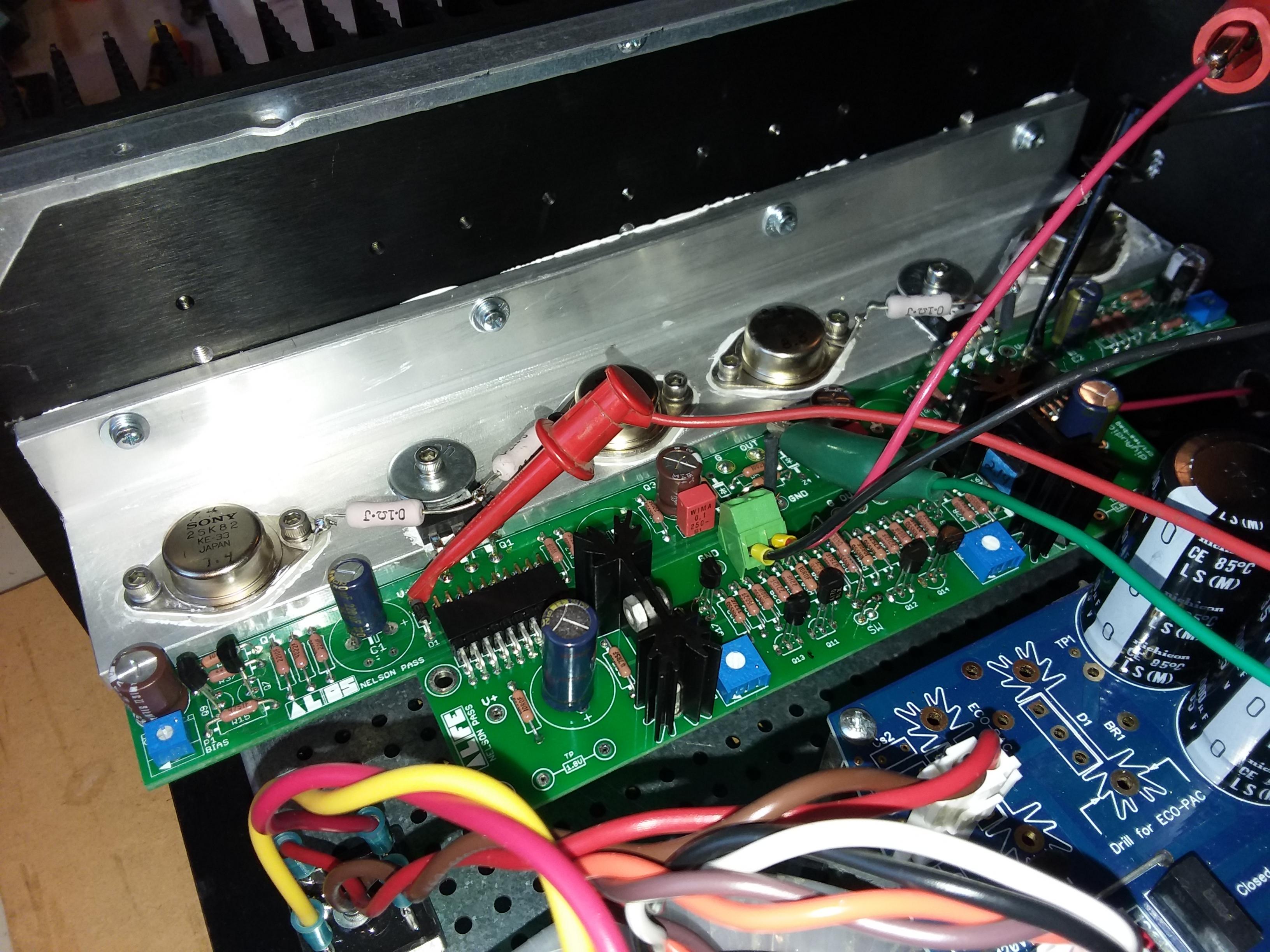

Finally made some headway. Had it on some test speakers and everything is good.
My VFETS were not the best matches so you will see the 0.1 ohm resistors on each drain. In the end a Vgs difference of 0.4 didn't make that much current difference.
Distortion came out about .03% at 1 watt, 8ohm
