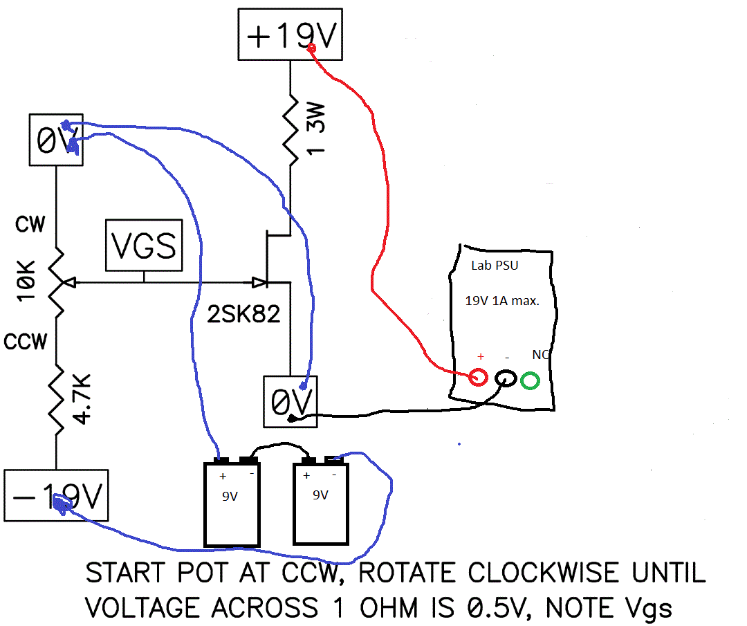

somebody asked me to post funny pic I made for 2SJ28, to make also for 2SK82. So here it is 🙂

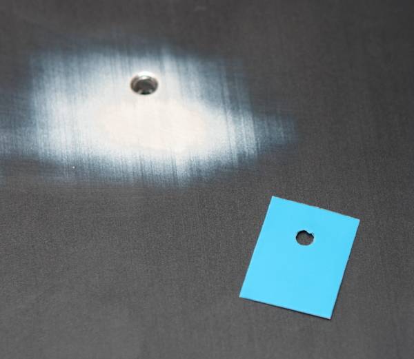

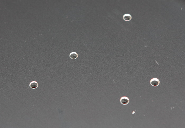

My approach to drilling / tapping / mounting output transistors is this:
1) drill the hole to be tapped
2) go up several sizes of drill bit and just "touch" the hole to remove the heavy portion of the deformation (first image)
3) tap the hole
4) smooth with fine sandpaper and water/oil. Wrap sand paper around a square/flat block of metal so you don't further deform the surface of the sink - think of it as polishing like Claas indicated (second image)
5) pipe cleaners and/or air compressor is excellent for removing chips from tapped hole so they don't bind up the screw that goes in

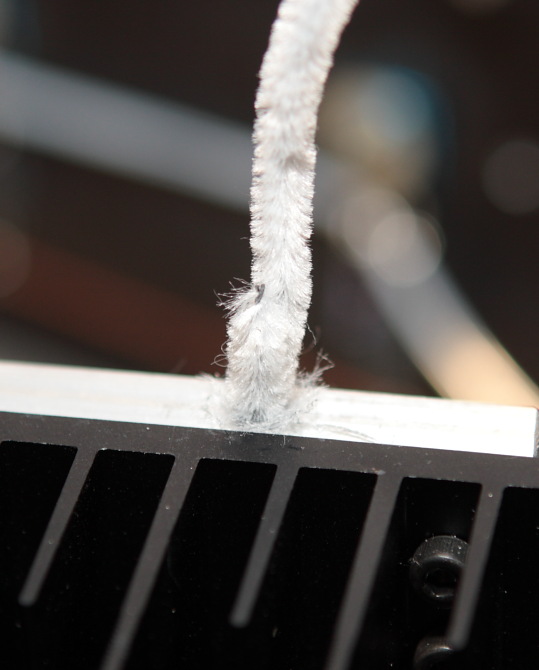

I'm not sure how well "pipe cleaner" translates, so here is another image. It is essentially a thin, twisted wire with cloth fibers protruding out in all directions like a long, thin brush. I fold it in half and run it up and down through the hole a few times. This method removes a surprising amount of chips from the newly tapped hole.

Thanks guys, great tips!
I was thinking of doing a bit of counter-sinking but hadn't tried it, but didn't think of using it to removed the raised rim.
I removed the rim by using fine wet-dry sandpaper wrapped around the other heat sink...counter-sinking first would speed this step up quite a bit.
Eric, I'll pick up some pipe cleaners and use the air compressor that I didn't think about in the mean time.
Thanks again!
