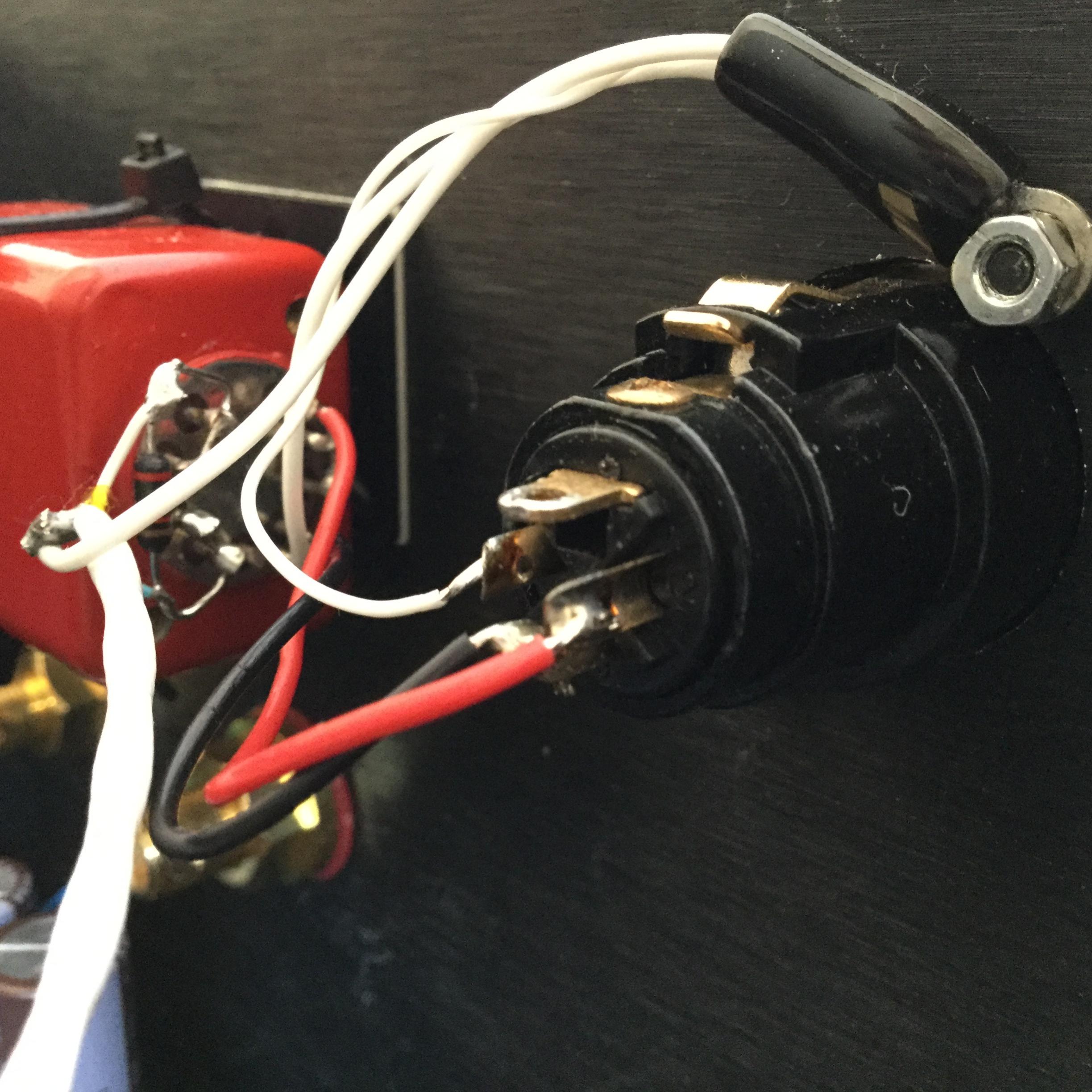

Congratulations on such a superb build! You choose a very clever layout for the dual mono build, keeping the right wires short, grounding everything correctly and tidily, even the XLR sockets!
I see that you've got two separate IEC input sockets, do you switch them individually too? Could we maybe see some more pics of your build?

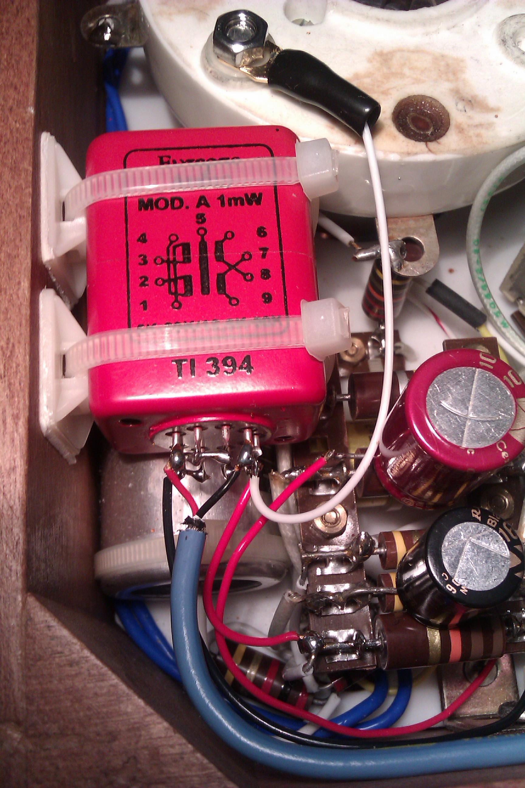

Could You please write more about input transformer , reference model characteristics etc. ?
What the balance signal trick ?
Thanks in advance 🙂
The transformer is shown in the picture. Euterpe Audio has long since stopped producing transformers. The primary and the secondary can be linked this Way:
Primary 1-4 ........... 1-4
Secondary 6-9 ........... 6-9
CC 2-3 7-8 ........... 2-3 6-7 8-9
Gain 1.5 ............ 0.8
Induct. pri. 400H ............ 400H
I have chosen the gain of 0.8. The impedence of the secondary that minimizes high frequency resonance is R2//12K. The impedence refereed to the primary is about 16K.

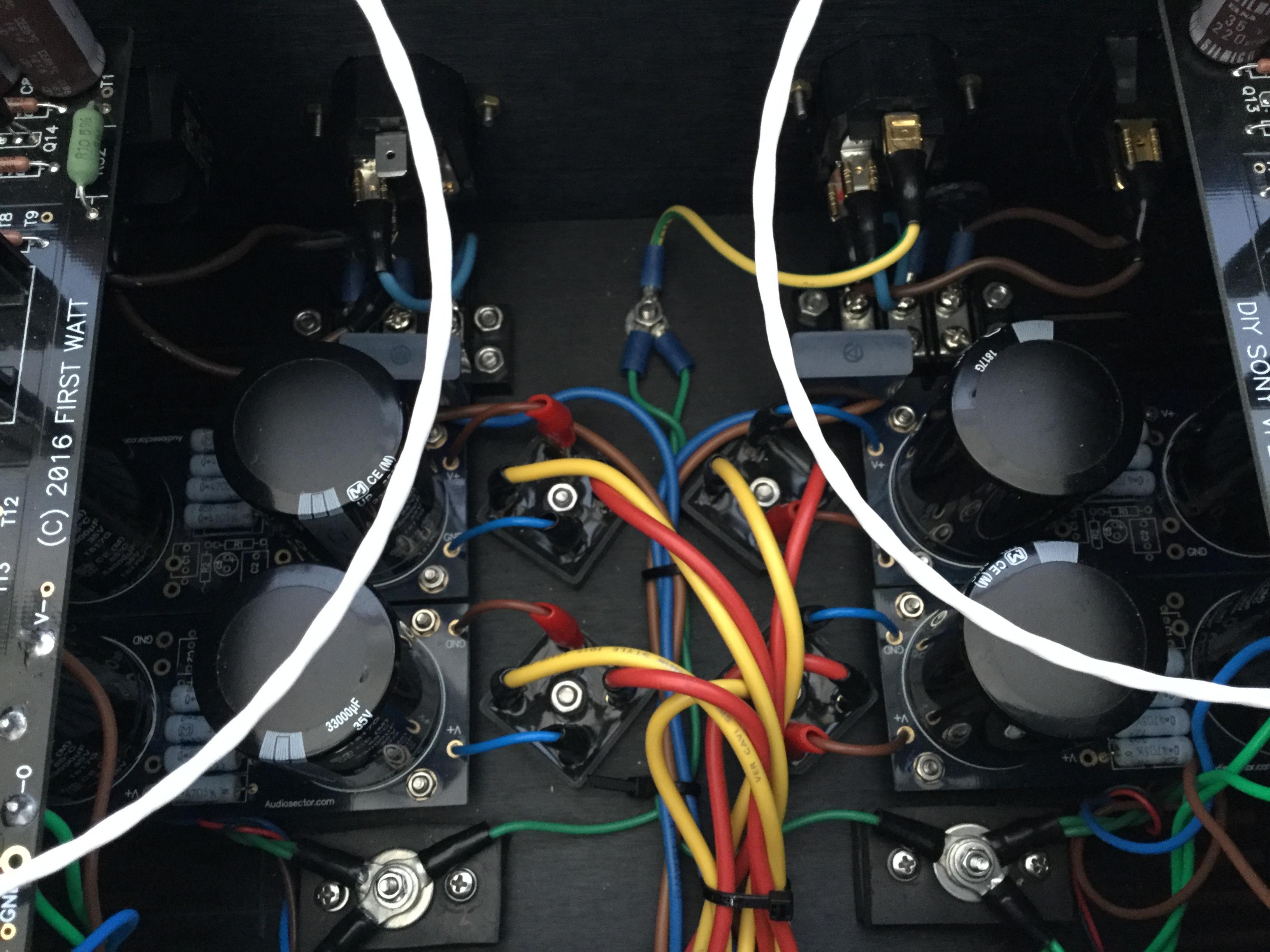

These are the pictures of the amplifier inside. I used the chassis of another project, an Aleph J. the amp had two 500VA transformers, two IEC input sockets, two switch and only balanced inputs. The Sony VFET has the same dual mono structure. The two transformers are 250VA. I hope the photos allow to understand the links.
