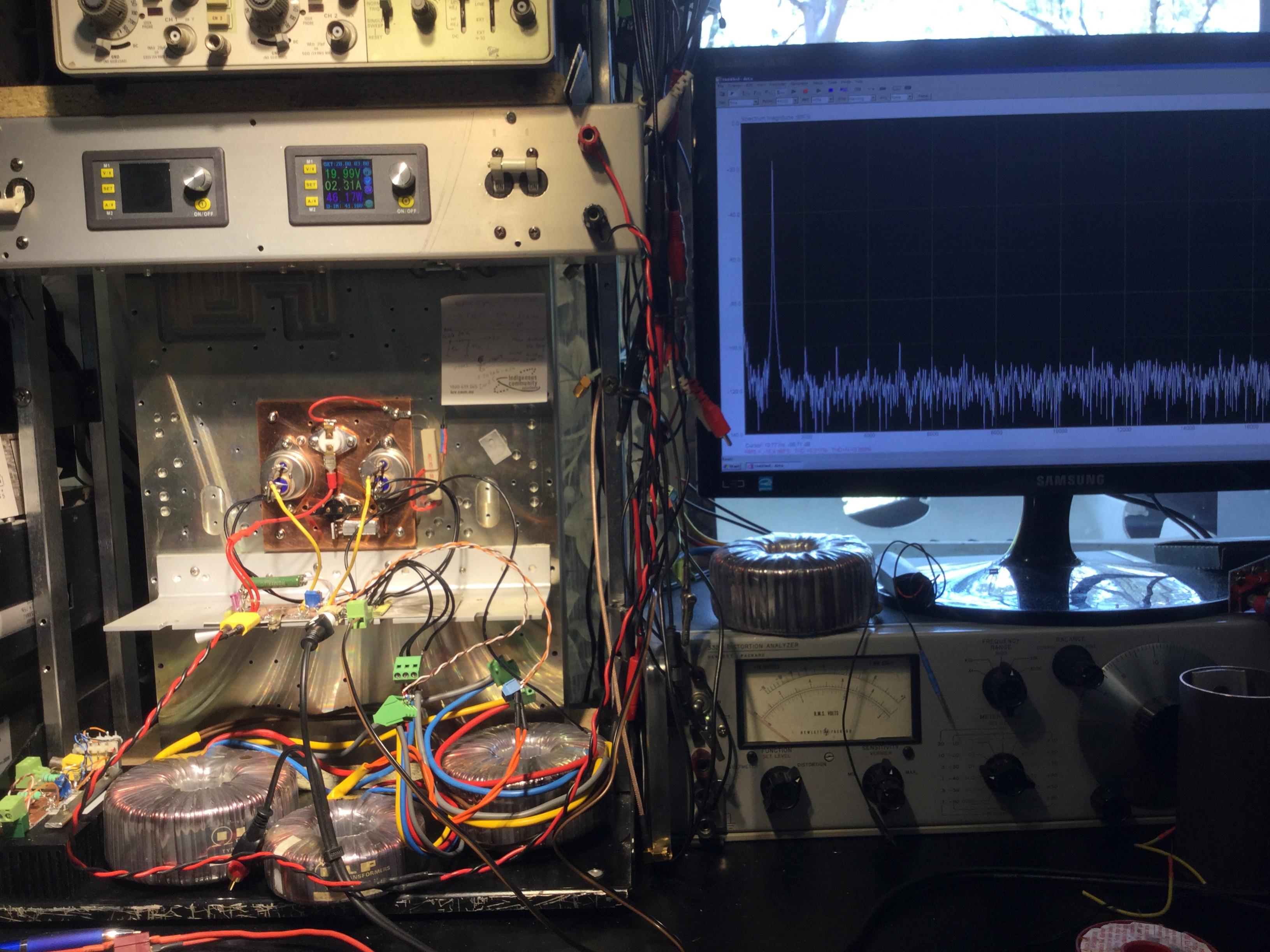

Yes, with these parameters I got around 18w at 8ohm. But you can try others points. Your speaker is the key factor. For me, now, with two or three watts are enough and low PS values are enough. When I built this monster, I want to search for limits (and it is not equal two watts with amp with only two watts that two watts with very big amplifier). Distortion figures are similar at maximum power (2 or 18 watts), but at 2 watts are better with bigger amps (distortion numbers).
I built other version with only 6 watts lowering PS, and soundwas wonderful too.
Try it...
Good luck

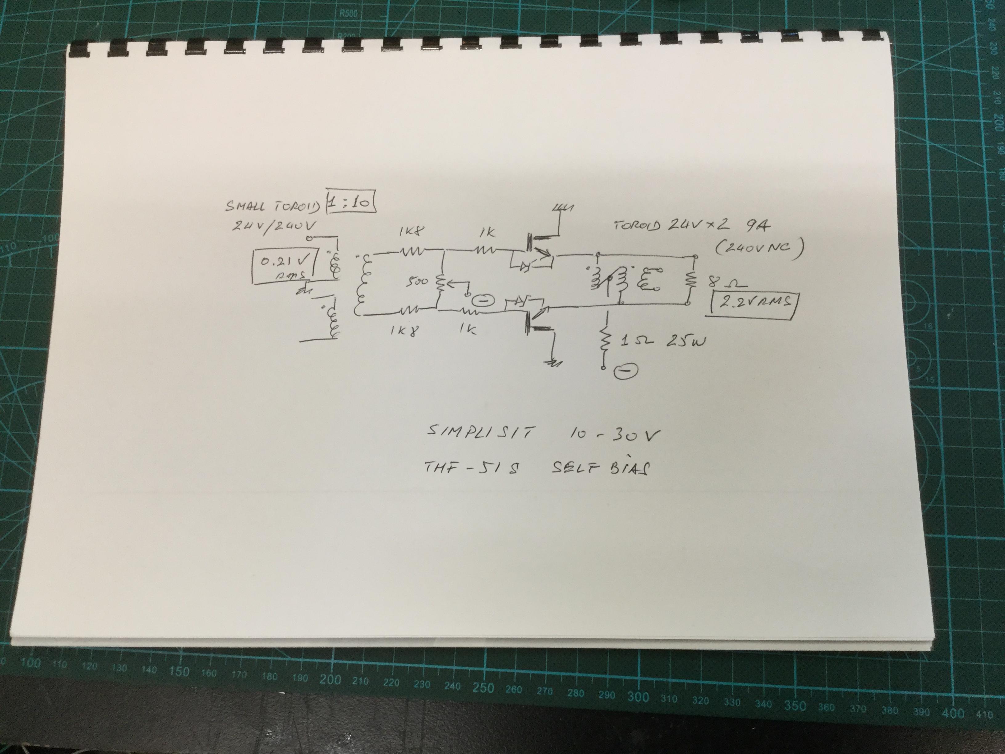

Self Bias
Hi Juanitox

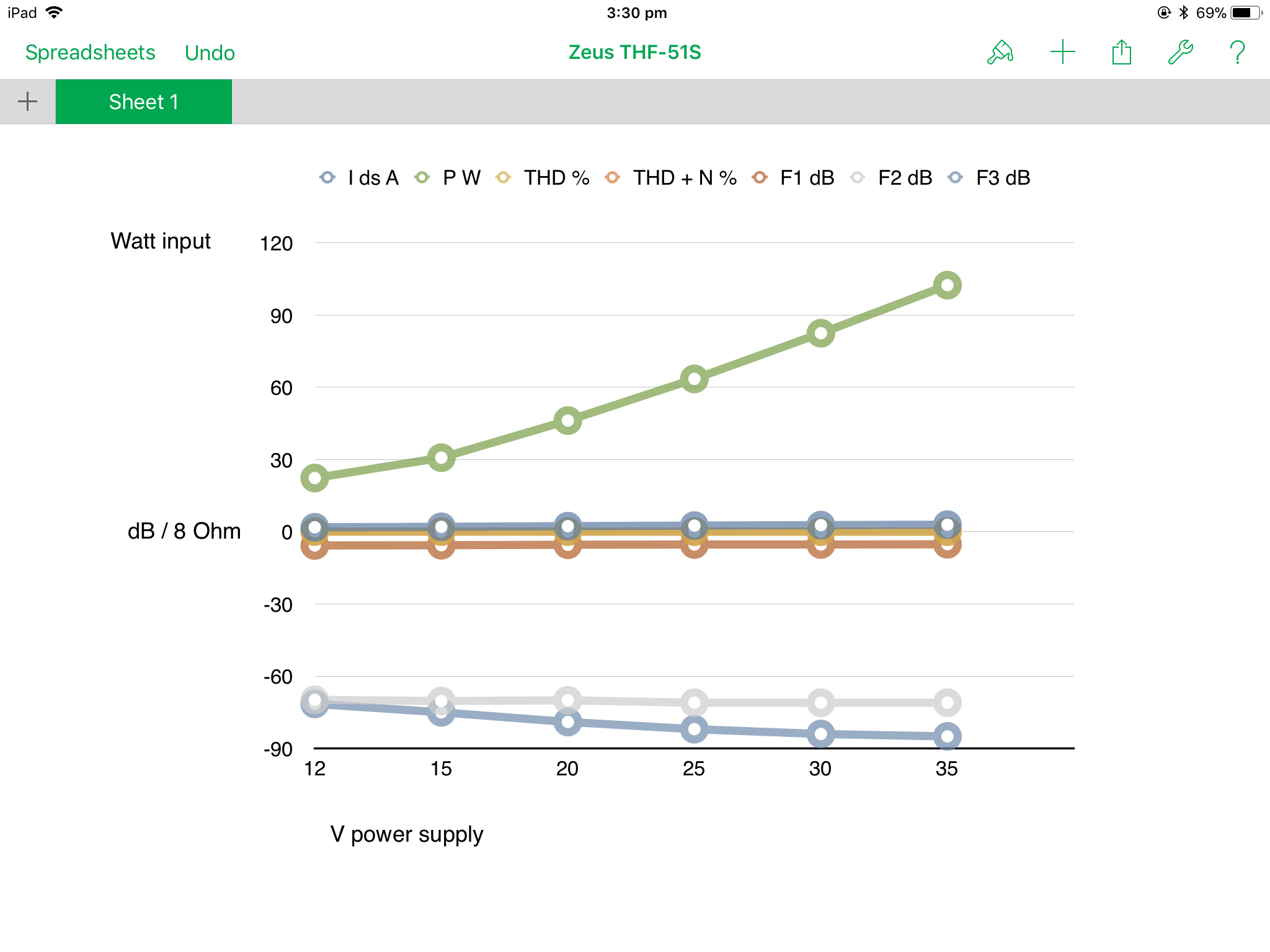

Wonder why you are wearing mask, don’t smoke your THF-51S, just applying a negatively gate bias before power on your circuit.
One member of our forum, gantez,went further by never switch it off his or her “SIT 2SK82 Cyrclotron Power Buffer” bias circuit (sorry no book marked, please use forum’s search function)
I use a simple and safe approach by lifting the source differencce potential up with an 1 Ohm resistor and my gate is leveled to the other end of that resistor, with that level shifting, i got a - 2.7v to the gate.
Well, I run my THF-51S pair from 12v to 35v with that 1R resistor, I found no change in gain, minuscule change in second harmonic level and large swing in third harmonic ( a push pull balanced circuit).
Have fun and always bias it first.
