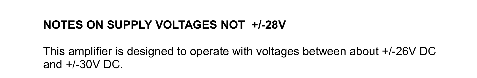

This may have been mentioned in earlier posts, but I what is the maximum rail voltages for the circuit?
