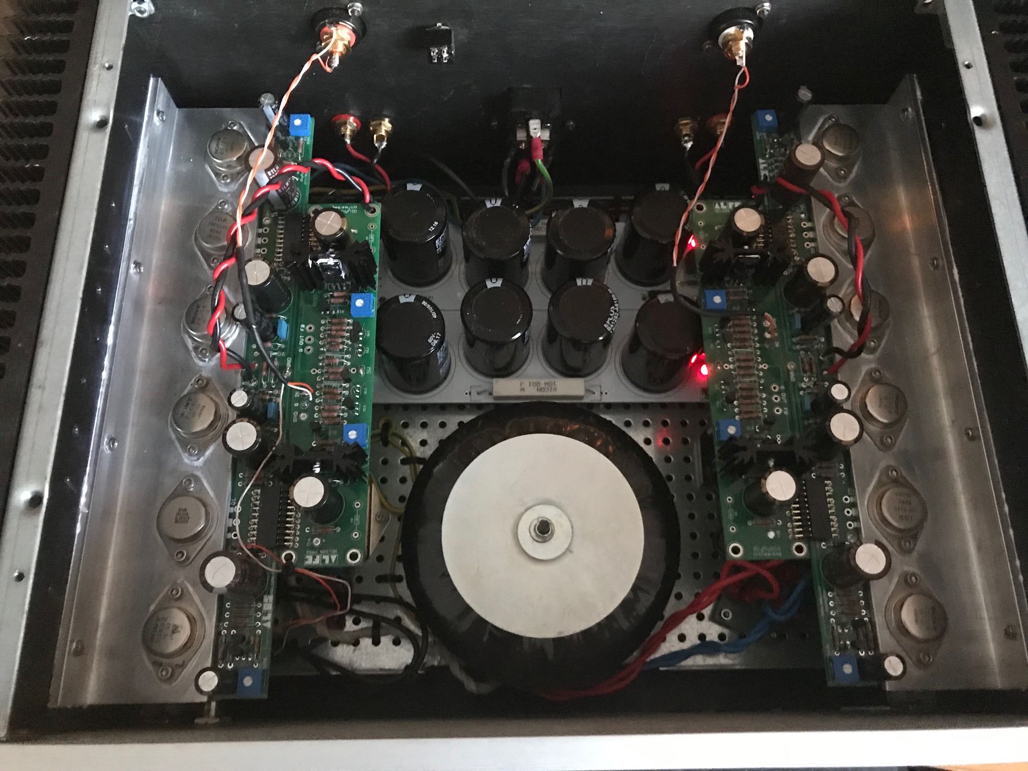

Hi!
I up and running my vfet, it sounds very good.
But i missing gain it's huge different between my F5.
My build its based on Vfet r2 (teabag), the yellow is the diff, from the original.
I have the bias about 1,5 amp 54 celsius. The frontend is 1,8v.
The SW (feedback) is open, everything seems to be ok,

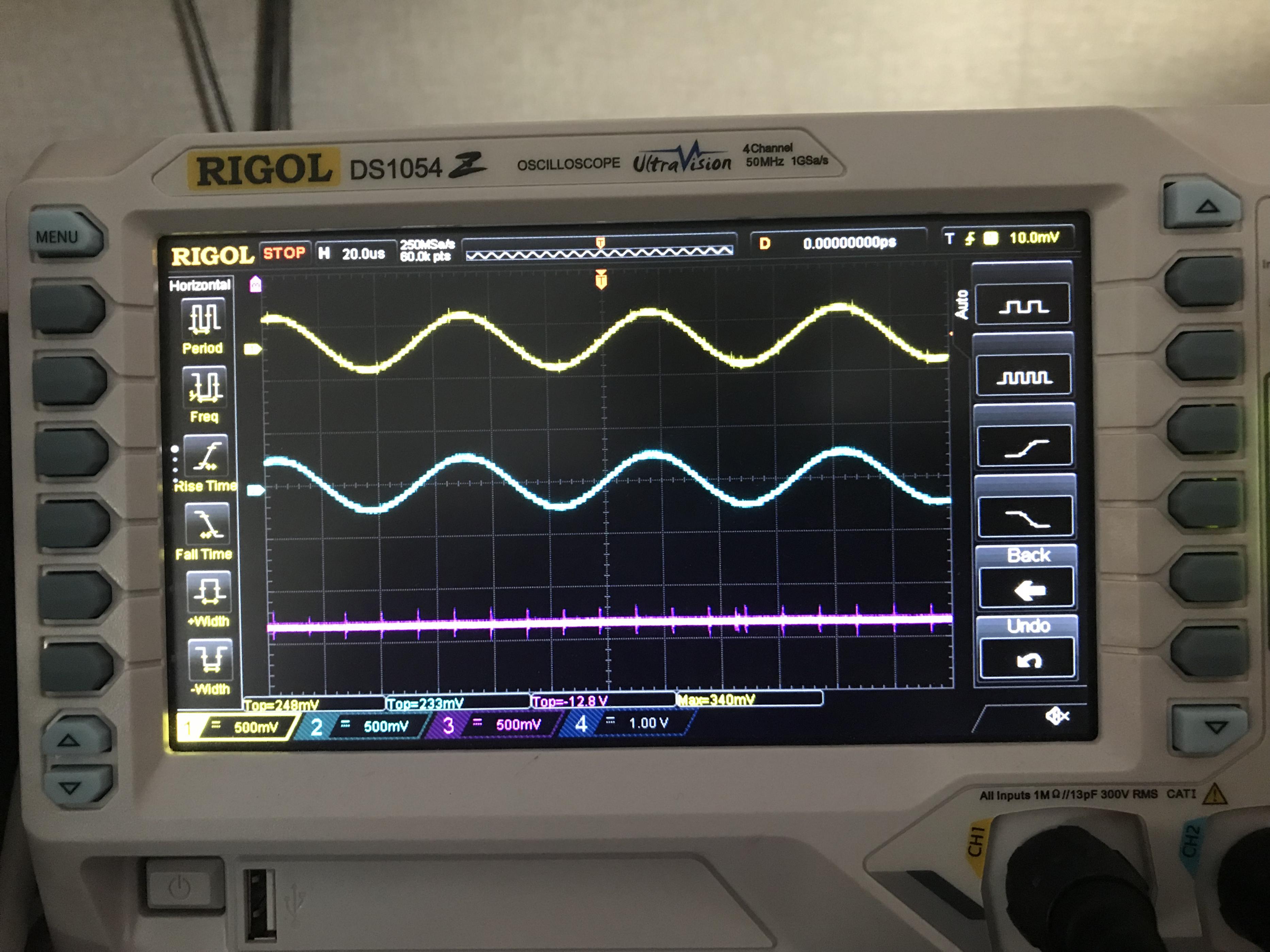

If you look at the picture from my oscilloscope.
The yellow is the input signal, 5,76 vrms, from the frontend (r20) 3,67 vrms.

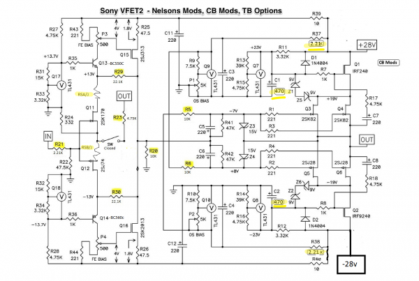

Okay, you now have the switch position jumpered, thus the feedback loop is always closed.
What value is R23? What value are R24 and R46?
R21 and R22 at the input slightly attenuate the input signal, changing R21 from 4k75 to 2k21 will only result in a 0.5dB difference.
I don't fully understand your measurements. What are you applying to the input? What appears at the output of the frontend over R20 (value?)? What appears at the output of the amplifier?

R20 is 10k? What about the voltages out of the TL431 regs in the frontend? Are Q13 and Q14 populated correctly (Q13 NPN BC550 and Q14 PNP BC560)? What about the other voltages?

It seems to be a Jfet problem here.
Q12 2SJ74
Drain Purple = 12.8V
Gate Yellow = 340 mV Rms 1,9V
Source Blue = 233 mV Rms 1,8V
I think i have blow the Jfets.
Q12 2SJ74

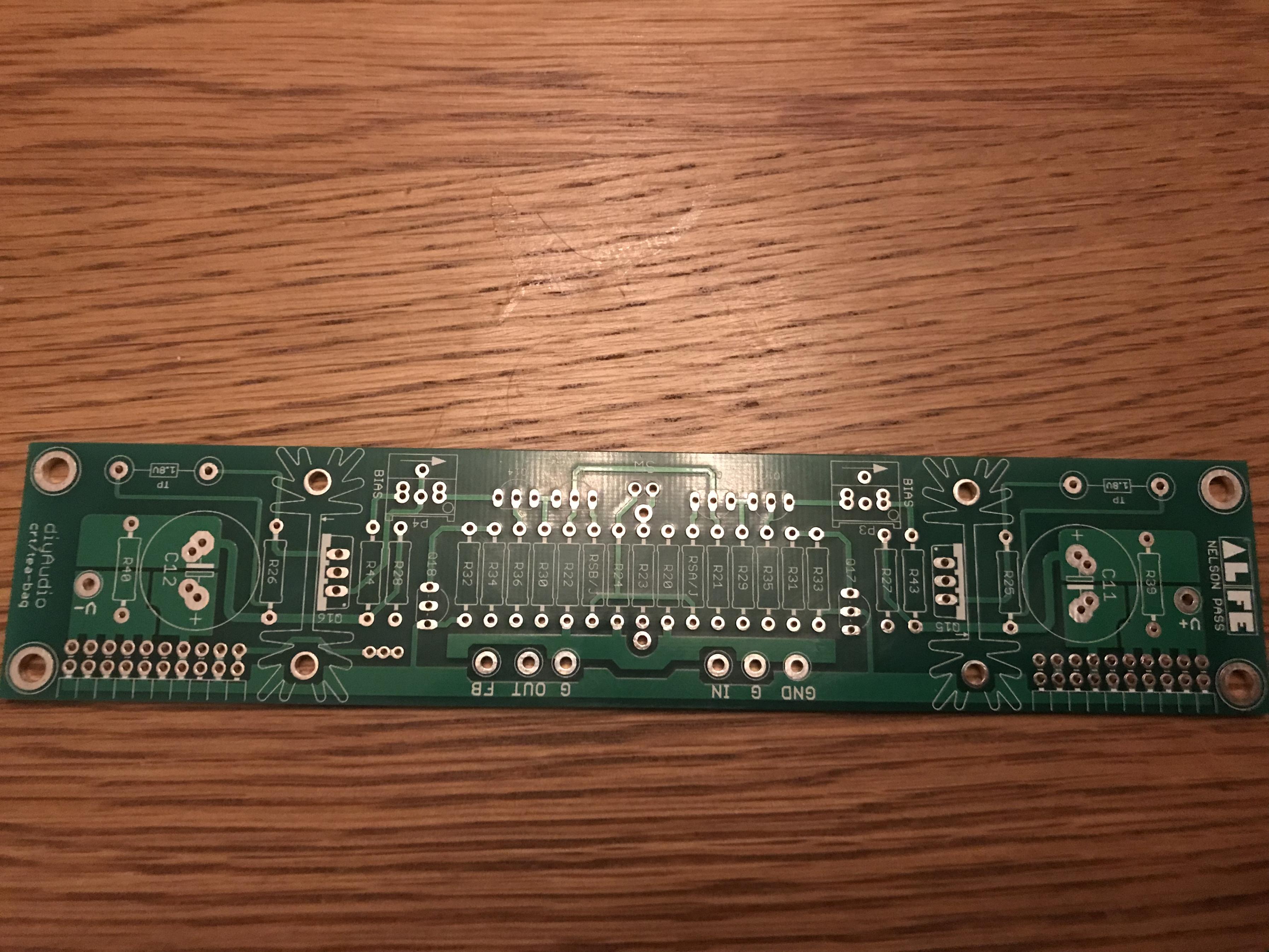

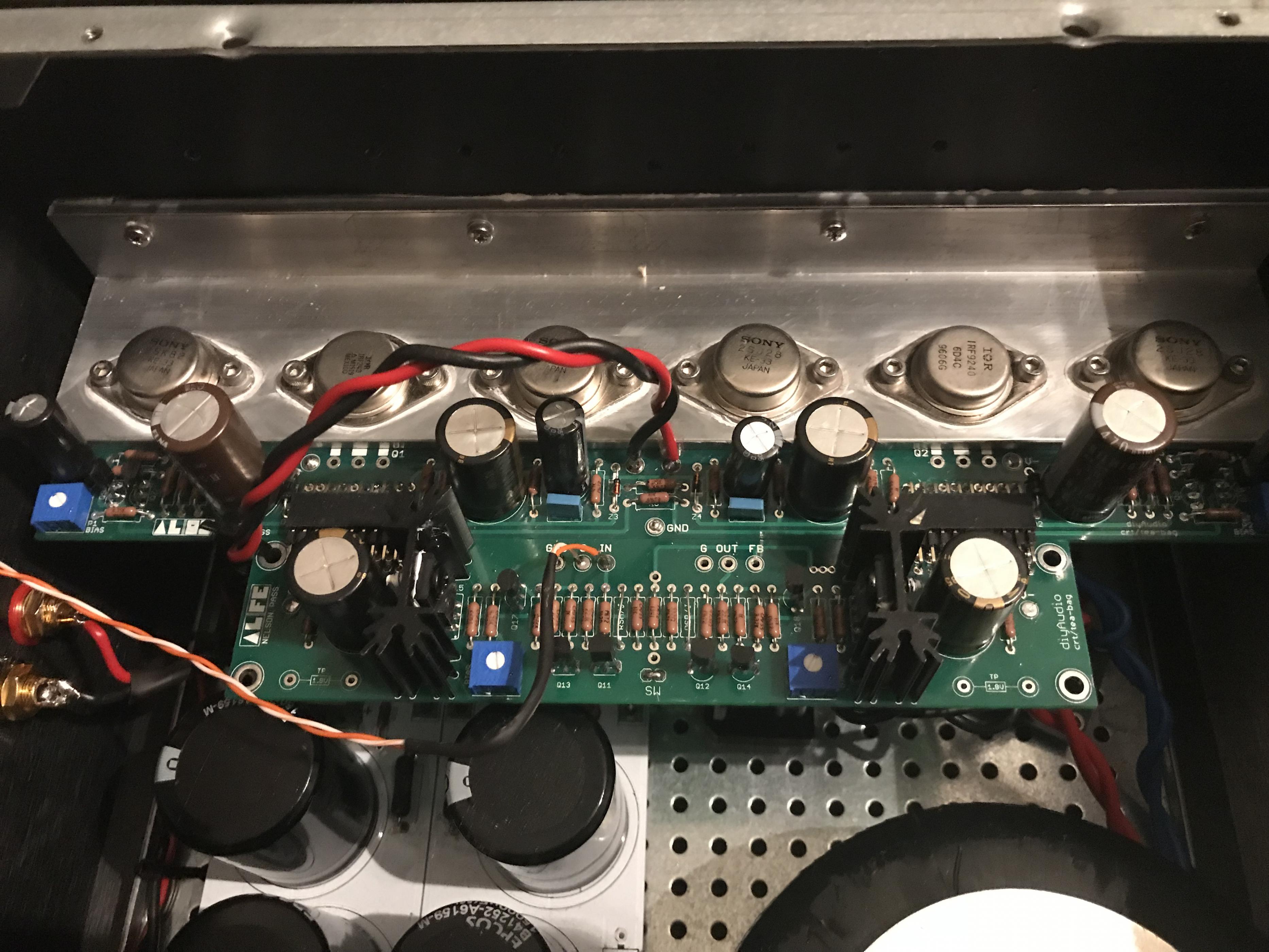

I have not followed your problem too closely so this may have been already addressed. It has been awhile since I built my V-fet but if I remember correctly the BC550 and BC560 pinout is different from the ones Nelson used. If so do not install them as per board but flip them.

The old ZTX/BC pinout mismatch, yes. But in this case I believe the pcb (dubbed AL at some point http://www.diyaudio.com/forums/blogs/tea-bag/352-sony-vfet-version-2-al-boards-build-blog.html) fits the BC pinout. Still, a valid concern and worth pointing out.
