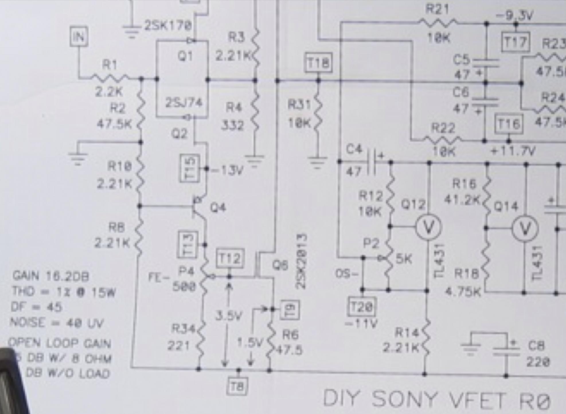

My question was simply: Which parts may have a bigger impact (besides the transistors themselves), even if your personal choice might be cmf (I will for sure not argue on your taste or choice)
My question was simply: Which parts may have a bigger impact (besides the transistors themselves)...
My guestimate would be currently:
- R1, R3
- R2, R23, R24
- R25, R26
- R4
R31/10K ?
and R21 and R22 ?
Other front-end R's ?

R31/10K ?
and R21 and R22 ?

Seems to me that P3 and P4 are in the signal path and should also be included in your list.

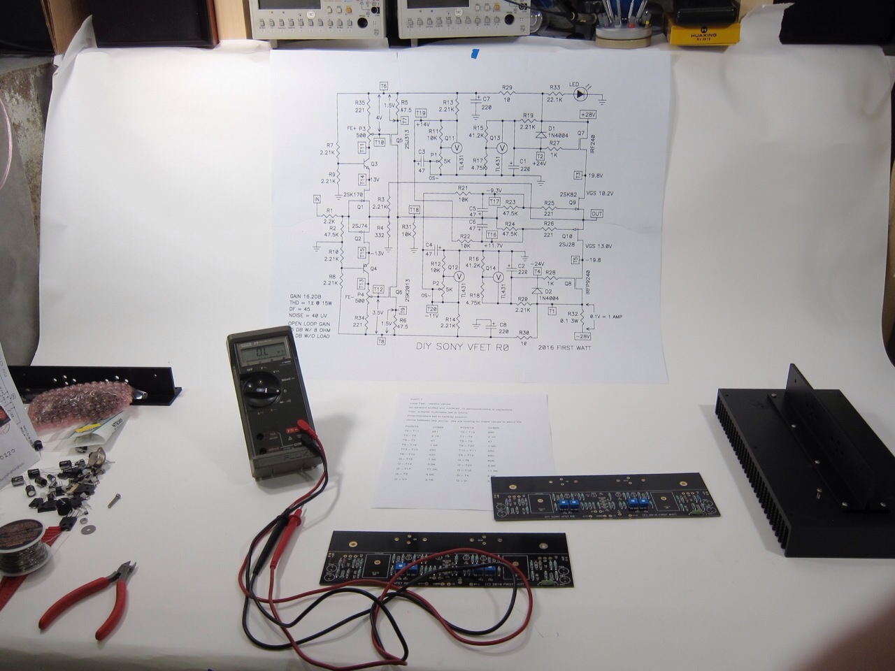

An excerpt from the (soon to be completed) build guide -
(The "how it works" for the front end is still unedited)
Please refer to the above schematic for component names

Ok, so far everything has been explained except for the wiggles in the center of the schematic near T16 and T17. Remember how the bias voltage regulator is set by the divider made from R11 and P1? This is a DC value but we also need to let the AC have it’s say in the circuit, as the AC is our music. 🙂 The Front-End output signal was all big and powerful the last time we left it at T18. Now this signal needs to get to the Gates of the Vfets to move our speakers, and that signal (even though it’s AC) can get pretty darn big. Big enough that it’s voltage could effect the current flowing through the regulator set resistors. The network of C5, C6 and R21 through R24 prevent the music signal from having much influence on the bias regulators. Stable bias makes for happy Vfets, so this is a good thing.
What’s left… Um… R25 R26 (221ohm) are gatestoppers for the Vfet, R33 (22.1K) adjusts the brightness of the LED (which must be blue, this is a Pass amp, after all…) and R32 (0.1ohm) gives a place to measure the output stage current. (Bias)
Global feedback is applied from the output stage from the Vfets to the Jfets through R3 (2.21K), and then R4 (332ohm) to ground.

Fantastic work 6L6 thanks for guide teaser. Looks promissing.
On your photo with schematic in the left corner i see add informations about damping factor, THD , gains etc.
Guess is from "VIP:happy1: edition" ?
Cheers
