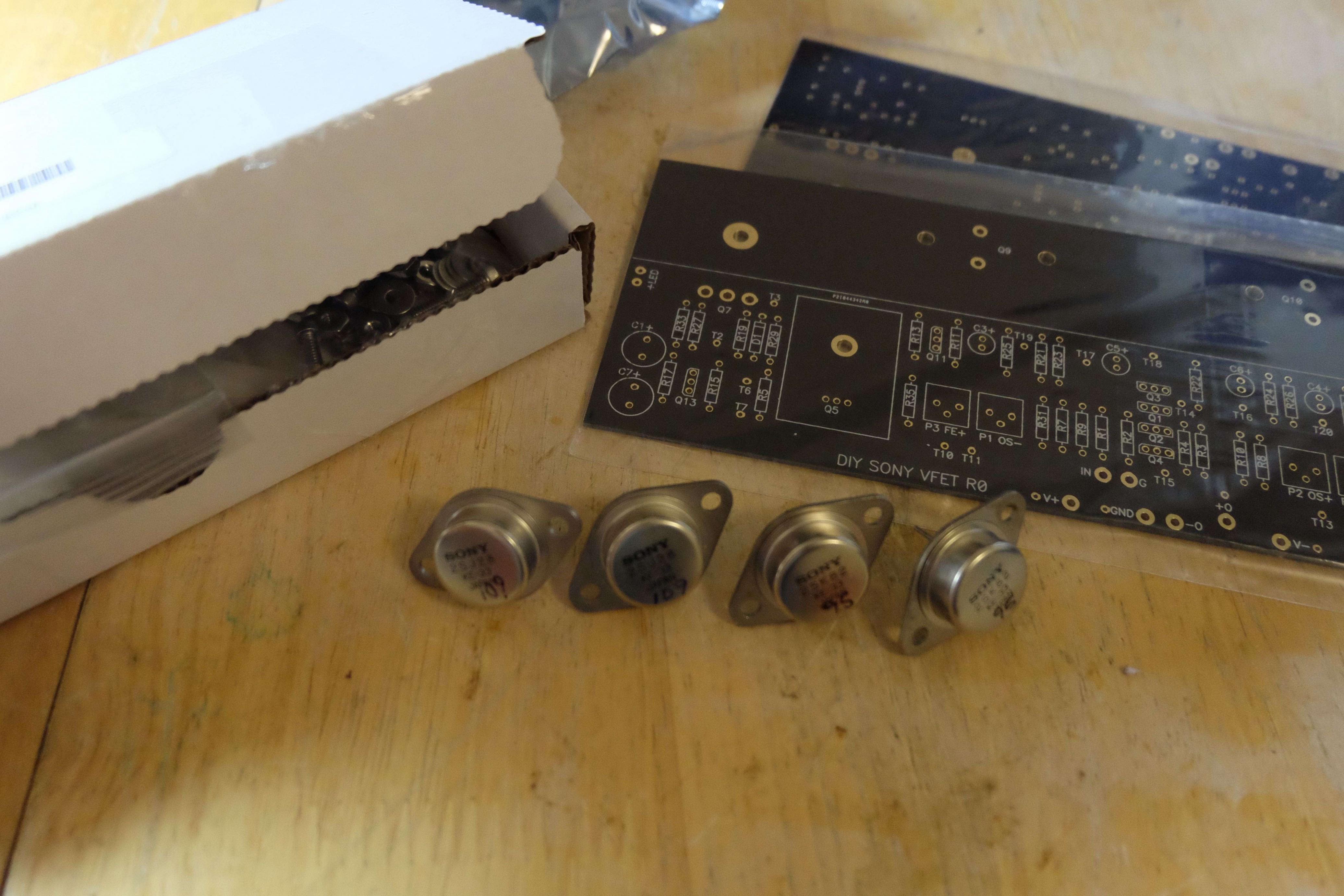

Got my kit today. Thanks you a lot for the effort on this project. 😉
