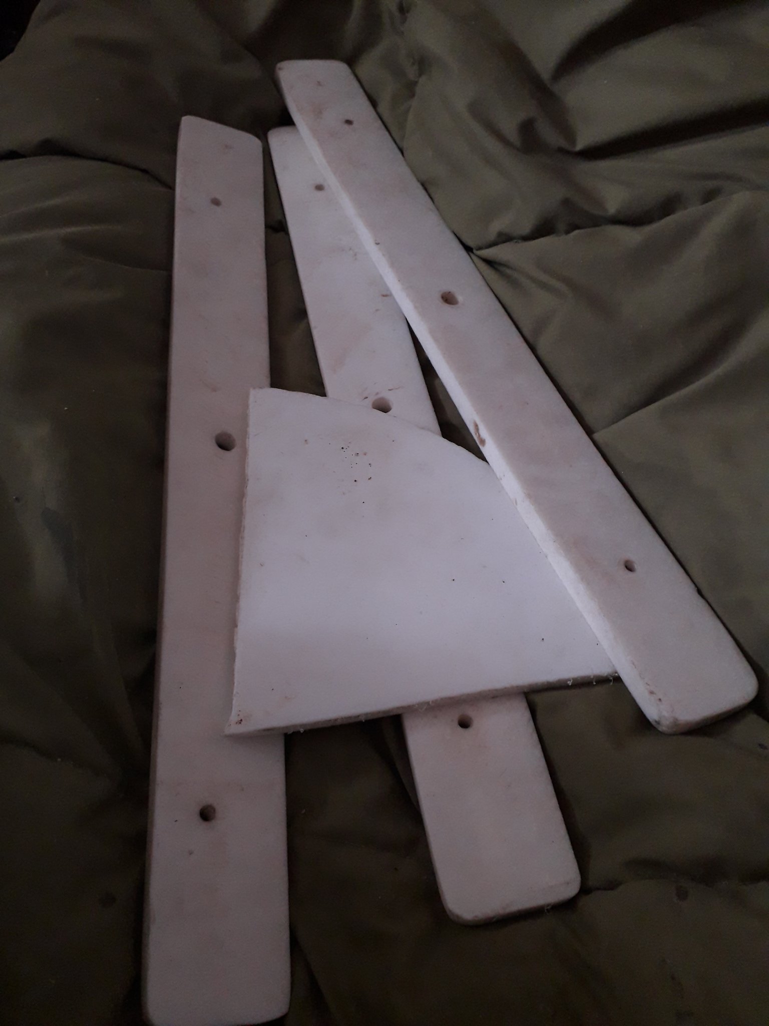

Although discussed already it seems that this wood is a slightly better replacement at least for The Well Tempered turntable's teflon upwards gimbal as the wood seems to be harder than teflon.By the way...i just bought from the flea market a considerable amount(about 3kg for 3 bucks) of 7mm...1.5 cm thick teflon sheets.I bet they are more consistent and predictable in specs than lignum vitae and certainly much cheaper to source.The original plastics that Sony had looked more like usual nylon for fishing nets.Teflon is compresible so it can't be used for the horizontal bearing unless the whole system allows for a mm vertical play but threading it is a children's game.You can do it bare handed.You could have used the original dead iron bushing container to thread it.
