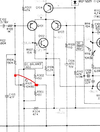

C102 LC and C202 RC - A bit confused by the instructions. I see no polarity on the schematic. DO I measure across the leads with power on?
The polarity is in the symbol. The tiny bit (toward the transistor) is positive. You could use a 4.7uf 16 or 25 volt electro as a good replacement here.

1) Carefully tap and perhaps tweak R105 (the DC balance pot) as it could be intermittent. Does the crackling appear as you tap/touch the pot. Its a moments job to reset the offset back to 0.00 volts.
2) Do you see the small caps, C106 and C107 that go to Q106, They would be next on my list to look at. Are they ceramic disc types ?
Edit... and C103 at the input.

Not so fast, later after a cool down, noise. Frustrating. I started what you suggested Mooly and tapped R105. Tapping did not produce anything but when I
fiddled with the contact it made a similar noise. When I did the same procedure on the R channel no noise. Thought I would swap them around.

If the noise returned on the same channel after swapping Q104 then it could still be the diode that's faulty... possibly. Heat from a soldering iron often alters faulty parts.
You could swap the presets although it might be better in the first instance to rotate them rapidly to and fro (maybe with drop of WD40 to clean the track and wiper... which some might not approve of 🙂) and see if the fault has gone.
If you replace the presets then never bend the leads such that any force is applied to where the pin is bonded to the track. Better to solder short leads on to it or if the board allows, redrill new holes in the PCB. Or better still when you are certain of a fix, replace the pot with two fixed resistors.

I did rotate rapidly the pot rapidly and a generous squirt of Deoxit. No effect.
Not sure I understand your last comment "don't alter the DC bias adjust preset (just in case you were wondering) by that method".
Swinging the DC offset by a few 10's or 100's of millivolts is one thing, swinging the quiescent current quite another. If that pot was cleaned up in a similar way you would have to do it with the amp OFF and then reset the pot to give minimum current initially and then readjust as per the manual.
If you have doubts over the preset then you could remove the pot completely and connect the centre wiper pin to the junction of R302 and R303. That would run it without the pot. There would be a small DC offset error (for safety measure the offset before connecting speakers, anything under 300mv would be OK as a test) but it would prove the pot good or bad.
So it sounds at the moment like the next step is to replace the diode.
