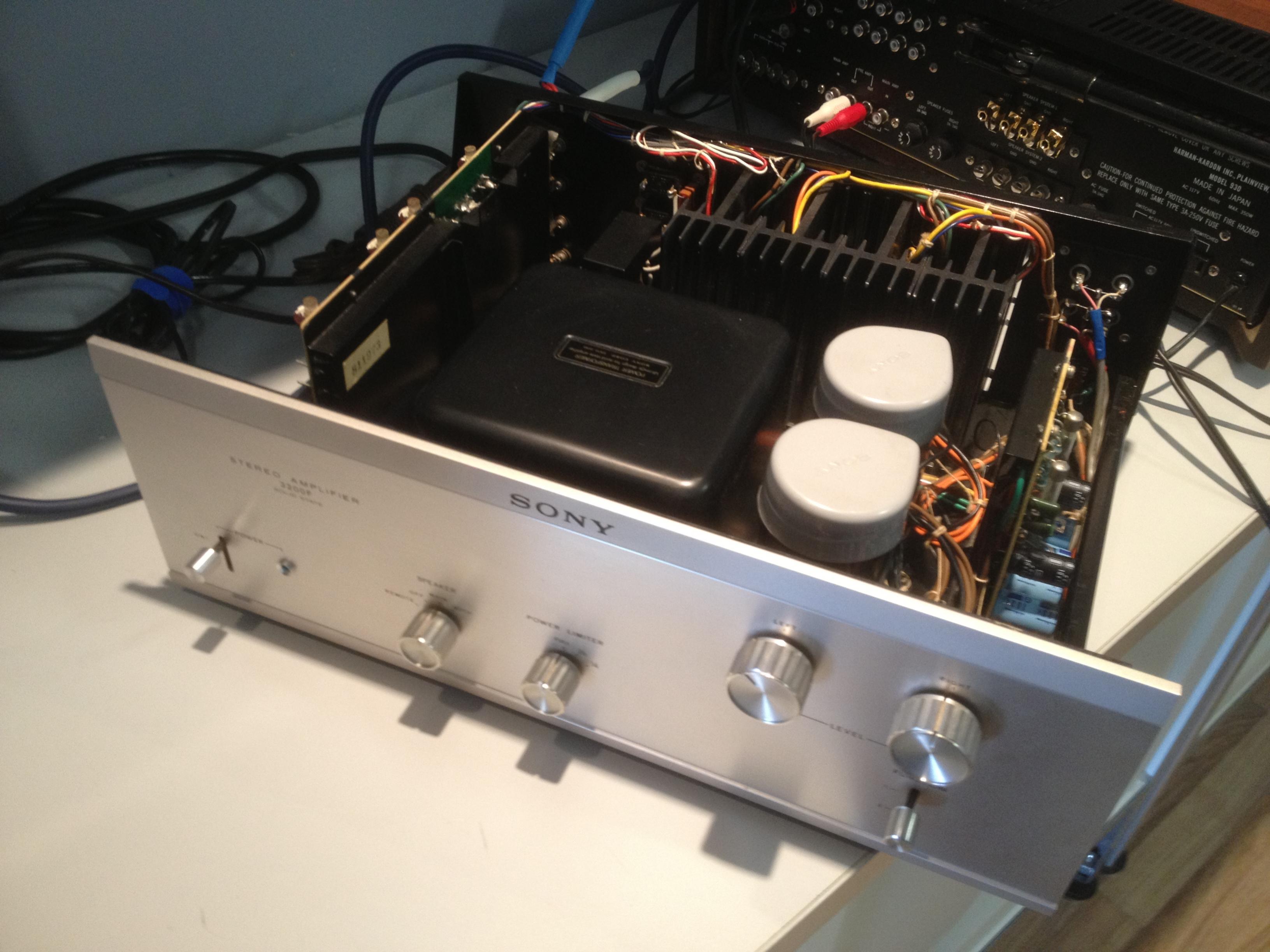

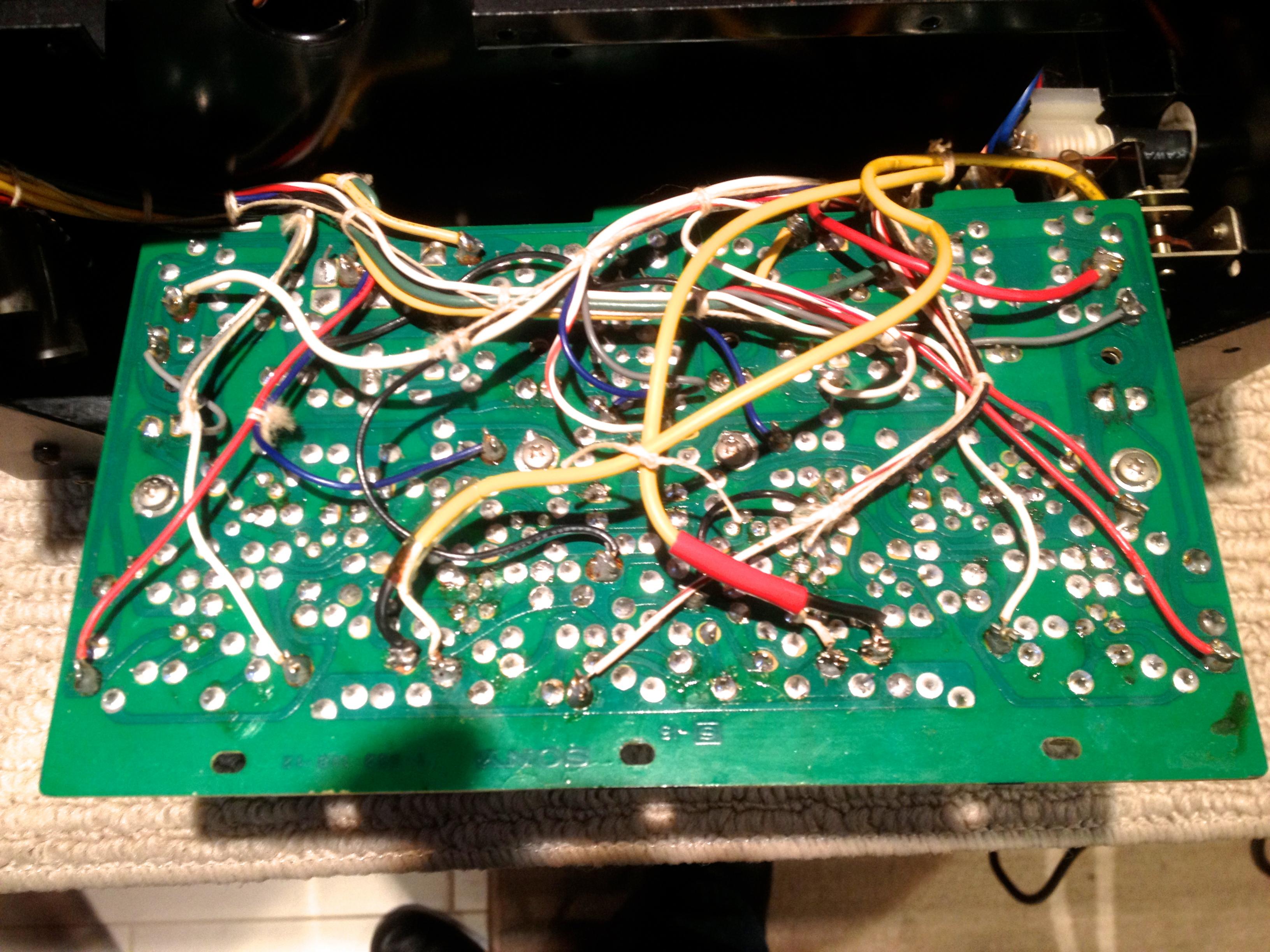

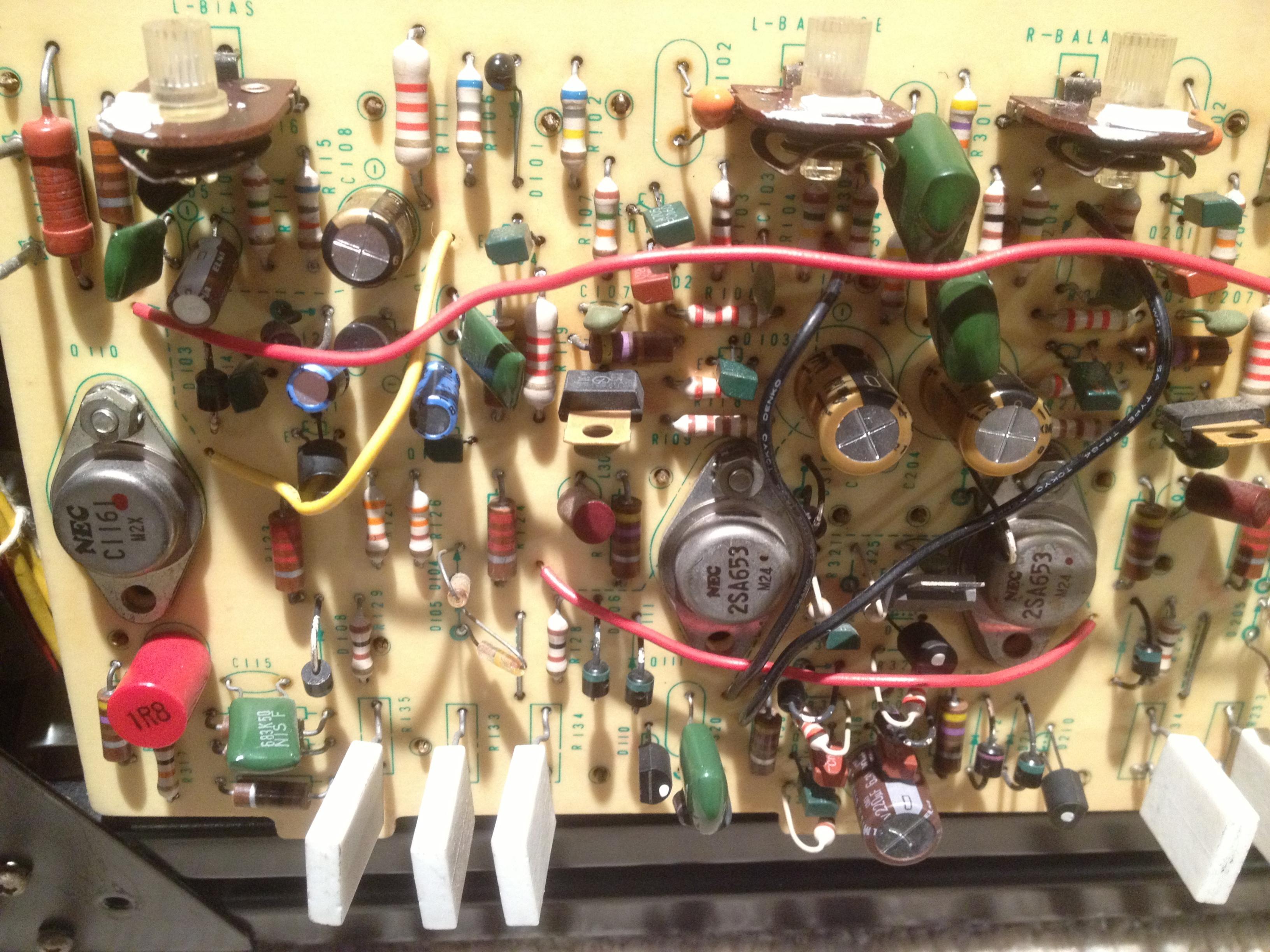

Hello All,
Before and after a full Electrolytic recap I am still getting a crackling noise much like the sound of a dirty vinyl record. It comes on after about 5 minutes from power up and last for about the same time then disappears. It is independent of the volume control which has no effect on the noise.
I have checked all the solder joints through out the amp board and power supply which seem fine, I have removed all the out put transistors and cleaned the contact and put new thermal pad on. I am now thinking component failure. There are a number of those nice old brown carbon resistors on the amp board
(none of the resistors look burnt - generally this amp is in good condition). My thought is to just replace them. If this were a transistor issue would the amp just fail? I am also assuming that the issue is very likely on the amp board and not power supply. All controls are clean.
Any thoughts and help I can get as to where I should go from here is most welcome. Images attached for reference.

Left Channel only. There is a tantalum cap in the photo ( the one at the top that looks like a small orange ball ) that appears to have burn marks where the leads go into the board. Think that means anything?

You should be able to tell from the circuit but if not just measure the voltage across it with the amp on and fit accordingly. Just fit an ordinary cap of suitable voltage.
Is that a carbon composition resistor lurking around there too ?

There are a number of carbon resistors in there. When I get this noise issue settled I am going to replace them.
The noise issue could possibly be a carbon comp playing up 🙂
mmm, but it also could be a transistor, no? Where to start Mooly? Yanking the resistors and a few tants are easy and probably should be done anyway. Would this be your first approach? I have taken voltage readings across most of the transistors that I can get my probes into and they seems to be no shorts, they are all reading voltage.
Well, everyone keeps saying it could be the front end transistors so that has to be considered... they could be a type prone to this kind of failure... it happens. So perhaps do as others suggest and swap them over to prove.
Where would I start... replacing any tants simply because they are notoriously unreliable. Carbon comps are in the same category really. There is no really scientific way to prove where the fault is... a scope could be a good guide but not definitive for this kind of problem. Go for the most likely suspects first. That tant for one and perhaps the diff transistors as everyone seems to know something I don't about those 😀

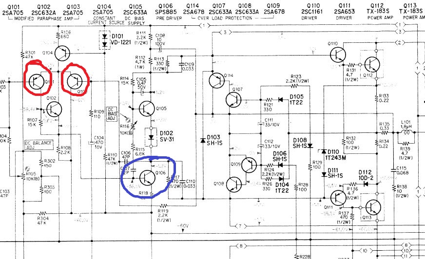

Do we have a circuit for this amp ?
The differential amp transistors will be the first "pair" with the emitters connected (or closely connected) together. Those metal tabbed driver types would be my suspects but none of this is helping is it 🙂
Be methodical, and it should take very little time to pin the fault down. Ultimately anything could be causing the problem but in practice it will be one of the "usual" suspects. Old preset pots can go intermittent too, not just the wiper but the rivets that secure the leadouts to the carbon track.
The ones in red are the differential amp. The one in blue (the VAS or voltage amplifier stage) would be a suspect purely on the grounds that it runs hot (ish) continually and would be suspect for that reason and the type of device it is. That's very unscientific I know, just experience points the finger 😀
